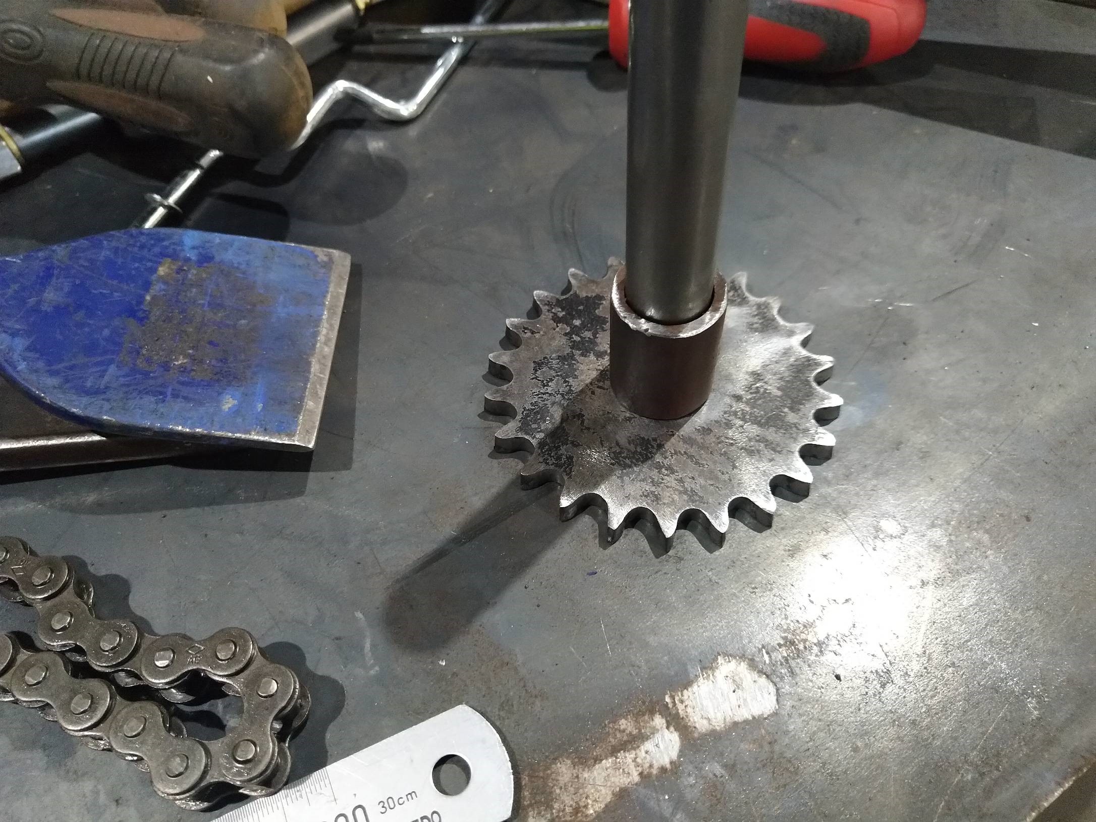

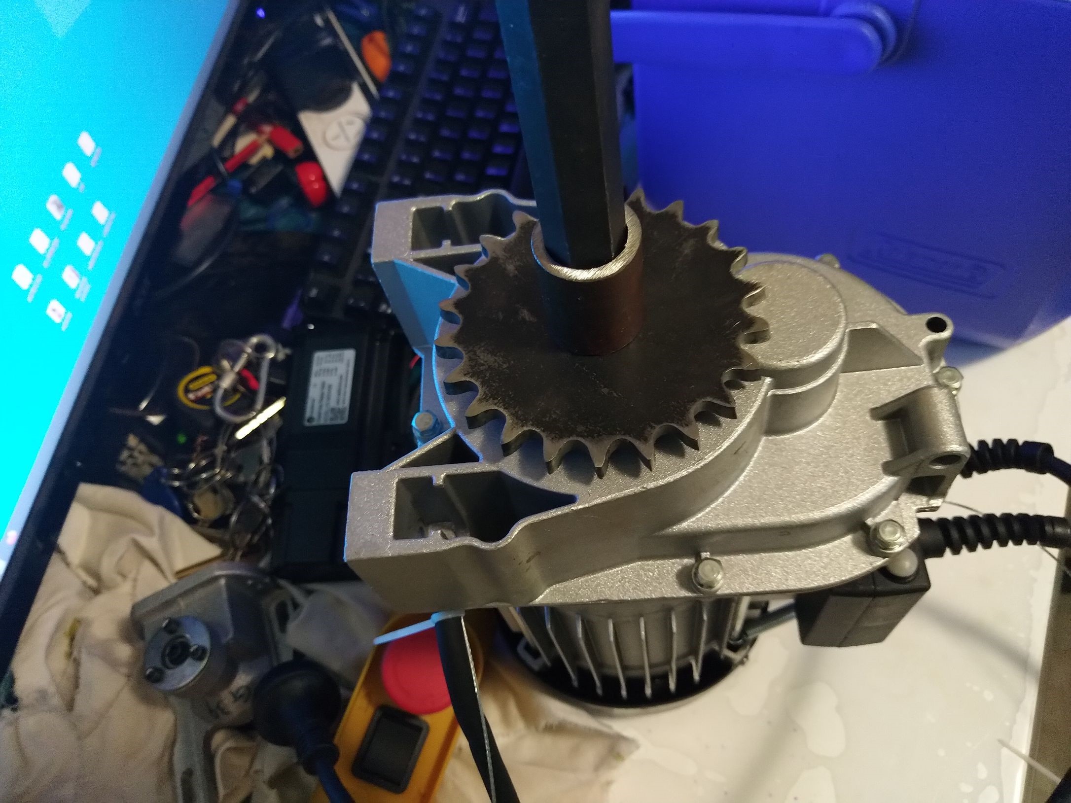

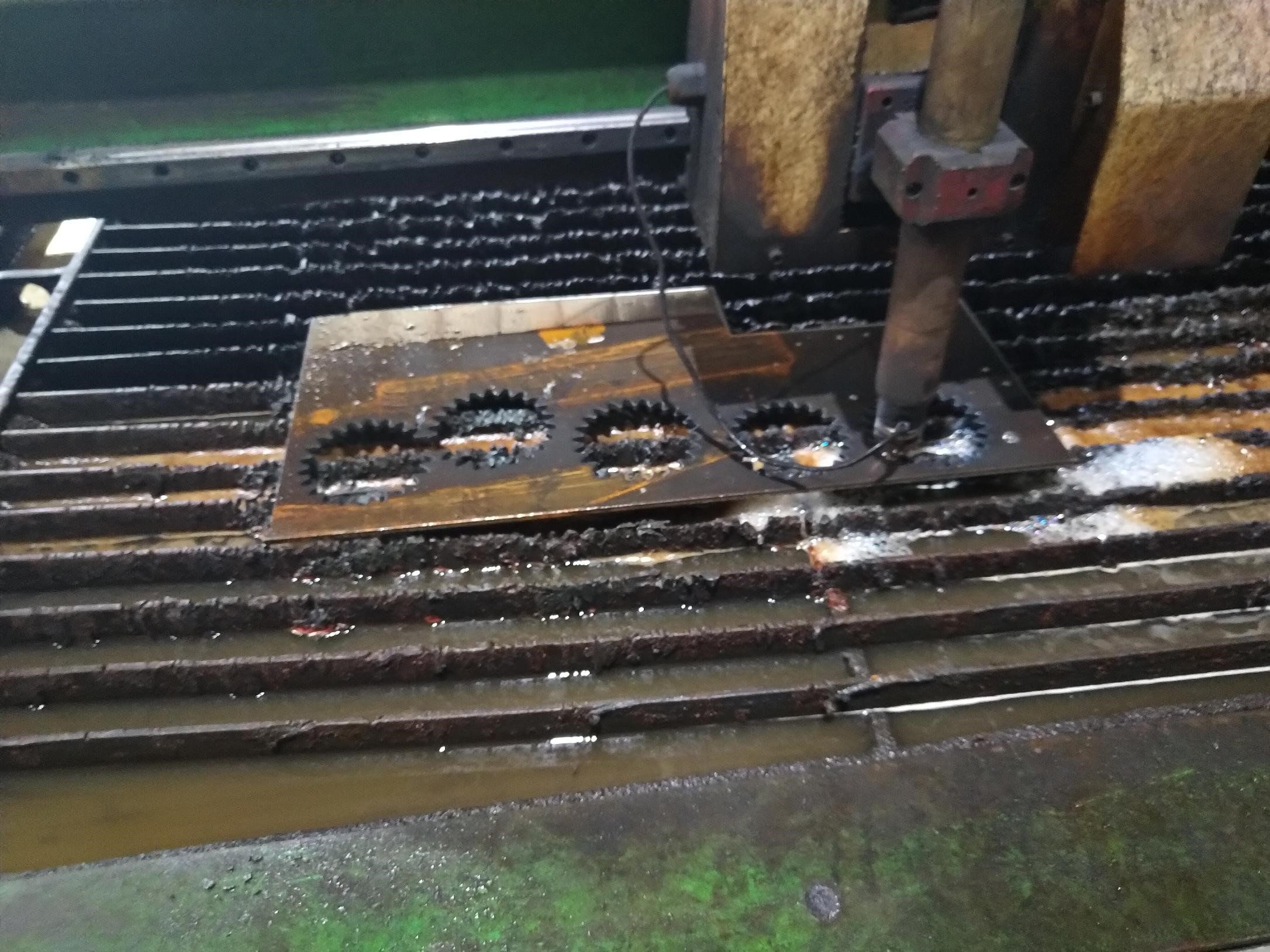

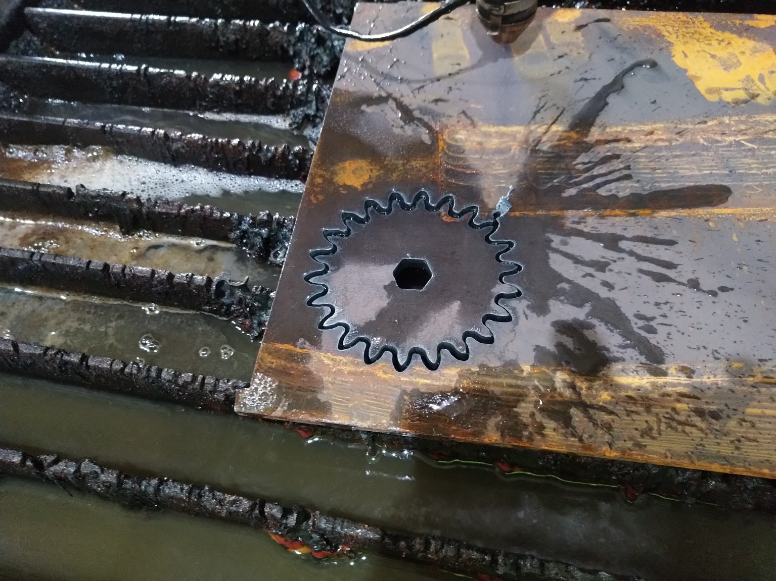

Today I made some sprockets for the roller door chain drive,
Took me five revisons to get the sprokets sitting on the chain correctly. Plasma really is a blunt axe but these should work fine.
I will weld on a piece of pipe with two grub screws to hold them onto the shafts,

have to give you credit you get into some pretty cool builds. sprockets would not have been on list of things to cut with plasma but it looks like you proved me wrong in my thinking

Sometimes you need to find a way to make the tools you have work.
The sprockets have a bit of taper. I had to lower the feed rate right down to try to eliminate most of the taper and it worked, also I had to reduce the scale slightly of the sprocket diameter to work with the plasma cuts. If I had them laser cut they would of been perfect the first time but I am sure they will work fine in my roller door application. I would not want to use them for a motor bike or such.
I see building a laser cutter in my future

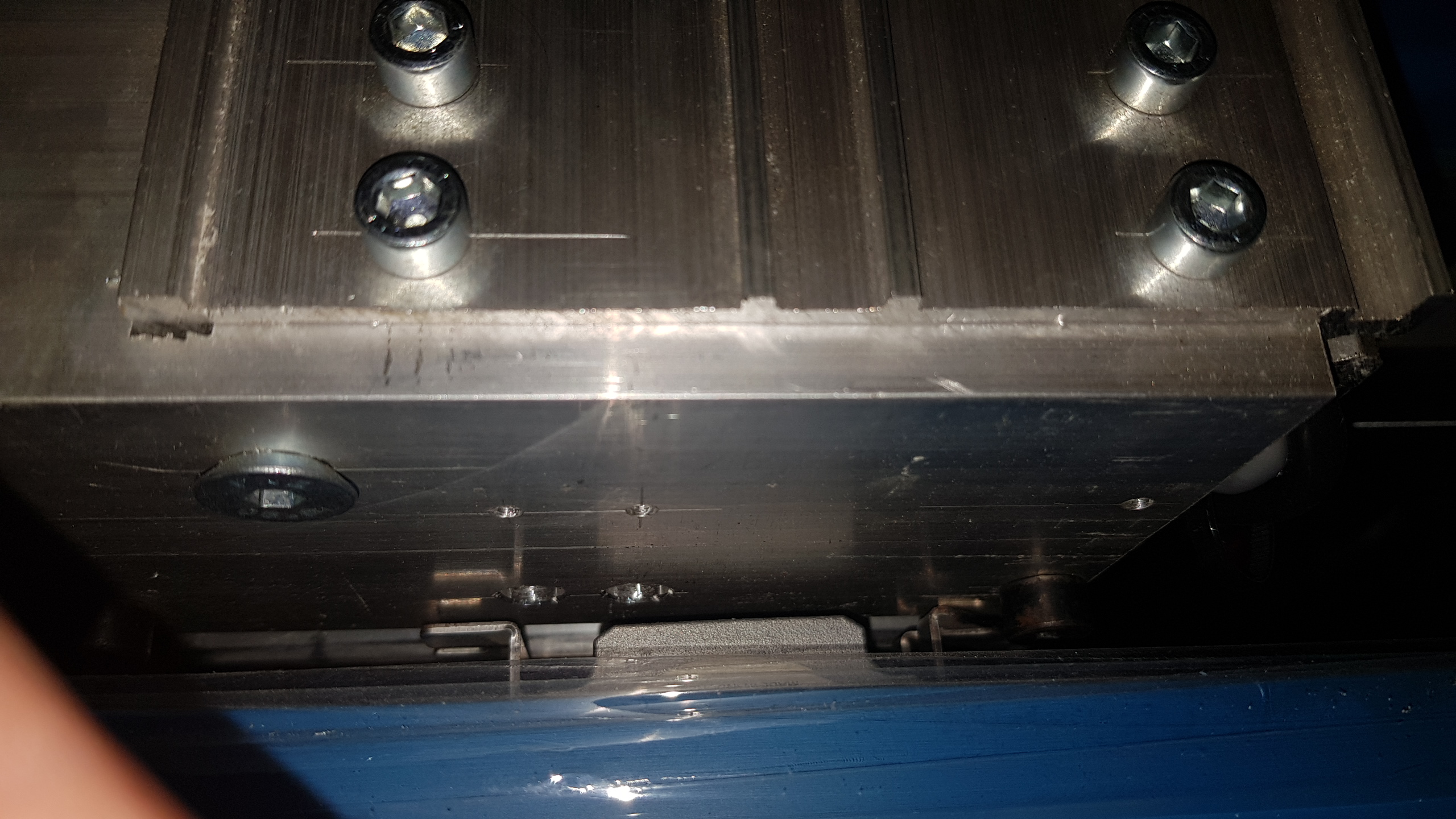

A bit off topic, but just goes to show to what extent i molest my brain when building something, granted i can find the parts:
Left are black M5 screws, right are white M6 screws, all with 4mm allen wrench.
Above 4x M6 screws, below is an M8 screw, all with 5mm allen wrench.
Up until the last 3 machines i built, looks were not on the priority list at all, functionality was. Now that has changed, but it made building the machine much more time consuming.
