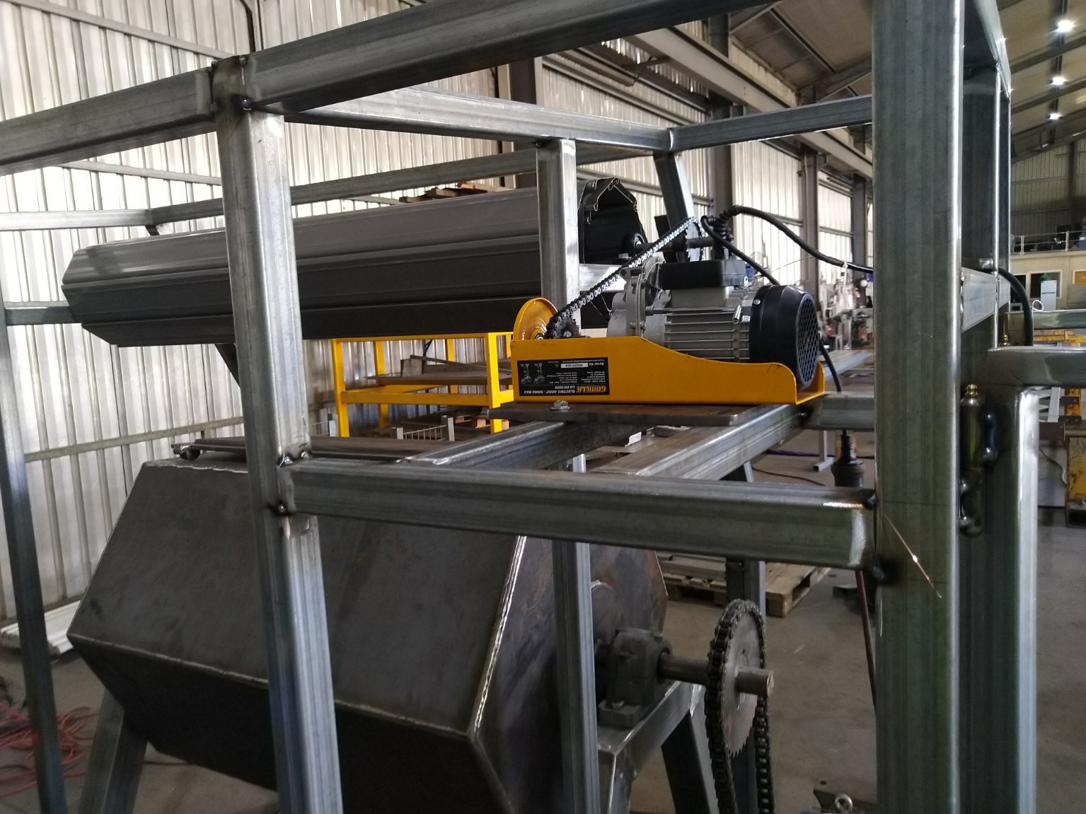

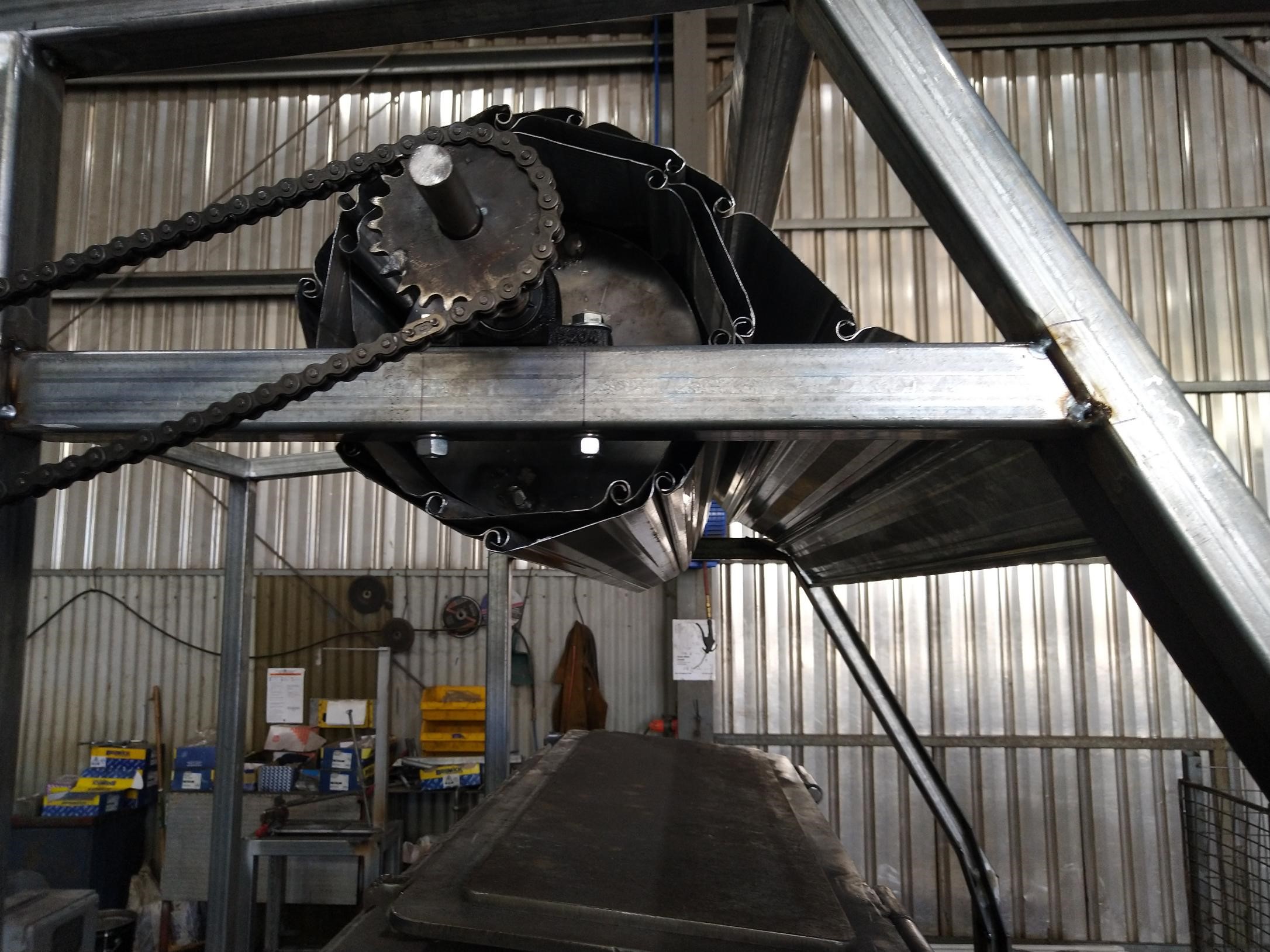

Replied by thefabricator03 on topic Tumbler Build - For cleaning plasma cut parts.
Got the door moving. I will need to make a larger sprocket on the drum shaft as its moving too fast.
