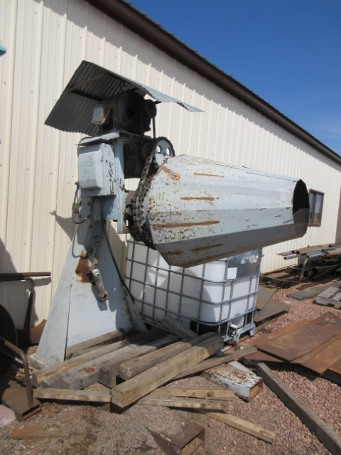

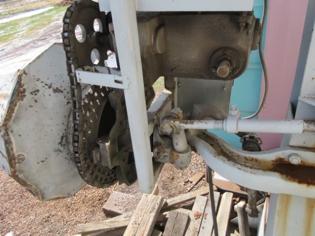

Years ago I built my tumbler for part on part tumbling.
Sometimes I add steel punch slugs or crushed gravel etc.
Needless to say, it is located outside at the back corner of the shop. Makes people ask "what's going on in that barrel?"
I had scrapped an old dump truck, and salvaged the front steering axle for mounting the barrel. I made the large sprocket with welded square bar (before I had built my plasma cutter). I changed sprocket size till I had a speed that worked. VFD would be nice.

21 Apr 2020 12:13 #164951 by EW_CNC
Why do you add steel punchings or gravel? What kind of parts to you mostly tumble?
If I add steel punchings or gravel when I tumble large or heavy parts it gives it more of a rolling effect rather than a heavy hit. Also it helps clean inside corners and holes. I tumble a variety of parts, Large and small, heavy and light. It works good for all.
NOICE to the next shop is to considder
It does make noise, but I don't know of it being offensive to anyone. That's one advantage of not having a shop close to a residential area. The neighbors would say it isn't worse than the noise of their 250HP tractor working land. I have thought of building an enclosure for it, but so far it's pretty far down on the to do list.
TIME if it takes 24hr Energy waist
I never tumble for 24 hrs. If you tumble for too long, the corners of the parts start to become peened. If you have just a few parts it's probably better to just clean the parts on the belt grinder, but if I need pay an employee to stand at the belt grinder for a long time cleaning lots of parts. I'm sure we would both choose the tumbling option.
Surface if you got blank surfaces you see scratches
Fragile parts or parts that can not be scratched will mostly be cut out with laser rather than plasma and is not a good candidate for tumbling.
EW

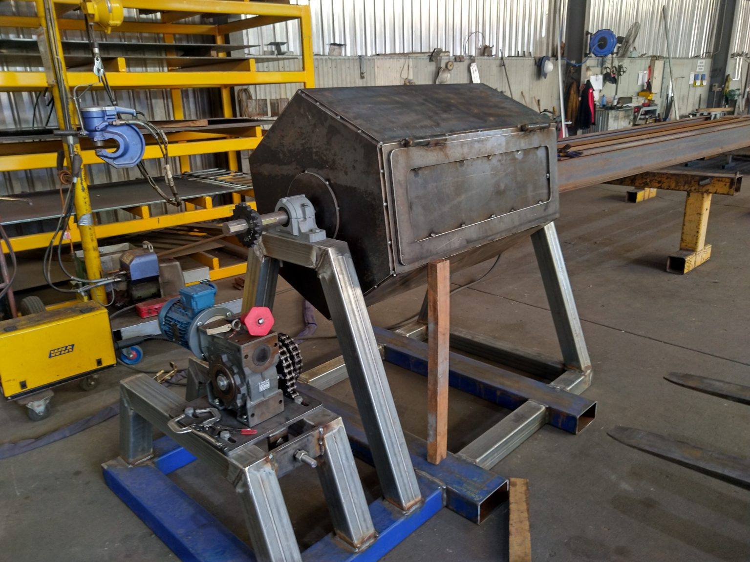

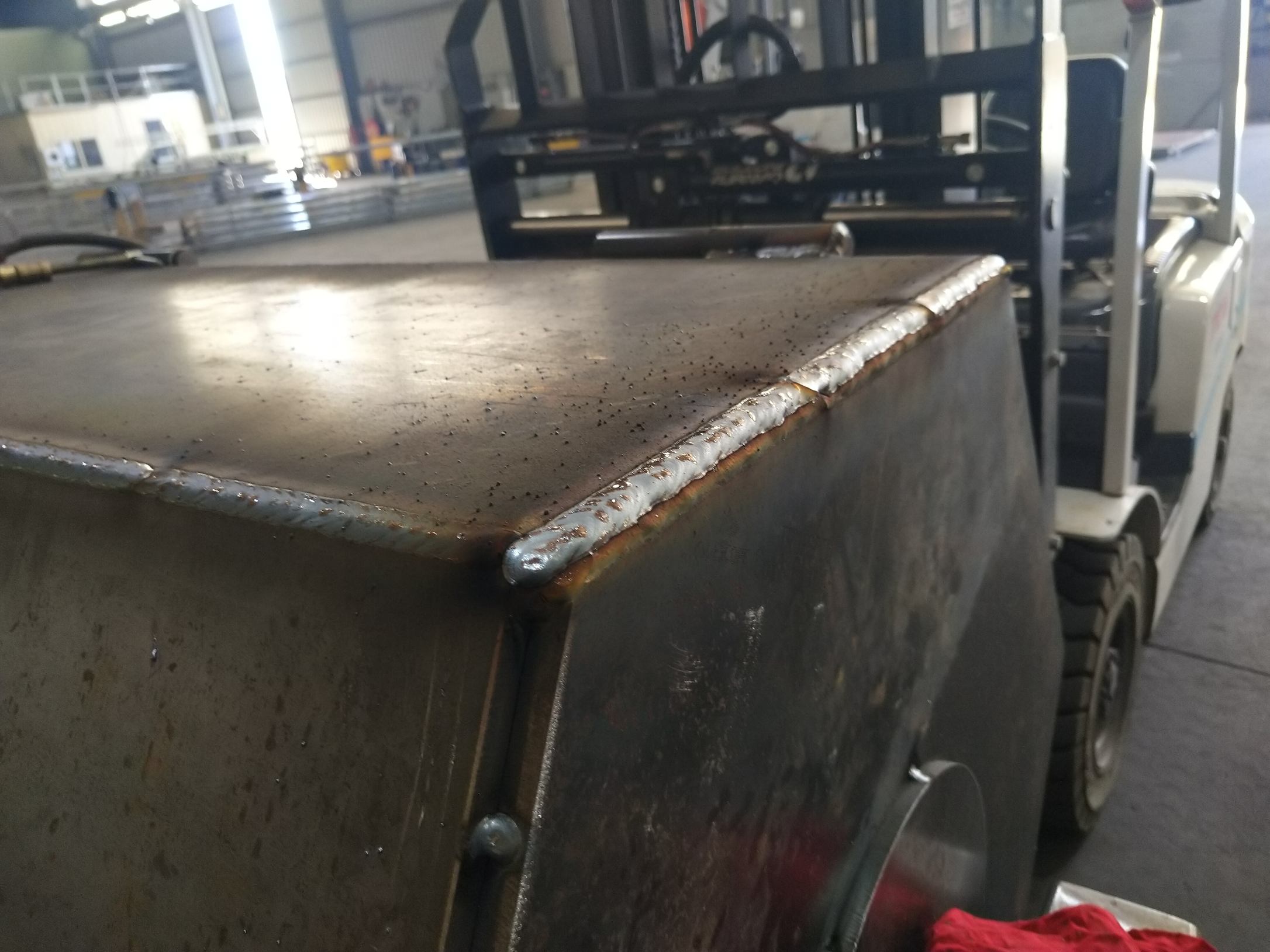

21 Apr 2020 12:30 #164954 by thefabricator03
Replied by thefabricator03 on topic Tumbler Build - For cleaning plasma cut parts.
Also with your mixer, I bet you can just tilt the drum down and the parts slide out. Any advice on removing parts?
I was planing to have a steel shelf under the drum that I could open the lid and jog the drum around so the parts fall onto the shelf then I can remove them with a forklift.

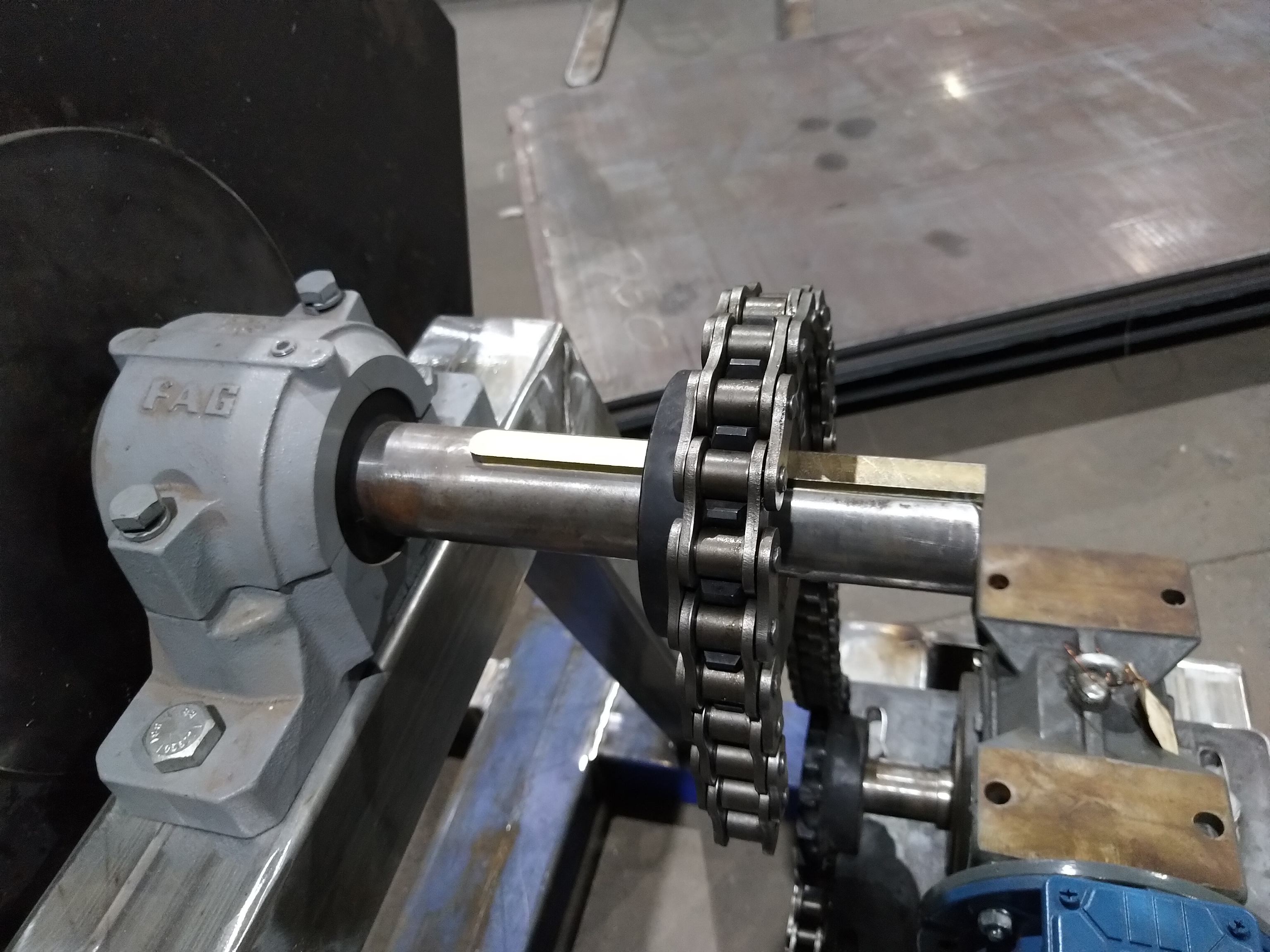

22 Apr 2020 09:56 #165063 by thefabricator03
Small update.
Installed key. Nice tight fit.

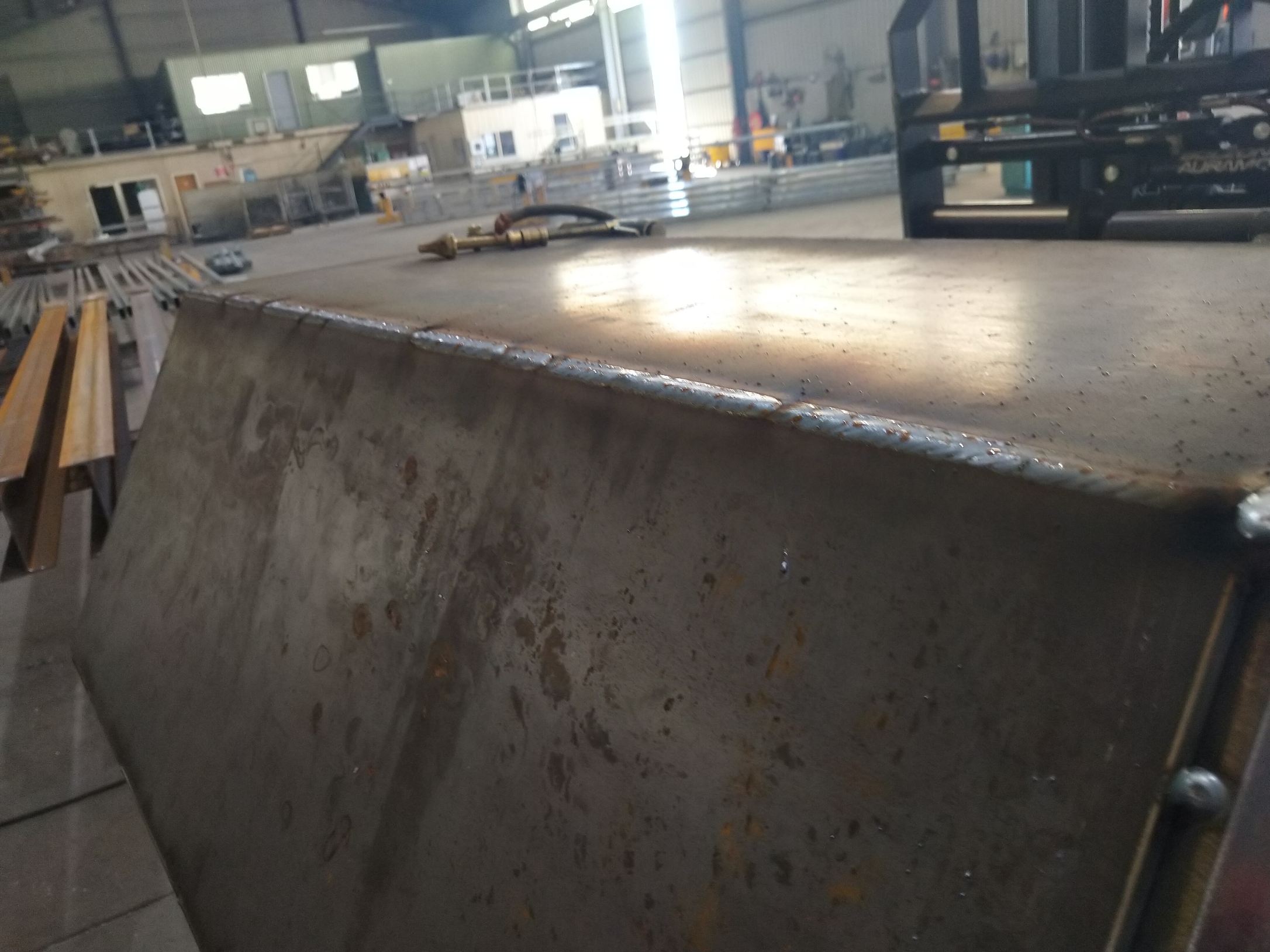

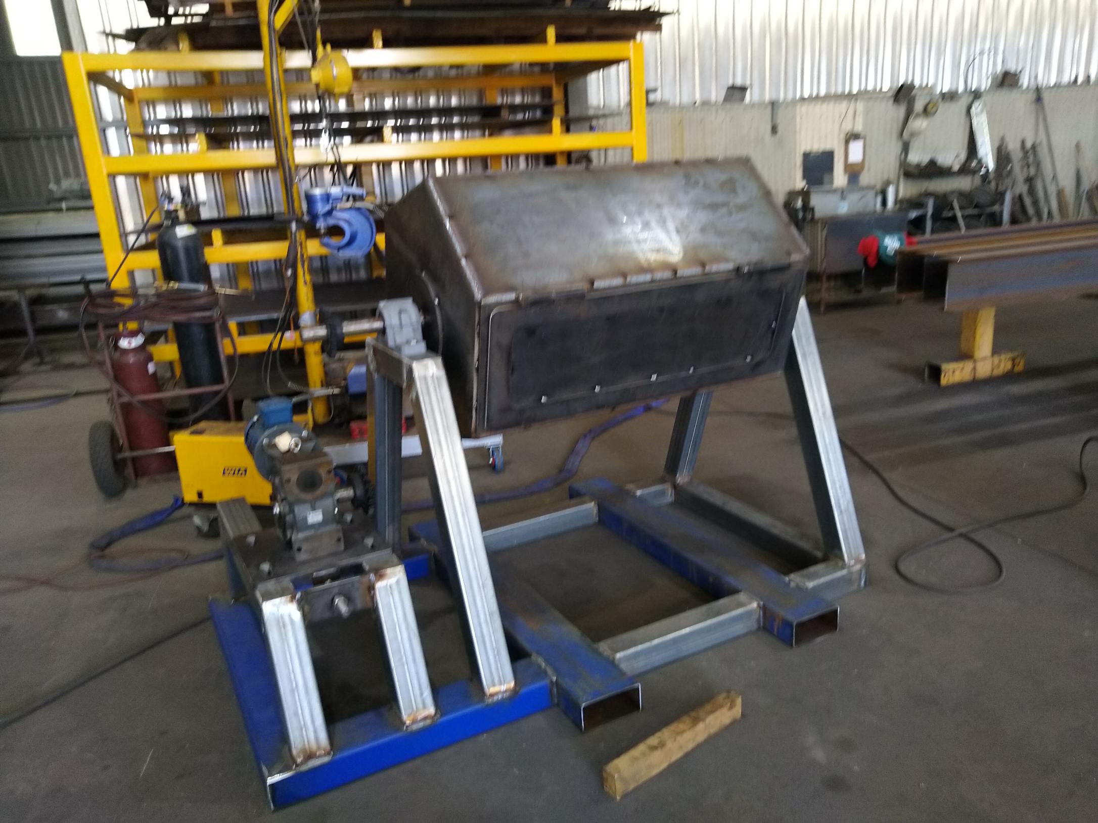

25 Apr 2020 02:58 - 25 Apr 2020 02:59 #165479 by thefabricator03
Mounted the drum door and got most of the drum welded.
