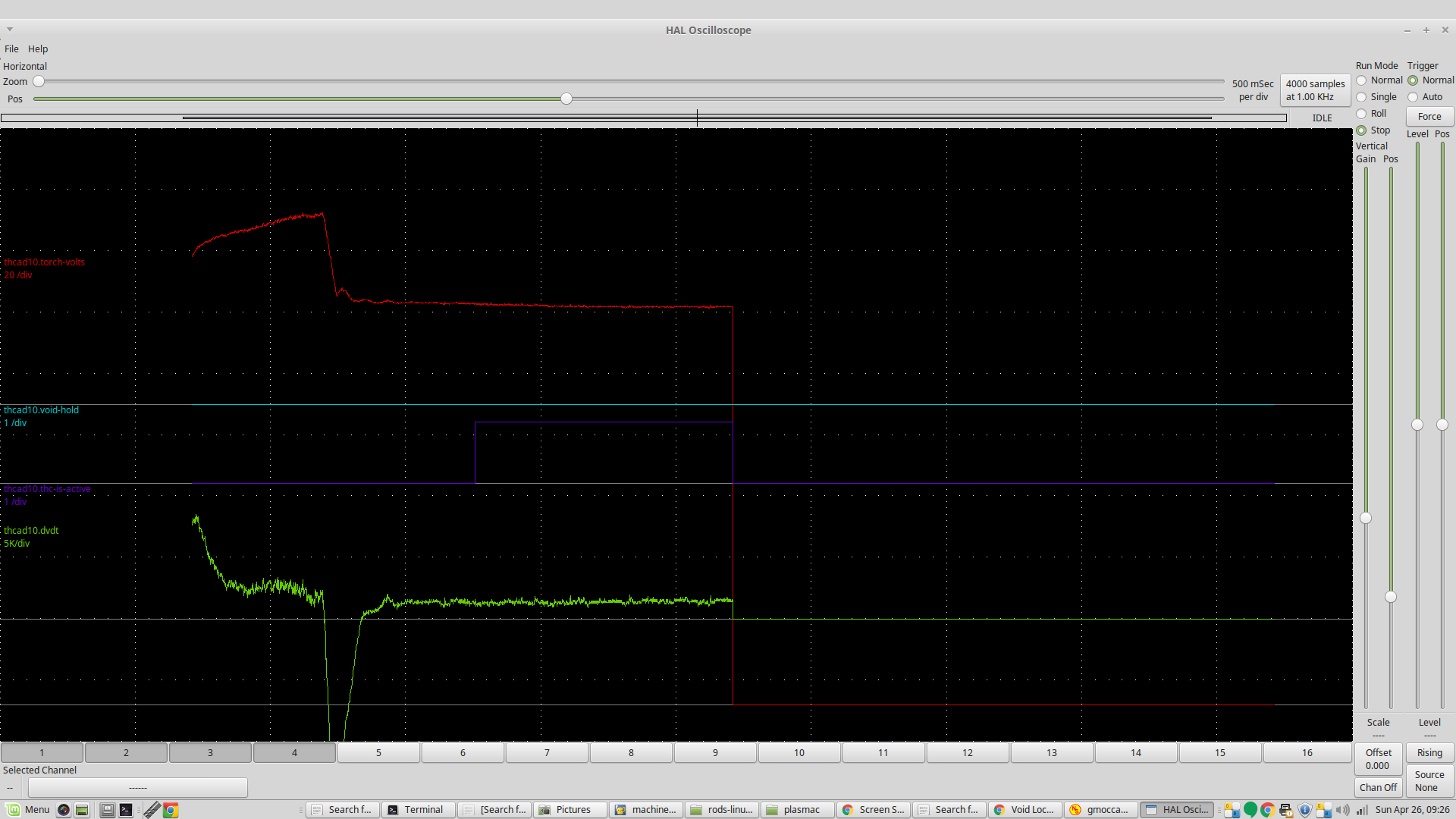

19 May 2020 20:35 - 19 May 2020 20:36 #168336
Replied by rodw on topic My Newb Plasma Table Attempted Build
This is an oldie (pre-plasmac) but a goodie showing volts at the start of a cut (in red) and when the THC goes active (in blue)
So if you do not wait long enough to sample the volts, you will sample in that piercing peak area. Then the THC decides it need to get back up to the sampled volts so eventually it is too high to sustain an aec. Hope this helps.
Set the delay time to be 1.5 seconds and see how you go. the two plasma boxes and different material (up to 16mm) I have played with did not seem to ever need a longer delay but in thin stuff, you might be able to sample at 0.5 seconds.
Last edit: 19 May 2020 20:36 by rodw.
The following user(s) said Thank You: dvn4life1972

20 May 2020 17:59 #168416
by dvn4life1972
Hi Rod. Thanks a lot for the info. I'm getting ready to run those test cuts that Phil asked for. Question. THC active signal only goes to vertical 5/div and led-down. Where should I set those in halscope?
Replied by dvn4life1972 on topic My Newb Plasma Table Attempted Build
Until you get the hang of halscope, just set it to normal and roll up the top right. Also you have to scale things right or they will be to big to fit on the screen. Start with the vertical scale to be 50/div so to vertical lines will be 100 volts. Sometimes 20/div will also fit in. as far as the horizontal goes, 200 ms/div is a good setting.
