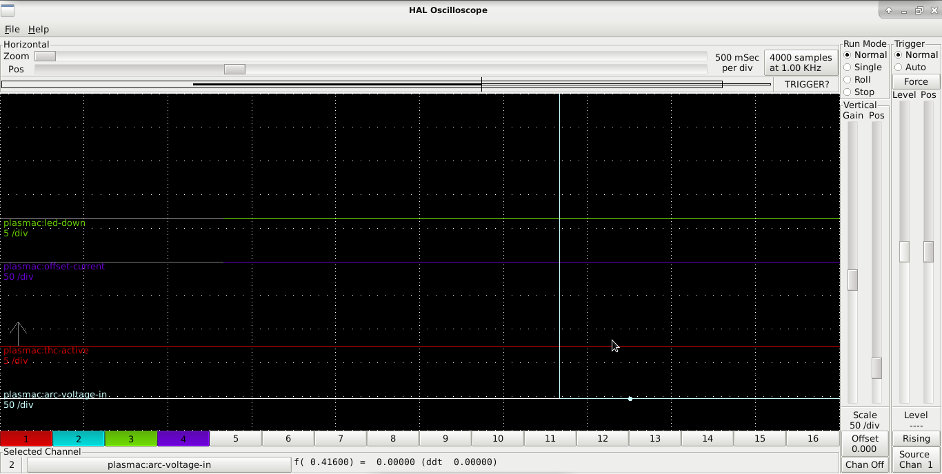

The halscope still seems to be too zoomed in to be able to see what's going on.
Rod...

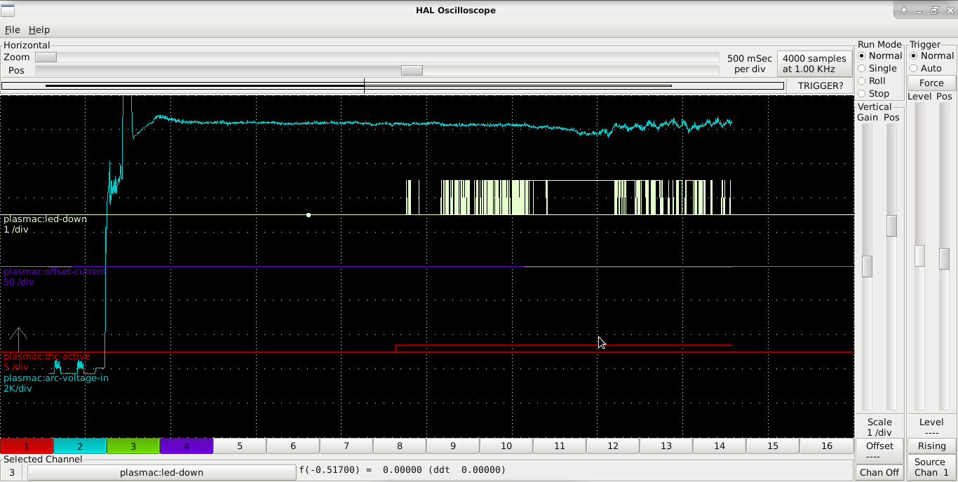

20 May 2020 18:40 - 20 May 2020 18:43 #168429
by dvn4life1972
Replied by dvn4life1972 on topic My Newb Plasma Table Attempted Build
Finally got something...although it's questionable if it's usable. This is as much as I can get the thing into view in halscope. Sorry guys.
10in long cut with THC on (had to because halscope is set for it to trigger).
Edit: Phil, I also reset PID P gain to 10 where it was when we started on this road for the sake of seeing what those original conditions were like.
Last edit: 20 May 2020 18:43 by dvn4life1972.

20 May 2020 18:44 #168430
by phillc54
Replied by phillc54 on topic My Newb Plasma Table Attempted Build
oops, sorry Pat it should be plasmac.arc-voltage-out not plasmac.arc-voltage-in
The following user(s) said Thank You: dvn4life1972
- Posts: 12178
- Thank you received: 4155
20 May 2020 18:45 #168431
Replied by rodw on topic My Newb Plasma Table Attempted Build
The plot is good but I'll let Phil guide you on the settings. Is it possible you have something reversed so Plasmac's down move is actually moving the motor up? That would do it. watch the z axis shaft movement during another cut and think about the down signals in this plot....

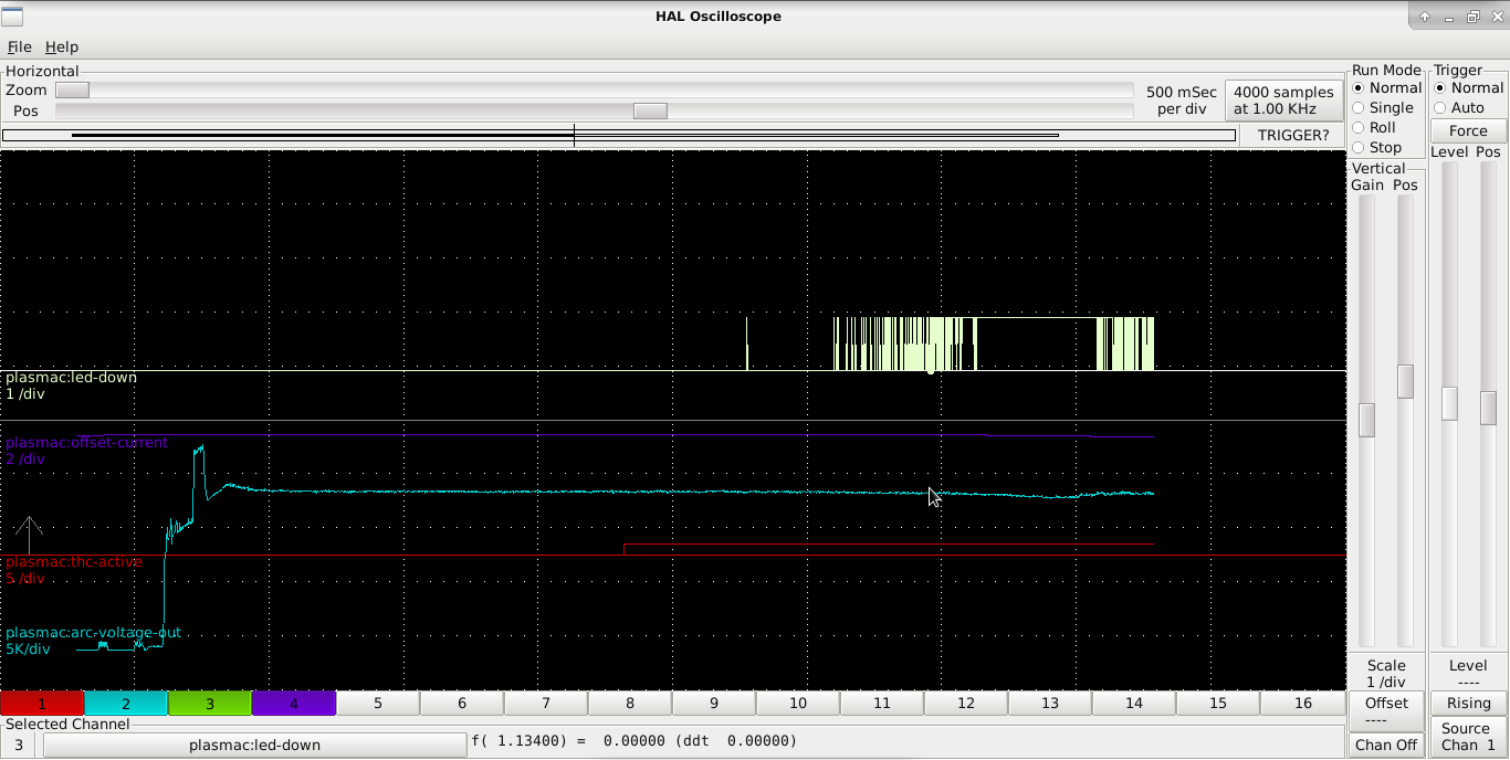

20 May 2020 18:53 #168433
by dvn4life1972
Ok. I just ran another cut. I monitored what the torch was actually doing as it cut. I'm using THC, a 10in single cut in the Y axis, and this particular steel is a 2ftx4ft piece of scrap that is warped. So, ideally, the THC should move the torch upward as it advances - following the bow of the steel. It physically did do that. It went down very briefly about 3in into the cut, then gradually and very slowly went up (seemed fine). Here's the plot, and I changed that one plot to voltage out as requested.

20 May 2020 18:57 #168434
by phillc54
What voltage does the GUIdisplay when cutting, according to that plot it is around 15Kv

20 May 2020 19:00 #168435
by dvn4life1972
Uhhh I was watching the z axis lol. Last time I watched it's around 120ish. I'm fixing to run another one, I'll have it posted and I'll get that for you (to be sure) this time. With the 60A consumables the machine was running about 145v or so on the same material, for reference if needed.
