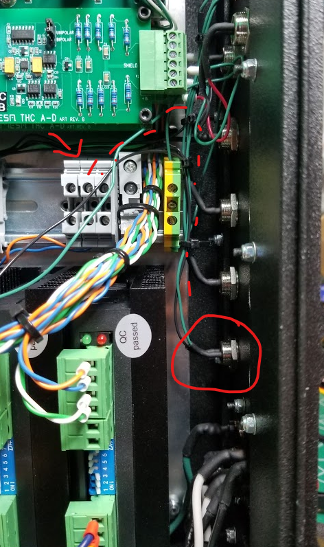

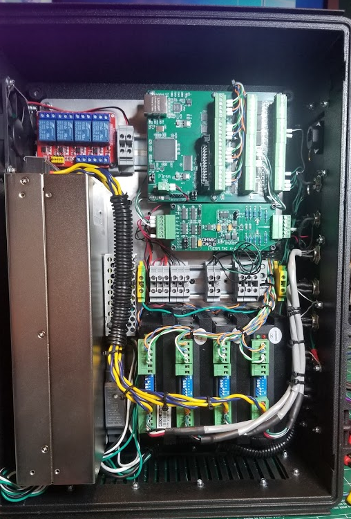

24 Aug 2020 01:04 - 24 Aug 2020 01:10 #179167
by xnaron
Replied by xnaron on topic Controller build for Plasma
Thanks. For my table this would be less of a concern then as I only turn it on when I am going to cut. I can add one later if it becomes an issue.
Here is how I have the ohmic probe wires run. Using 22 gauge and they run along a couple of other inputs. The terminal blocks with the arrow will be where the ground and resistors for the ohmic terminate. Anyone see any issue with the wire size or placement?

25 Aug 2020 07:10 #179324
Replied by tommylight on topic Controller build for Plasma
No concerns if they are properly shielded. Shielding should be grounded only on the electronics side.
Ohmic probe wires routed along other inputs and 22 gauge. Concerns?
