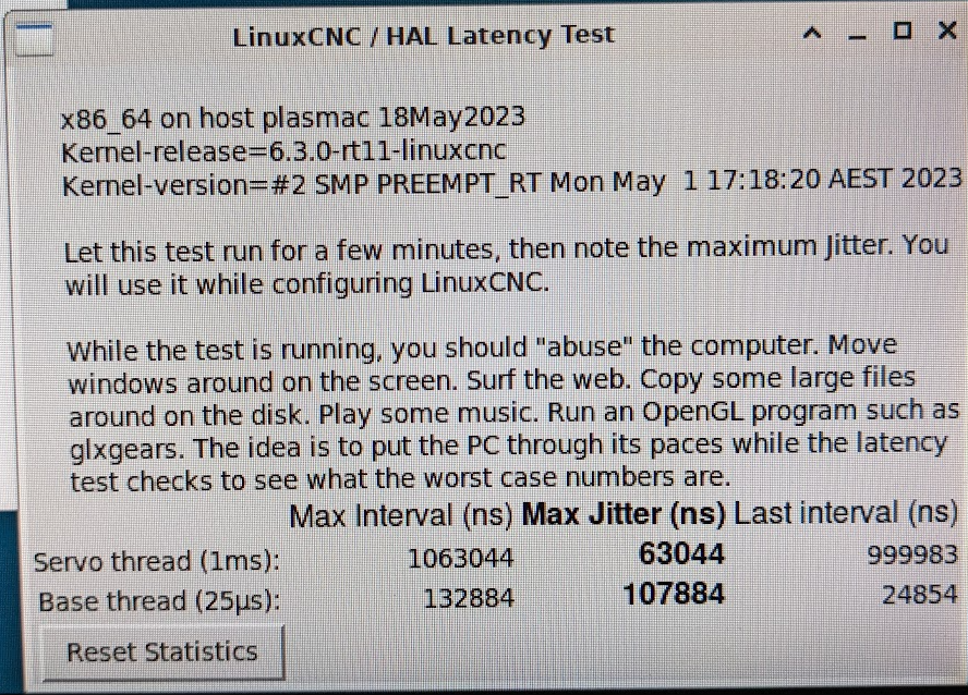

16 May 2023 21:36 #271473
by xnaron
Replied by xnaron on topic Controller build for Plasma
Well I didn't end up putting the controller into service and now I get to read through my thread again to remember everything I have done. I ended up blowing away the tiny pc that I had linuxCNC setup on so now I need to start that all over again. Does the latest ISO from the website support the mesa 7i96 or do I still need to do something special with the kernel selection? I realize the 7i96 was replaced with 7196s because of availability issue for the FPGA. Hopefully should be able to follow the same process to get it setup again.
- Posts: 22002
- Thank you received: 7488
16 May 2023 22:22 #271477
Although you might want to go with Debian BookWorm as LinuxCNC is in their repositories from now on.
cdimage.debian.org/cdimage/bookworm_di_r...-rc2-amd64-DVD-1.iso
Install, reboot, update and upgrade, then
sudo apt install linuxcnc-uspace
Replied by tommylight on topic Controller build for Plasma
It should, both.Does the latest ISO from the website support the mesa 7i96 or do I still need to do something special with the kernel selection?

17 May 2023 00:21 #271491
by xnaron
Thanks. Just reinstalled and updated.

18 May 2023 21:46 #271627
by xnaron
