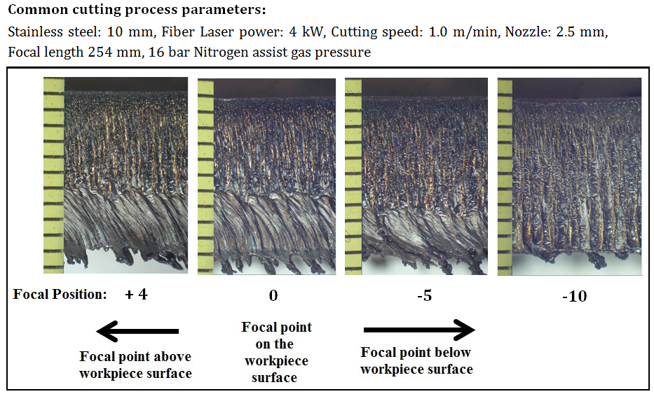

i dont think its good idea,,,
it relies on factors
1, distance between head and work-peace (piercing and cutting have different focuas
2 material thickness
3 speed of cut ( fine tuning)
its better to be configured same as material,, in plasmac

Replied by rodw on topic PlasmaC Fiber laser 1Kw head height control + auto focuas
Perhaps the focus motor is an axis that is controlled by a hal component which in turn applies an external offset to that axis so no gcode is required. So again similar to Plasmac.

Replied by taloot on topic PlasmaC Fiber laser 1Kw head height control + auto focuas
yes and i want to link it to plasmac material controlPerhaps the focus motor is an axis that is controlled by a hal component which in turn applies an external offset to that axis so no gcode is required. So again similar to Plasmac.

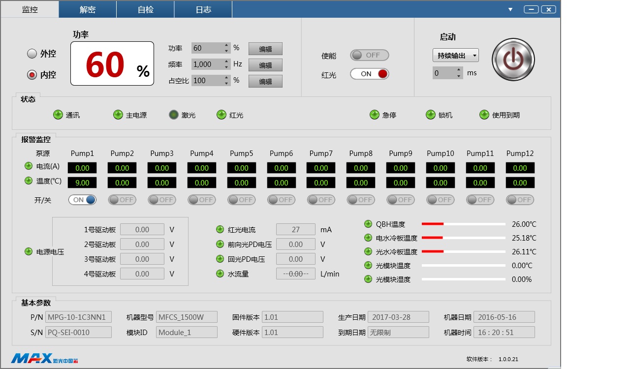

okey i have some updates,
i used the capacitance to 0-10 converter. and its connected to THCAD10 and from THCad ---->7i96
probe is fixed
i configure the focus as an axis, and i will control it with external offset for piercing i have specific focus value and another one for focus
also i have the protocol for the laser on RS232,,, i can choose the frequency and the power of the laser ( change them according to my need) cut or engrave
1.i want to link the rs232 to control the laser power.. what hal pin represent this in plasmac and how can i do it to control the power
2.i want to make vitrual insturment dashboard for the laser source,, whats the best method to do this ( i m using buster debian )
probe is fixed

09 Apr 2020 01:08 #163269
by phillc54
Replied by phillc54 on topic PlasmaC modification to fit fiber laser rs485 control head capacitance Autofou
PlasmaC doesn't use anything like that, the torch is either on or off.
If you want to set the power from gcode, you may be able to use one of the spindle speed pins from motion or if you need to set the laser power according to velocity you could run the X and Y joint velocities into a hypot component.
linuxcnc.org/docs/2.8/html/man/man9/motion.9.html
linuxcnc.org/docs/2.8/html/man/man9/hypot.9.html
