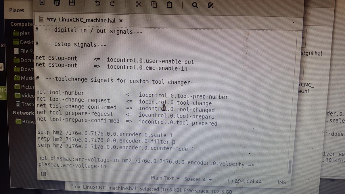

Help with adding PlasmaC to base config + 7i76e
- Plasmaguy
- Posts: 76
- Thank you received: 9
- phillc54
- Posts: 5711
- Thank you received: 2100

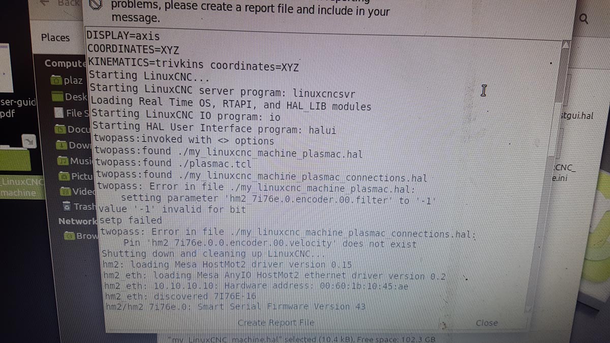

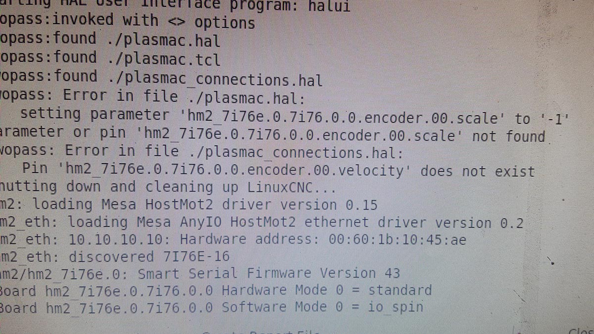

hm2_7i76e.0.7i76.0.0.encoder.00You should have:
hm2_7i76e.0.encoder.00You need to remove the extra "7i76.0.0." from all the encoder lines

valid values for bits are 0,1 or true,false

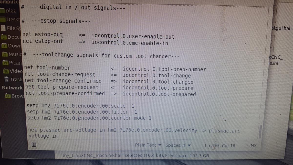

hm2_7i76e.0.encoder.00.velocity
hm2_7i76e.0.encoder.00.filter 1
etc, as Phill mentioned earlier, if you'd bother to read.
You have them as
hm2_7i76e.0.7i76.0.0.encoder.0.scale
etc.
Encoder is not on the same address as IO pins, so not the same stuff is valid for them.

Here's the code attached to the end of my base hal file:

setp hm2_7i76e.0.encoder.00.scale 1
setp hm2_7i76e.0.encoder.00.filter 1
setp hm2_7i76e.0.encoder.00.counter-mode 1
net plasmac:arc-voltage-in hm2_7i76e.0.encoder.00 => plasmac.arc-voltage-in

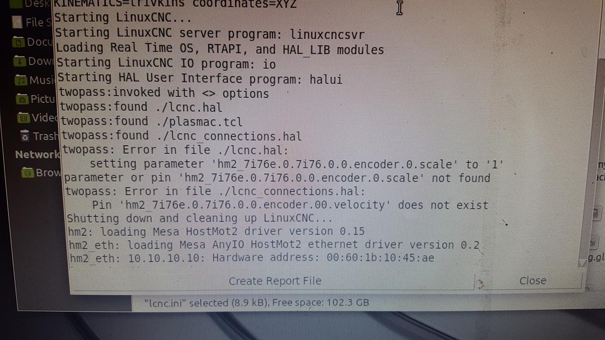

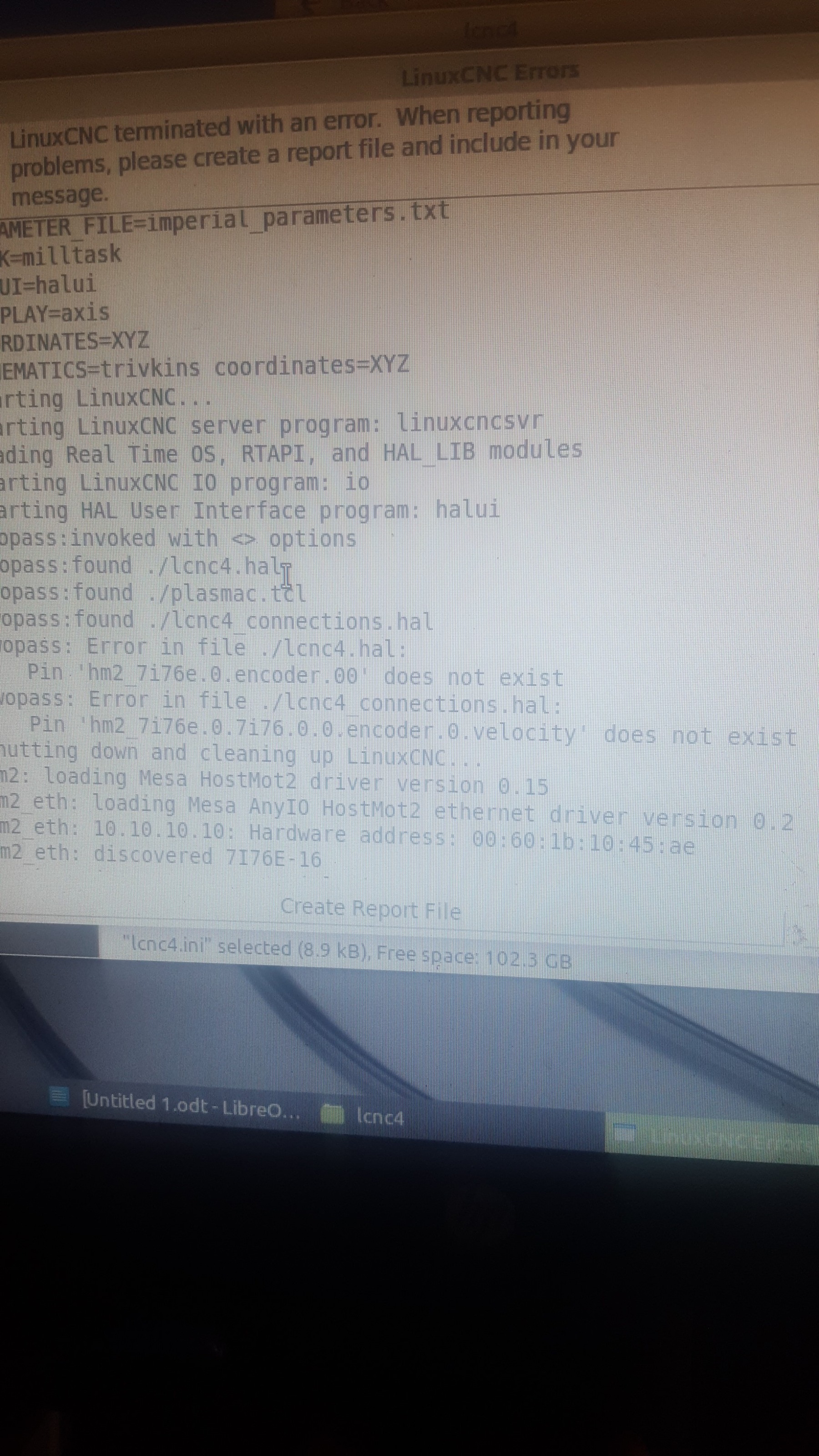

Here's the error I get:

this reply.
You would not use the A hal pin on the encoder for a THCAD,
but rather the encoder velocity signal:
hm2_7i76e.0.7i76.0.0.encoder.0.velocity
