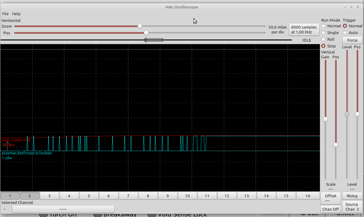

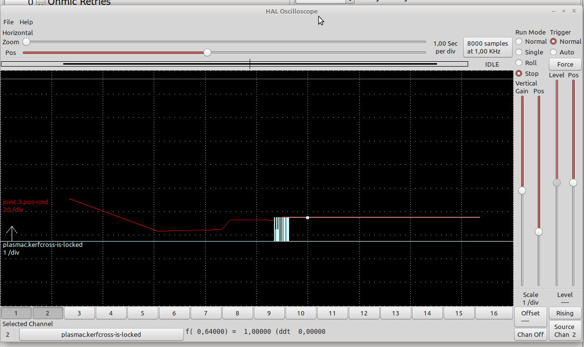

Thanks Tom, I will be interested to see the plot. Did you try increasing the kerf_errors_max parameter?Did some tests today regarding void sensing and the results are pretty messy,
===setup===
Cebora 120A plasma source set at 50A (does 60 measured), 1.4mm nozzle
Feed rate at 3600 and 1800mm/m (can cut at 4.4m/m with the same current/nozzle)
- cut 10 columns of 200mm length spaced at 30mm
- cut 15 rows of 350mm long cuts
- changing the void sense override on the config panel from 1 to 500 does change the results, but after going on and off several times at the beginning of the cuts ( even when not over a void sometimes ) it just stays on after passing the first to third column/void, remains on a bit after the torch is off.
I did save the hascope data and a screenshot, but they are on the machine PC outside so i will upload them tomorrow.

Did not know it existed till now, will give it a test later.Did you try increasing the kerf_errors_max parameter?
