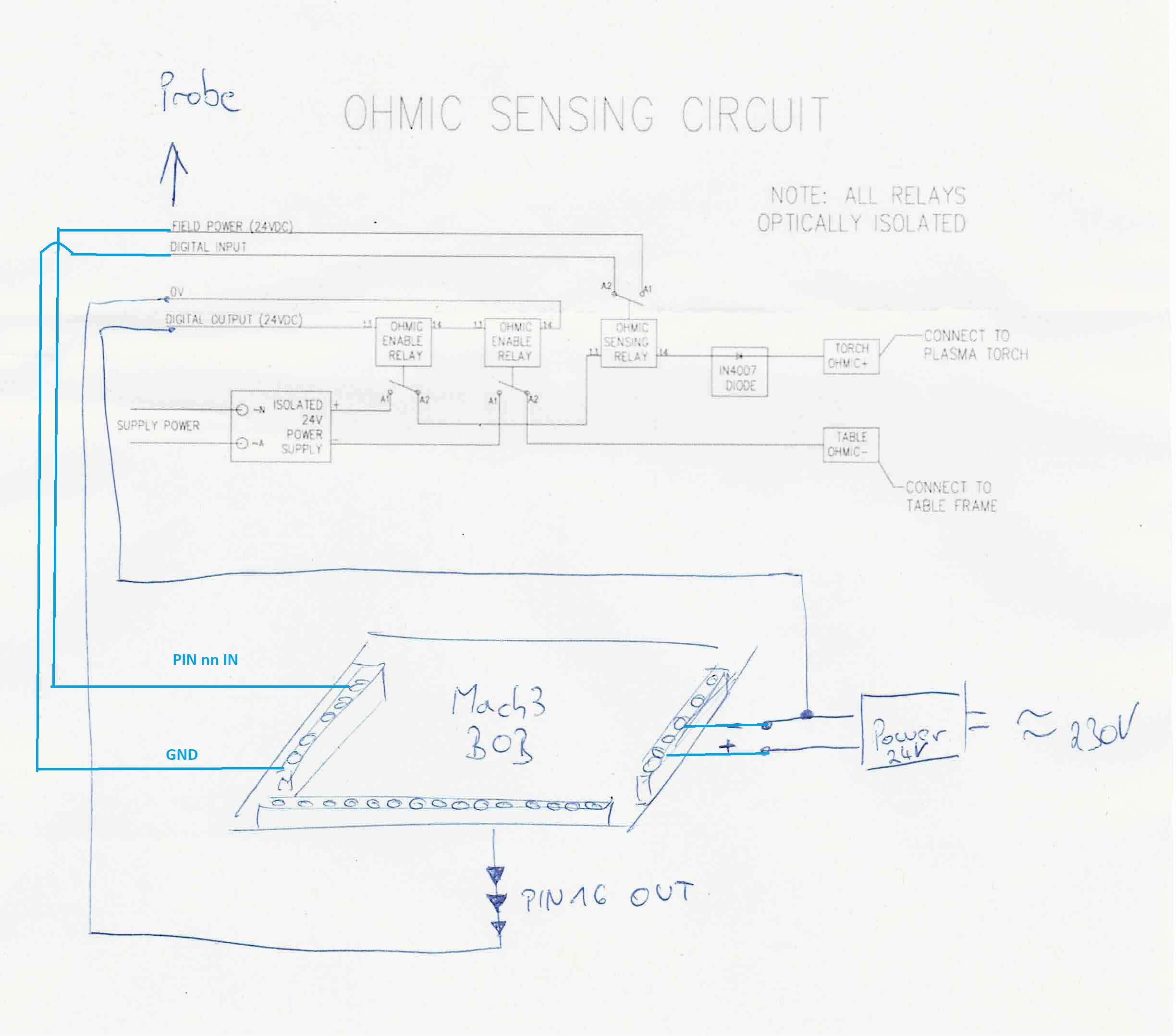

29 Mar 2021 13:05 - 29 Mar 2021 13:07 #204085 by Giuseppe
Replied by Giuseppe on topic Configure PlasmaC with only one BOB
So next step :-)
My OHmic Probe circuit is connected to parport.0.pin-16-out.
As i wrote in one earlier post, the circuit is still activated when i start plasmac.
When i turn it off in the RUN Panel then my circuit is stays on.
I have measured PIN16 and GND and get no stabel voltage and there is no differents
when i turn probe on or off.
But, when i measured pin16 and pcgnd on the BOB then i get 5V. And this turns on and off when i trigger the checkbox in the RUN panel. My circuit GND is connected to the powersupply.
Any one can help?
Last edit: 29 Mar 2021 13:07 by Giuseppe.
29 Mar 2021 20:05 #204104 by phillc54
Replied by phillc54 on topic Configure PlasmaC with only one BOB
So next step :-)
parport.0.pin-16-out should be connected to plasmac.ohmic-enable, this is then used to enable your ohmic circuit.
plasmac.ohmic-probe needs to be connected to the parport.0-nn-in that your probe is connected to.
pin16 should change state while probing.

31 Mar 2021 07:14 #204209 by Giuseppe
Sorry but iam not shure if i understand you.
If you look at my diagram. I connect physically PIN16OUT to my circuit and probe with IN PIN. Probe works fine.
You write that "Pin16 out" change when i probe?
I thought that i can enable or desable it by hand over the run panal. But this doesn't work.
31 Mar 2021 18:18 #204331 by phillc54
You have the polarity reversed at 0V and Digital Output, 0V should go to power supply negative.
The Ohmic Probe Enable only enables plasmac to do ohmic pribing, it does not change the output. The output only comes on while plasmac is probing.

07 Apr 2021 08:02 #205252 by Giuseppe
hhmmm
I'm confused.
which way would you suggest to check the machine for correctness?
Is there a test routine to ensure correct functionality for the whole machine?
08 Apr 2021 05:02 - 08 Apr 2021 07:21 #205313 by phillc54
hhmmm
I'm confused.
Sorry, it may be the way I am explaining it.
Unfortunately not, it is a matter of testing one thing at a time.
EDIT: can you post your complete config.
Last edit: 08 Apr 2021 07:21 by phillc54.
