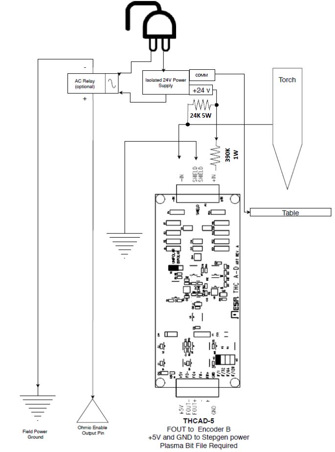

- Posts: 12156
- Thank you received: 4149
23 Feb 2023 09:20 #265113
Replied by rodw on topic qtplasmac 2.10 arc ok, thcad thc, and Thcad Ohmic troubleshooting help needed.
QTplasmac now uses different pins to what plasmac did which was the config in use when ohmic.comp was written. Consult the documentation.
Ohmic3.comp I shared uses the current pins But it will need an additional 24k pull down resistor. This hardware and software solution was devised for greater reliability on water tables.
The following user(s) said Thank You: jimmyrig
- jimmyrig
- Posts: 136
- Thank you received: 42
23 Feb 2023 15:37 - 23 Feb 2023 15:40 #265122
by jimmyrig
Replied by jimmyrig on topic qtplasmac 2.10 arc ok, thcad thc, and Thcad Ohmic troubleshooting help needed.
Thanks for the pull down doc, will give that a shot, i'm hopeful that will work with my current code.
I did follow the 2.9 plasma primer docs which is where that error came from. Since 2.9 wasnt using the plasmac gui i figured it would be up to date. Doesnt look that way. Also searched the qtplasma docs for additional data but didnt see any. Anywhere else I should look? Still learning where to go in the docs so it wouldnt be surprising if i am missing something.
linuxcnc.org/docs/2.9/html/plasma/plasma-cnc-primer.html

- Posts: 12156
24 Feb 2023 02:15 #265195
Whan you run pncconf to make a QTplasmac config, There should be a field for you ohmic pin. You would use ohmicsense.ohmic-on
here or edit your hal to use that pin afterwards as it might not let you entere an arbitrary pin name.

25 Feb 2023 21:37 #265357
by jimmyrig
Alrighty got it working from a software standpoint! Here is the solution for anyone else! The documentation in 2.9 needs updated to unlink the correct pin (db_ohmic)! The table successfully ohmic probes just fine without the touch running. With the torch running is a different story, details in the next post
