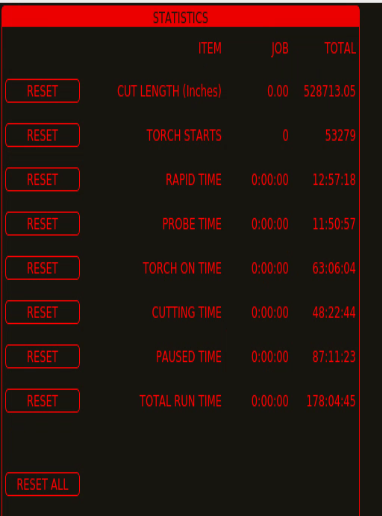

19 May 2024 05:46 #300954 by jimmyrig
I am upgrading the table to include a 4th axis rotary and figured i would update the system to debian 12 while at it and provide a update on how things went.
I forgot to push that update, if it wasnt made will push it when i go to debian 12.
Well its been a while but here are the results of ~ 1 year of use. (see pic)
a little over 8.4 miles of cutting or 13.4 km, and about ~53k pierces.
torch was on for 63 hours.
ohmic has worked flawlessly in all kinda of weather (rain/snow)/ well below freezing to very hot. (table under a carport so kinda exposed to the weather),. I much prefer ohmic as i full rapid for each pierce so times are ~1 sec instead of the ~3-4 that probing takes.....when doing ~53k peirces that saved a day worth of run time!

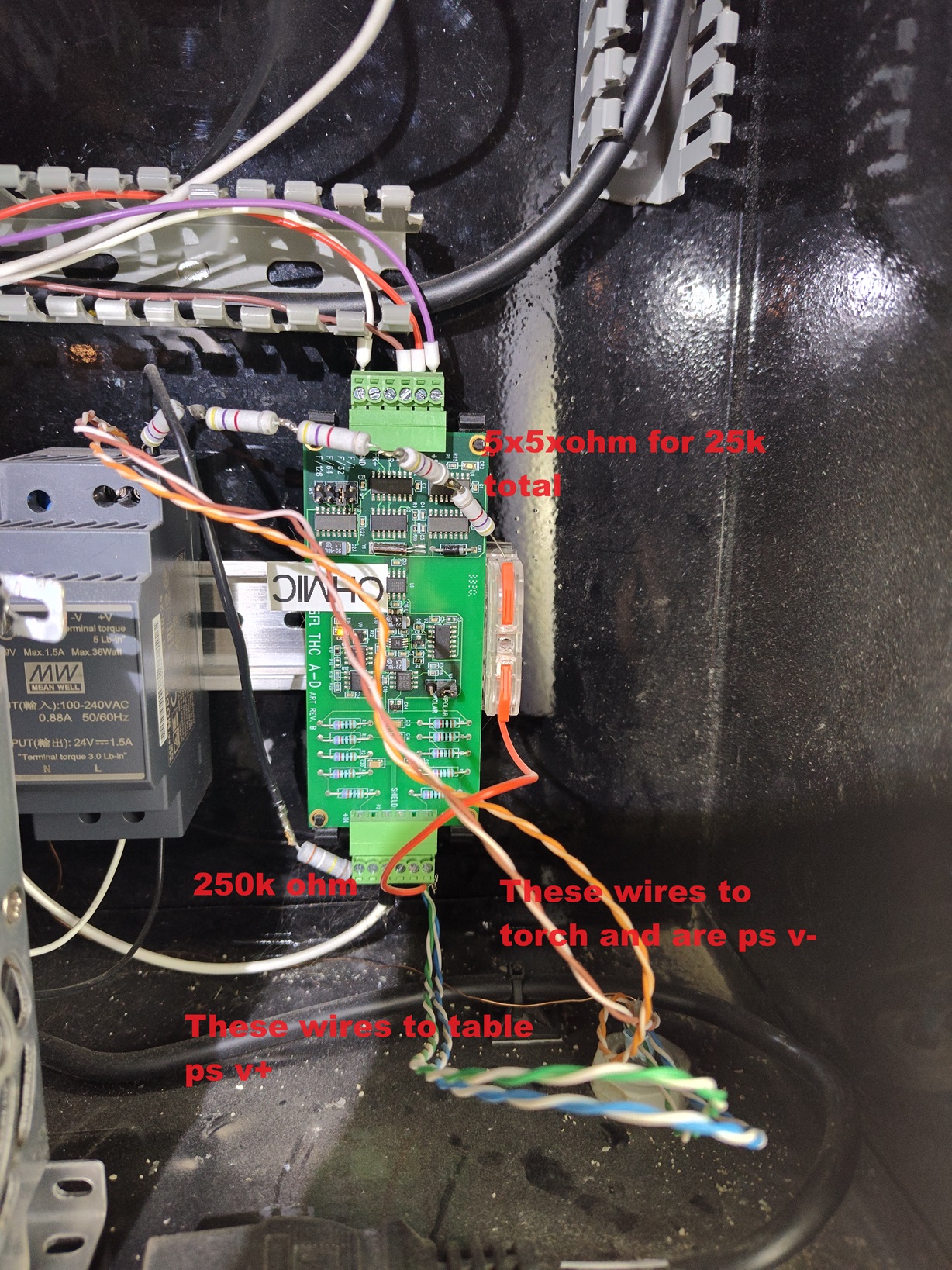

Below is my current ohmic setup via a terrible paint drawing if anyone wants to replicate my setup.
5x5k 1w resistors for ~25kohm (22.5k in reality)  between v+ of power supply and in- of thcad.. The table connects to -in at the thcad as well
1x250kohm resistor between thcad v+ of power supply and in+ of thcad
power supply v- to torch (ohmic shield)
With this setup when the torch is full of junk it reads ~24v letting you know the torch is messed up while allowing ohmic probing to continue
