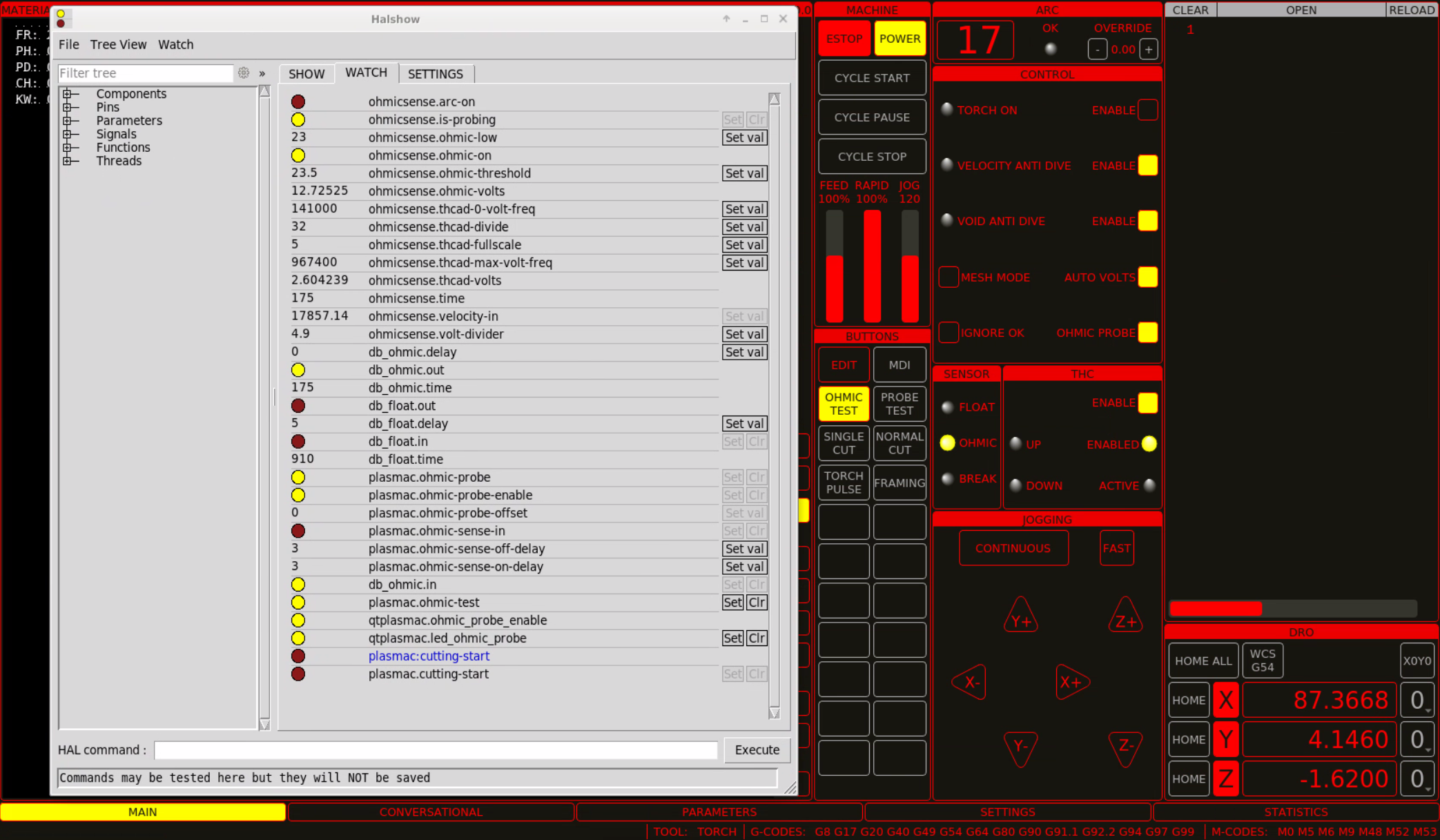

Below is a screenshot of an ohmic test with a slightly shorted torch. The torch is off of the table/material as noted by the 20ish volts of arc.
Are you sure the slag/dust is causing this? Have you cleaned the torch and verified the voltage goes back to 0v? I am not sure what plasma cutter brand you are using, but in my experience it's either been shorted or it wasnt.
I am seeing a ohmic voltage of 13ish...... should be zero. not sure why this is, may play around with resistor values to see if it changes. Turning on or off the plasma doesnt change the values.
I ask the above question because this is exactly what I saw with my setup, but it had nothing to do with the cleanliness of the tip. The longer I cut, the higher the ohmic voltage remained after each cut was over. Eventually the ohmic voltage would just remain at near max rendering it useless. It's been quite some time, but I seem to remember that either unplugging the torch from the plasma power supply, or removing the ground clamp from the plasma power supply made it go away. I'm not sure why this occurred, but it occurred on more than 1 table. Worth noting that the plasma power sources were Hypertherm in these cases.

regardless it shouldnt be tripping the ohmic at 13 volts but  it is....... any idea why that could be?
Yes, assuming your hal snippets/files are what you are actually running on your table, then you are actually using Mode 0 (the default mode in the component) and not the moving average (Mode 1) Rod has been talking about.
The specific reason is that there is a bug in the code for Mode 0 (line 3 below):
        case 0:
          if(is_probing)
            ohmic_on    = (ohmic_volts >  (ohmic_threshold && is_probing) ? 1 : 0);
          else
            if( ohmic_volts < ohmic_low)
                ohmic_on = 0;
          break;
The explanation of the bug is: (ohmic_threshold && is_probing) is evaluated first. Since ohmic_threshold is almost always a number above zero, and is_probing = 1 (per your screen shot), the expression simplifies to ohmic_on = (ohmic_volts > 1 ? 1: 0). So, any voltage above 1 will cause it to trip.
At minimum a fix would be:
        case 0:
          if(is_probing)
            ohmic_on    = (ohmic_volts > ohmic_threshold ? 1 : 0);
          else
                ohmic_on = 0;
          break;

I've got my ohmic low set to 23 (the screenshot i posted has hal show with all my settings)

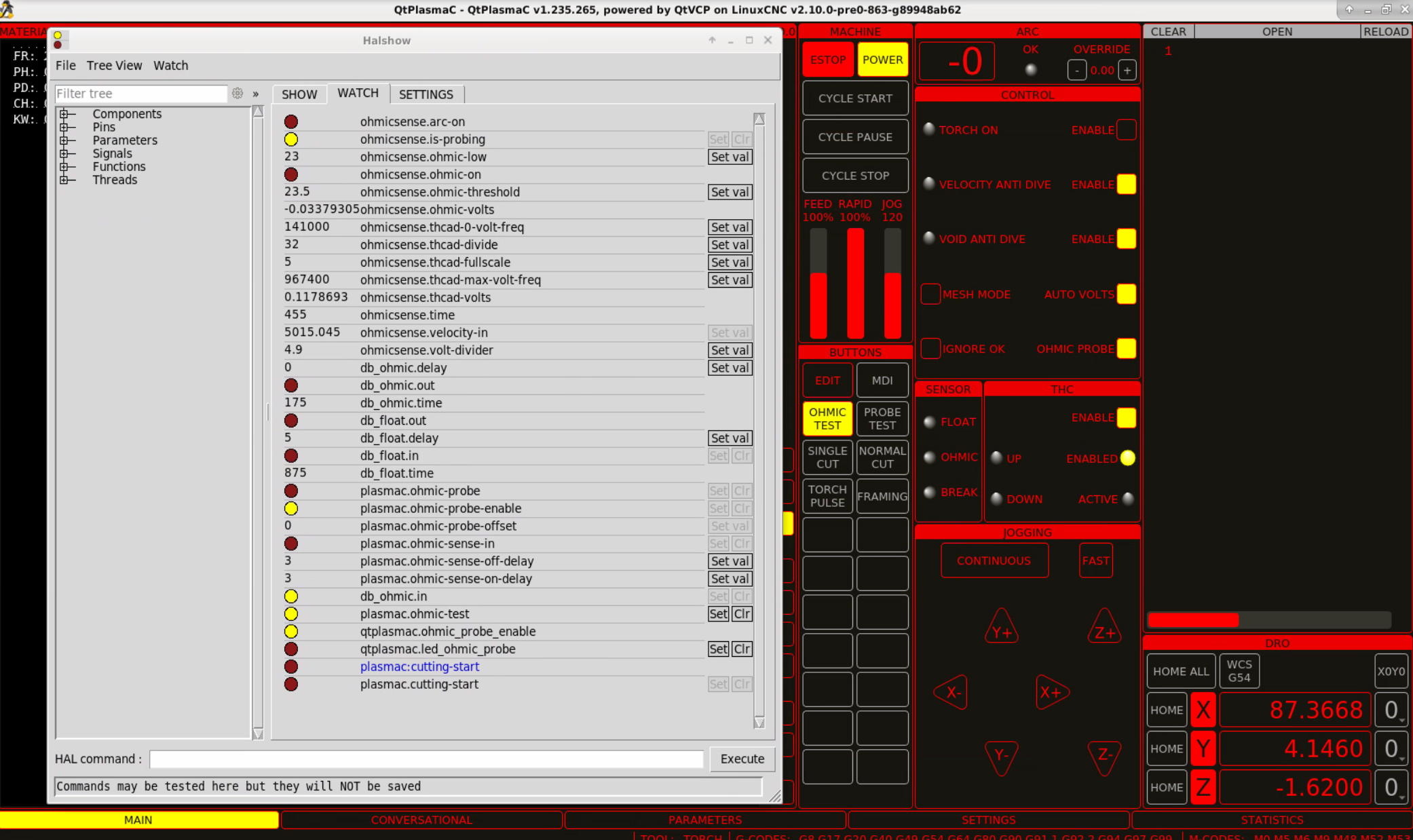

26 Feb 2023 21:24 #265445 by jimmyrig
Yes, 100% sure. That doesnt mean I wont run into the issue you were having as they might be independent. ...so far i have been only able to run for about 5 min before a failure, each time the tip gets a small chunk of slag in it which causes the shutdown.
Attached are screenshots of hal show before and after cleaning when ohmic test is clicked. I was going to take a picture of the nozzle but the chunk of slag fell out.... will try again in a few.
This was after first powerup with the plasma, pc and electronics box all shut down for 12 hours. the values were the same as before shutdown last night. So this particular problem isnt a hysterisis problem.
Thanks for the code working on that now and will give it a shot!
