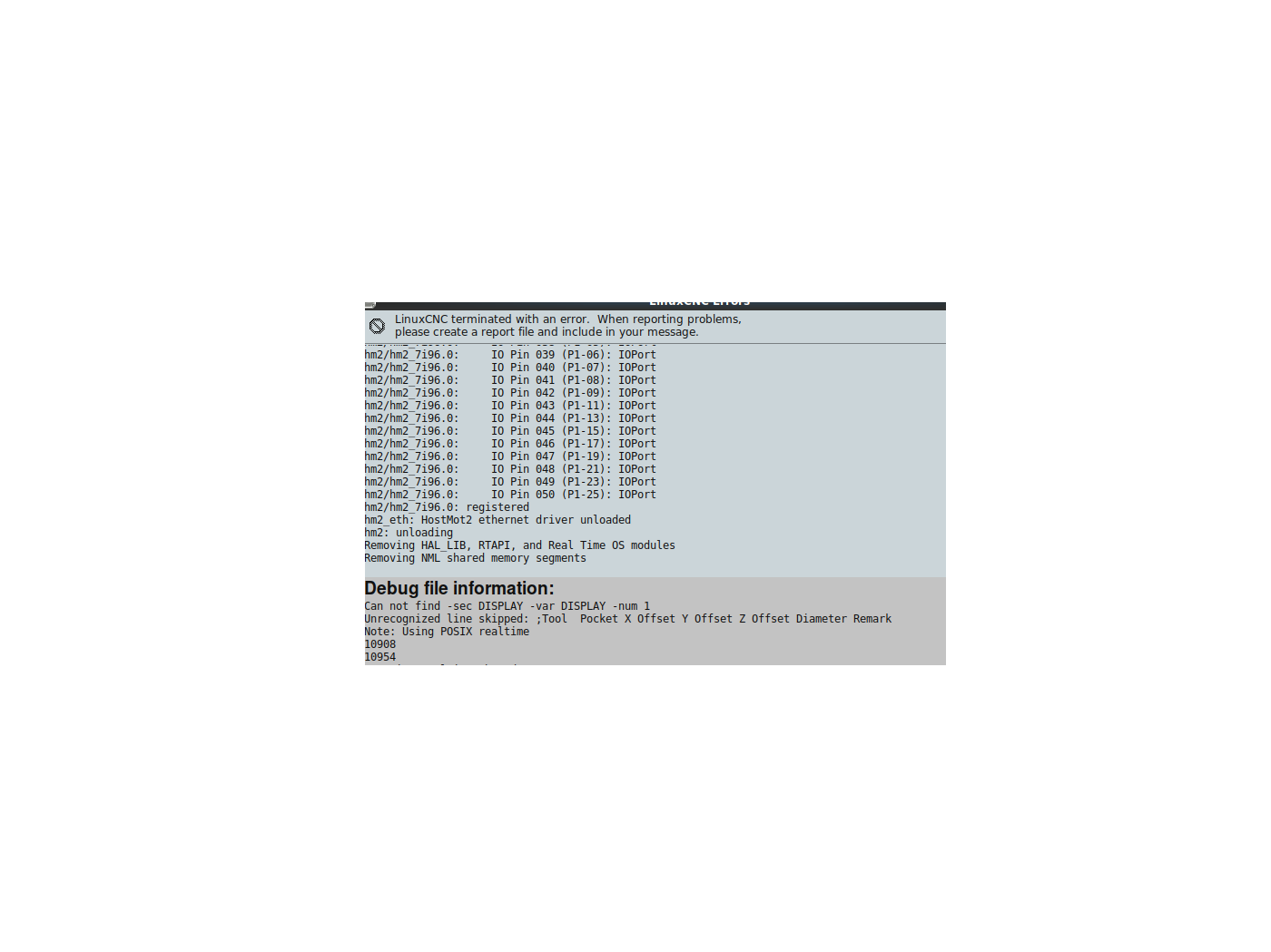

I updated qtpyvcp also and my machine won't go to splash screen.
It went to watchdog led on the Mesa card immediately. No error screen
Switched to axis and it's fine
It also works with some of the other qtpy samples.
Miltouch v6 doesn't work but bp touch does

i launched it from the terminal
it looks like a path may have changed?
it looks like its looking in linux cnc configs and not in the home directory
[qtpyvcp.vcp_launcher][INFO] VCP is a directory (vcp_launcher.py:128)
[qtpyvcp.vcp_launcher][ERROR] Could not load the specified VCP, make sure that the name orfile path is correct. (vcp_launcher.py:135)
task: 1293 cycles, min=0.000011, max=0.010227, avg=0.009948, 0 latency excursions (> 10x expected cycle time of 0.010000s)
hm2_eth: HostMot2 ethernet driver unloaded
hm2: unloading
Note: Using POSIX realtime
leon@debian:~$
hm2: unloading
leon@debian:~$

07 Dec 2019 02:09 #152207
by Leon82
Replied by Leon82 on topic Couple questions about QTPYVCP
