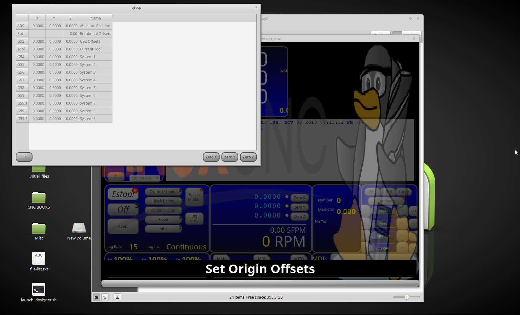

Here are some pictures from qt designer showing the tool_offset dialog partially showing in the lower rignt and when run mode is entered it is hidden. Perhasps that is the reason they are not looking at "onwindow".

I meant that all the other dialogs are placed by default in the designer designated spot. the dialog_widget is always placed in center.

Oh sorry i forgot i didn't tell you were to look..
Ok now we know your system is capable of dialog placement.
Clearly now I see we were thinking on two different things
In the docs I will try to make it clear that dialogs are pop up devices.
Chris M

that looks right the origin offsets should be placeable by the user and the tool offsets should always open at the top left.
Though I see the label at the bottom of the focus widget displays the wrong message.
f3 = origin offsets
f4 = camview
f5 = macros
f6 = tool offsets
There are other key bindings also.
all set in the handler file
Chris M
