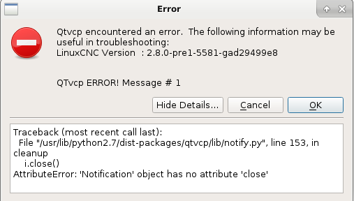

08 Apr 2020 00:20 - 08 Apr 2020 00:41 #163152
by Bruedney
Replied by Bruedney on topic Error Messages
I just got this error on close
File "/usr/lib/python2.7/dist-packages/qtvcp/lib/notify.py", line 153, in cleanup
i.close()
AttributeError: 'Notification' object has no attribute 'close'
i.close()

- Posts: 7368
- Thank you received: 2181
08 Apr 2020 08:35 #163200
Replied by cmorley on topic Error Messages
can you tell me something about your system?
What distribution?
is it installed or RIP?
how did you get it? (buildbot or one of the ISO from forum etc)
Is this rasberrypi?
Did you see a desktop bubble pop up and then clicked it to close it?
Chris

08 Apr 2020 13:58 - 08 Apr 2020 14:02 #163227
by Bruedney
What distribution? Debian 2.8 official
is it installed or RIP? installed and working
how did you get it? (buildbot or one of the ISO from forum etc)Qt Dragon or Linuxcnc? QT Buildbot I think -actually various - Linuxcnc ISO from LinuxCNC.org
Is this rasberrypi?No
Did you see a desktop bubble pop up and then clicked it to close it? Axis Manual tool change window bottom right and QT dragon welcome top right - both disappear by themselves - Or did you mean the error message dialog?
Chris

08 Apr 2020 15:47 #163236
Ok do you know what version of Debian?
And to confirm the screen works fine bit when you close if shows the error?
Chris
