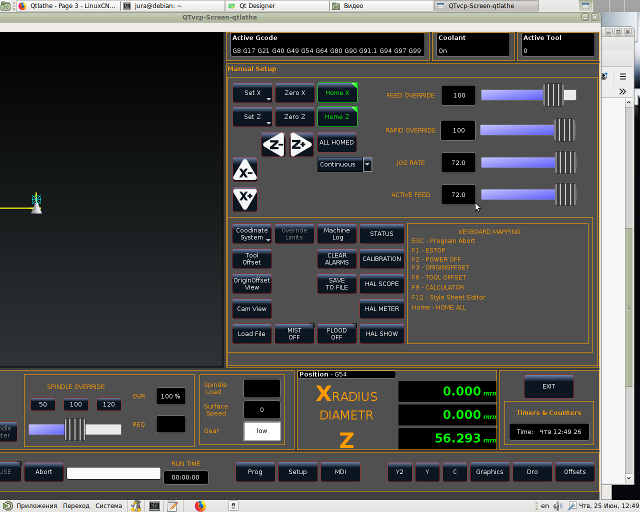

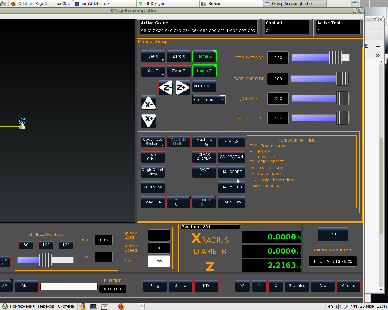

I mean the numbers in the status label jog rate, active feed as in the screenshots of the previous post.
I give screenshots of how it works in this interface. As 72 beat, 72 remains. When run macros error z positive limit. In INI file I put MAX_LIMIT = 4.0 the error goes away. Also added macros go_to_zero and go_to_home please check the correct operation. Test file works good.DTG necessary or not? If necessary, how to add a third page to dro?

ahh yes jog rate in status label should switch units when in g20/g21 mode.
right click on stacked widget in designer allows adding pages.
DTG on lathes is popular.
I am too busy at work to do much coding for another 10 days or so..

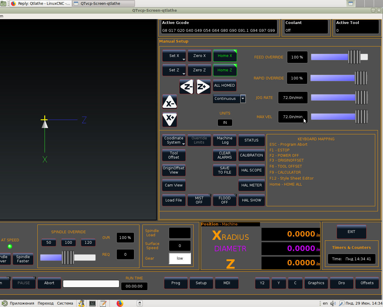

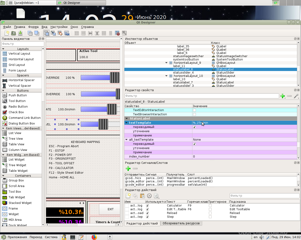

pushed a fix for status label's jograte and maxvelocity units on g20/21

Thanks, that works (if next == self.w.droPaneStack.count). But here you can somehow register
when g21 then mm / min. Everything works except F12 and remove Shutdown after Start.
I added another golden widget MDITouchy.
