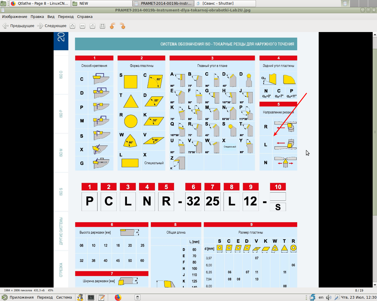

a circle with a line though it usually means no or negative - I would remove the line - green circle is good.
I'm not sure I understand:
Q-orientation tool cannot the number, it can beat R, L, N.
orientation is a number:
linuxcnc.org/docs/2.8/html/lathe/lathe-u...e_tool_orientation_a

Thanks for the clarification. Better to remove the green circle. I confused the Q orientation tool with the cutting direction, as in the screenshot of the standard cutter symbols. Sorry, I will teach better.

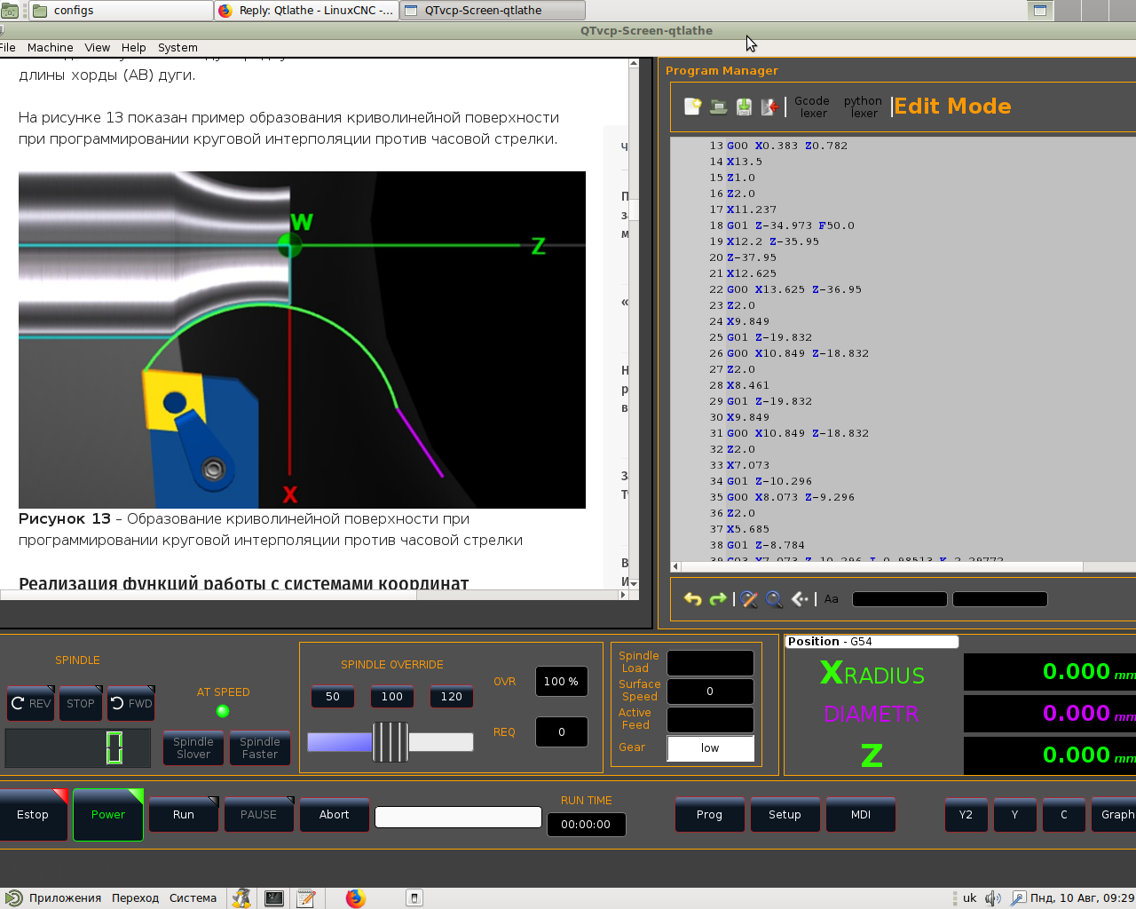

I was thinking of using the WebView page for reference documentation while editing Gcod.
Do you think that a code editor is not needed for a turner?

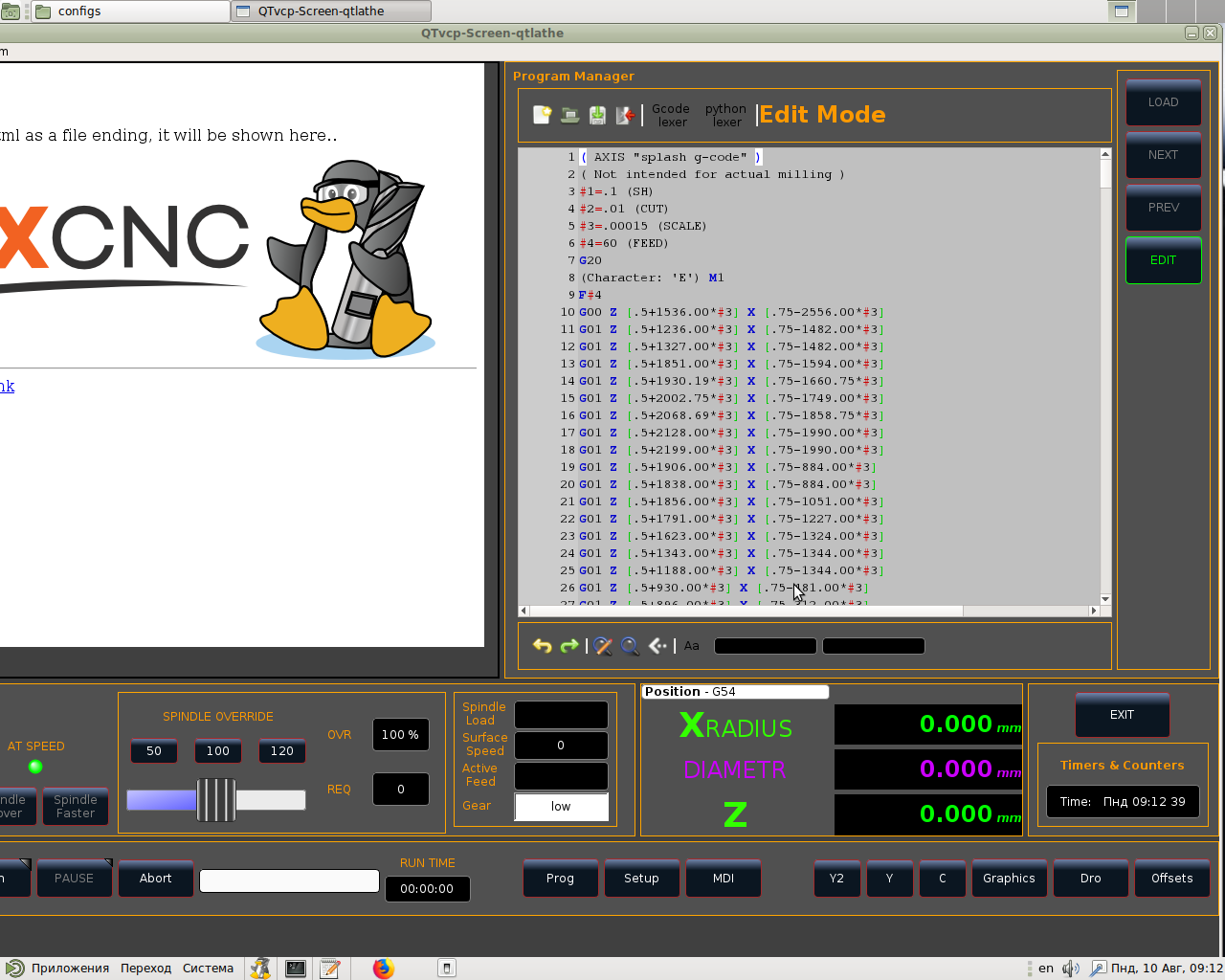

I missed the edit mode
I was thinking it would be nice to for the user to make a setup page if there was not one included.
I experimented with an editable HTML page - it seemed to have promise.
It would be nice if it could scan the gcode and collect the tool numbers then pre fill data from the tooltable into the setup page.
Then a section for notes.
But I haven't written HTML code much so will need to learn a bit.
Chris
Chris

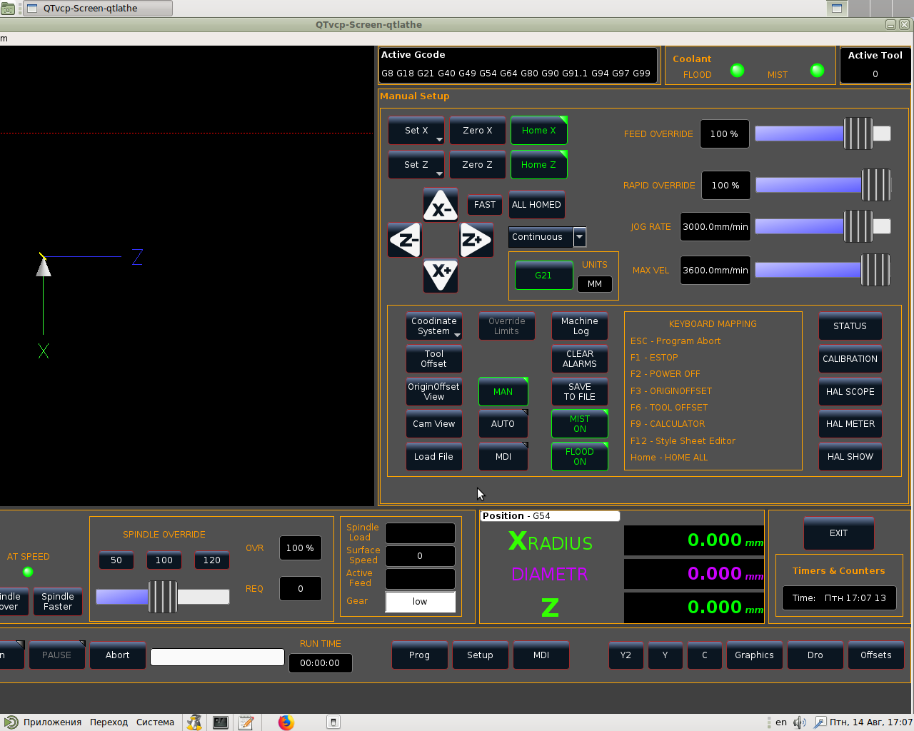

14 Aug 2020 09:13 #178186
by hottabich
Replied by hottabich on topic Qtlathe
There is no man-mode rendering in your version of the interface. Why don't you like my version?
- Posts: 7368
- Thank you received: 2181
14 Aug 2020 11:34 #178197
Replied by cmorley on topic Qtlathe
There is a man button on the latest version.
It's not that I don't like your version.
It's a bit of a pain to convert it each time to be in the installed location.
Mostly the image files need to be fixed.
It's usually easier to add your changes to the existing screen.
There are a few choices you make that I wouldn't be nothing I feel strongly about.
Your screen gets better and better - Don't stop!
Chris

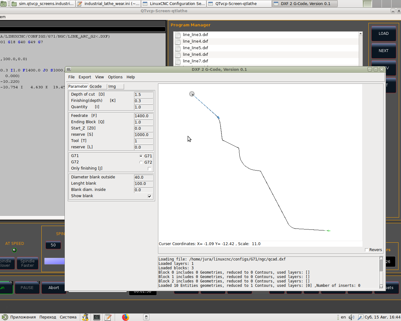

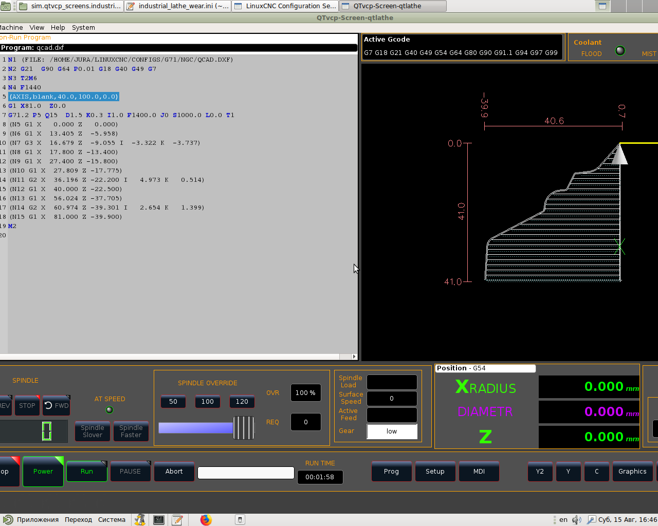

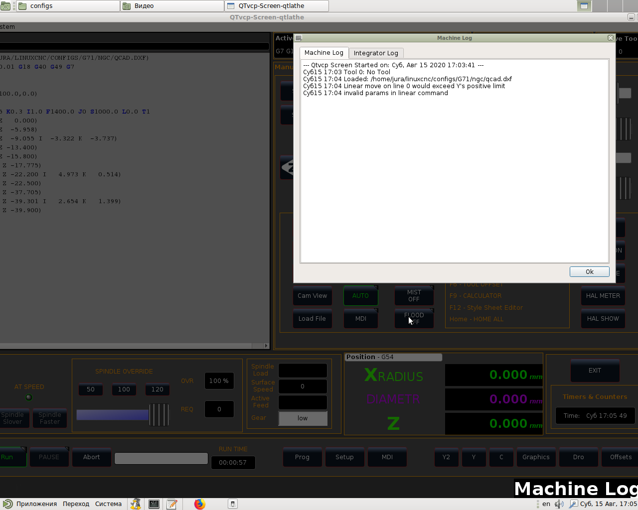

In home/dev(name)/linuxcnc/configs unarhive G71 and sim.qtvcp..... . Start G71 open file dxf of G71/ngc export
ngc run - see error. To see the patron you need AXIS blank rename qtlathe blank. On my computer there is no open GL that's why I can't see it works or not. I don’t know how to arrange it with a widget as in the video.
Last edit: 15 Aug 2020 09:59 by hottabich.

I am concerned about the G71 etc routines - are they open sourced?
I don't want to pull in copyrighted code.
I have pushed work on lathe macros that should fix them for imperial/metric entry.
And they now use the calculator widget.
they need to be tested of course - for instance chamfer seemed weird in simulation.
i have not dived into the graphics openGL code yet.
I adjusted how the graphics button works - it was annoying me when doing the macro work testing.
I pushed the work but only into 2.8 - there are merge conflicts i can't figure out to get it to master.
Chris
