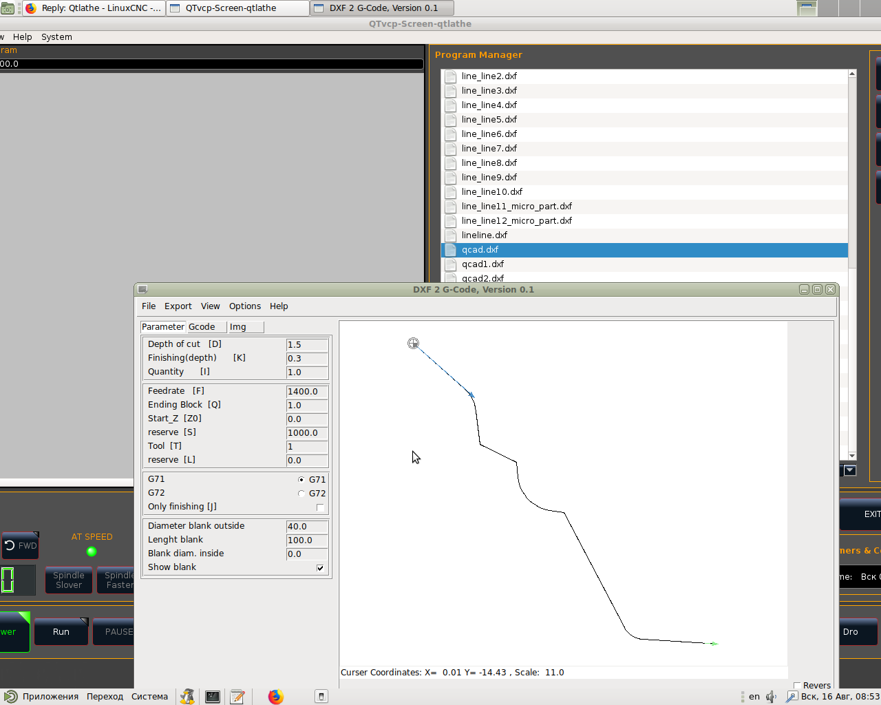

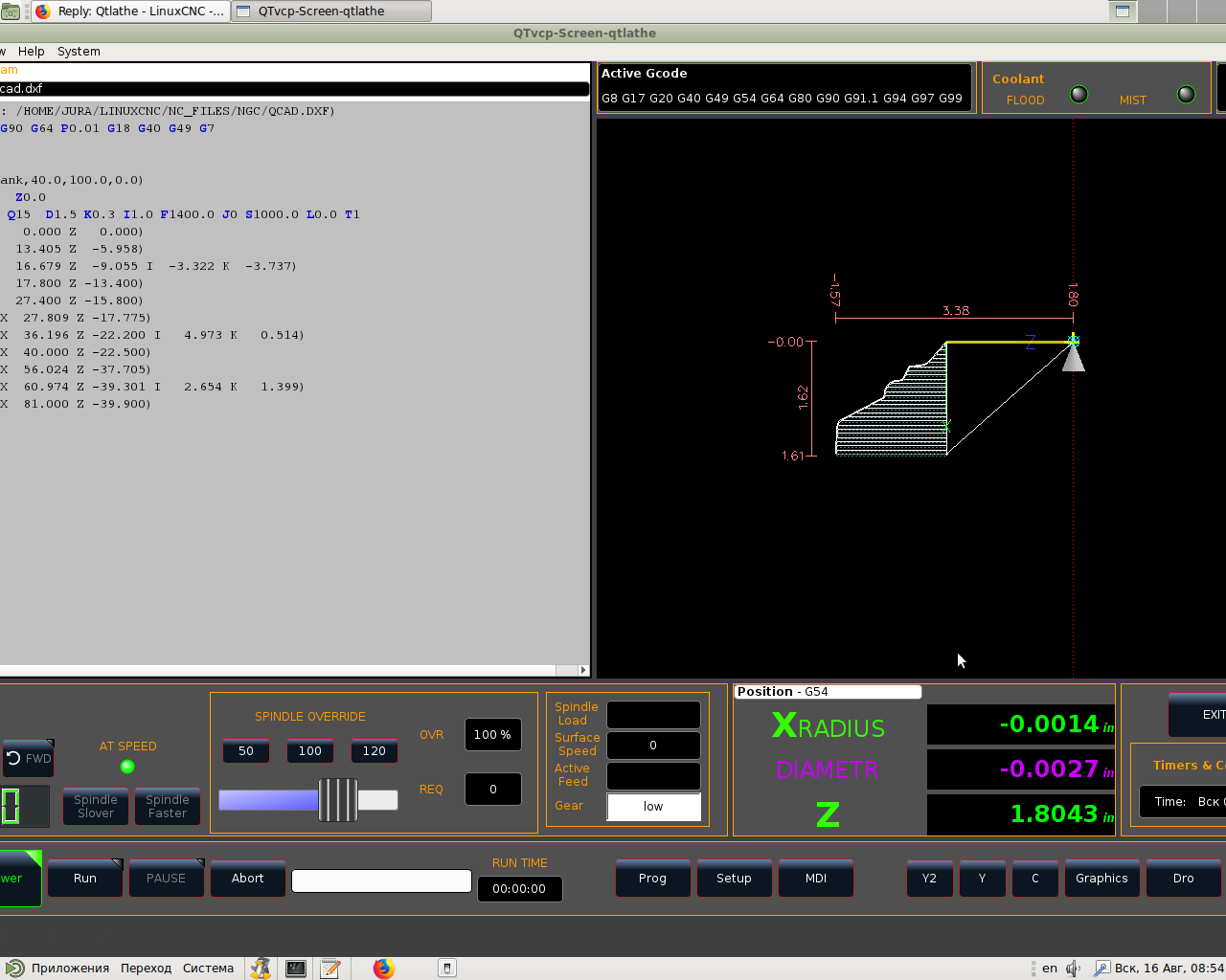

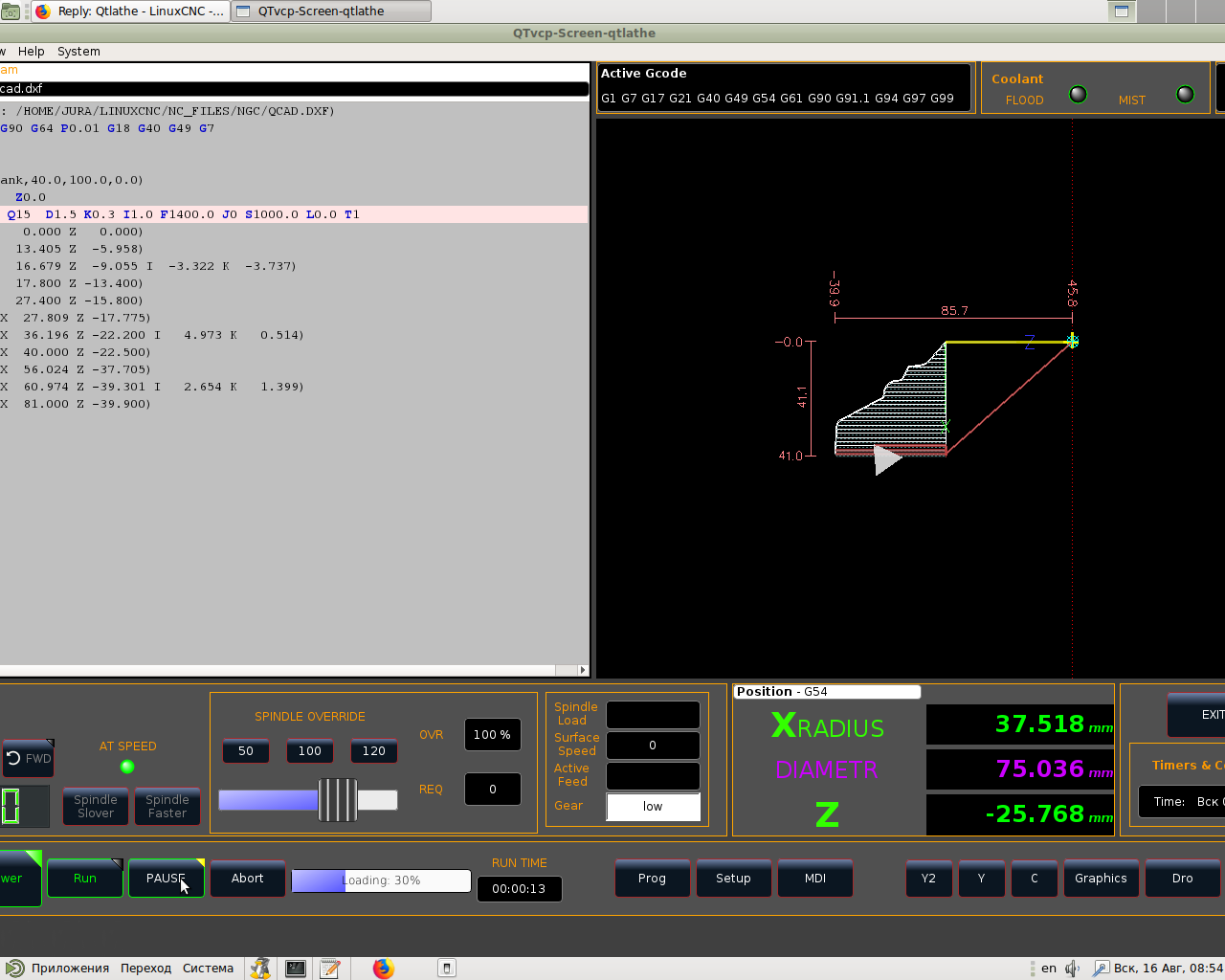

That's how it works without the G71. Just received. Ngc file example.
Sorry, the file is not complete. Updated, please download the new one.

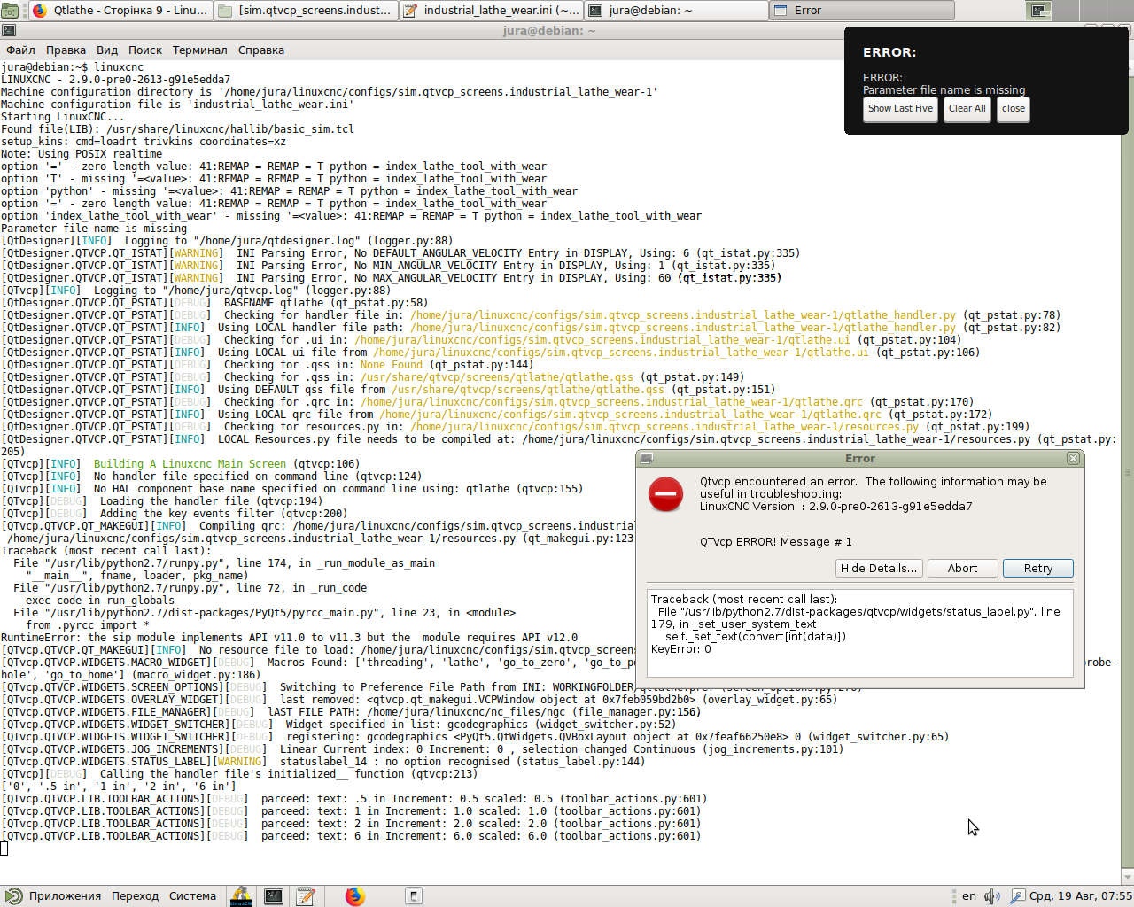

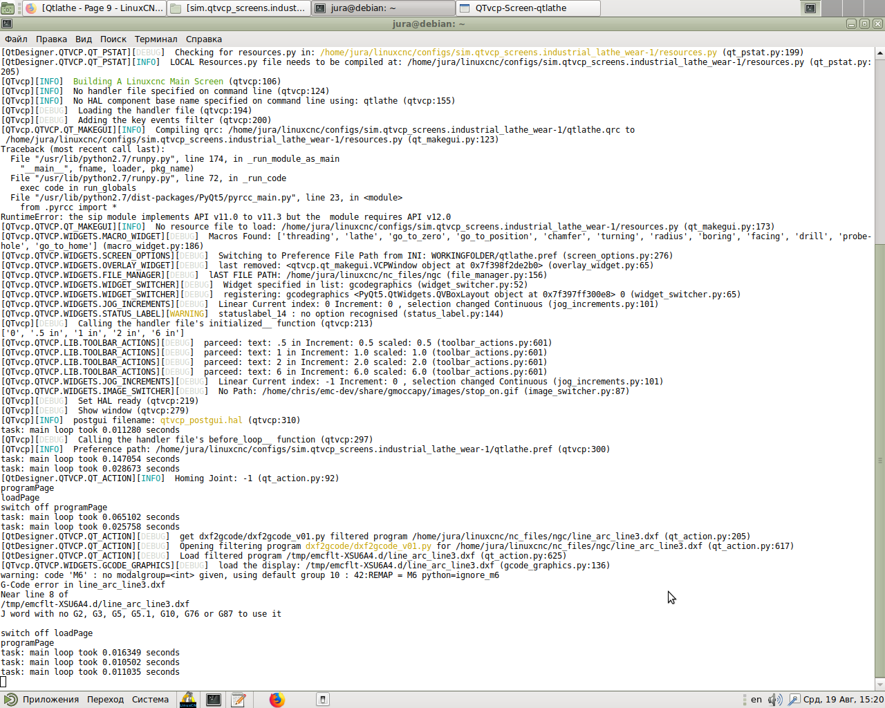

Linuxcnc 2.9 pre. There is no visualization after your revision ngc file mit dxf2gcode_v01.

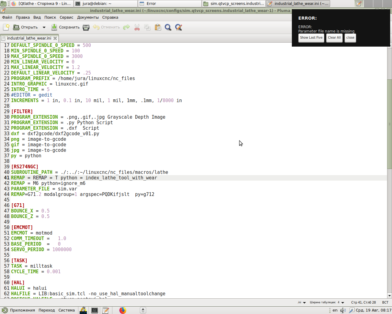

Replied by cmorley on topic Qtlathe
I'm not seeing the problem here.
Try fixing this line in your INI:
REMAP = REMAP=T python=index_lathe_tool_with_wear

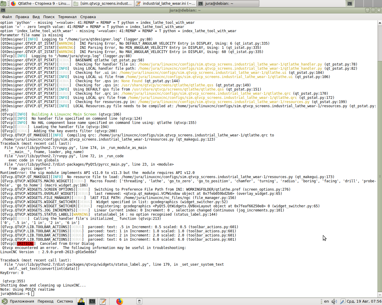

19 Aug 2020 00:35 #178672
by hottabich
Replied by hottabich on topic Qtlathe
Thanks, but it doesn't even start.

19 Aug 2020 01:15 #178676
the line should be :

19 Aug 2020 07:25 #178704
by hottabich
Such a mistake.

please change:
[PYTHON]
LOG_LEVEL = 100
Then see if anymore hints are printed.
[PYTHON]
LOG_LEVEL = 100

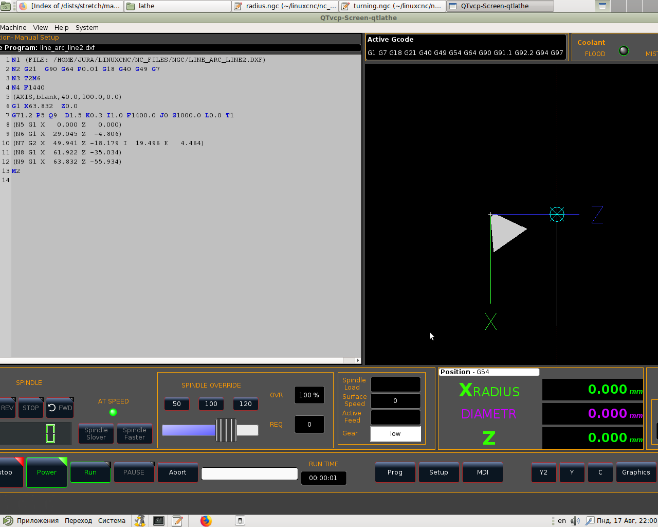

19 Aug 2020 22:28 #178791
by phillc54
Replied by phillc54 on topic Qtlathe

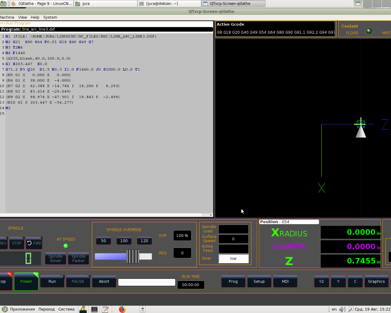

Line 7 of your gcode doesn't look correct.
