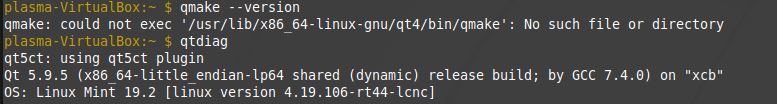

So, tried the install script, still shows 5.9.5.
Then I tried: sudo apt-get remove python3
Then I ran the install script again. Still shows 5.9.5
Anything else I can try, or am I SOL? Also, do we think this is the issue?
05 Mar 2021 01:56 #201073 by cmorley
Replied by cmorley on topic Inconsistent Error Messages
in a terminal try one/both of these:
qmake --version
(check the first line of this)
qtdiag
That will give the qt version you need for designer.
You don;t need to remove python3 - you needed to removethe python3 plugin for designer. (which is found in /usr/lib/x86_64-linux-gnu/qt5/plugins/designer/)

05 Mar 2021 02:22 #201075 by snowgoer540
Replied by snowgoer540 on topic Inconsistent Error Messages
qmake --version
qtdiag
Results:
Well crap. What will that mess up now that I did that?
I'm a bit out of my element here with this side of the biz.

05 Mar 2021 02:45 #201078 by cmorley
Pretty much.
Qt 5.9 is the library you needed.
You just needed to remove the python3 plugin.
