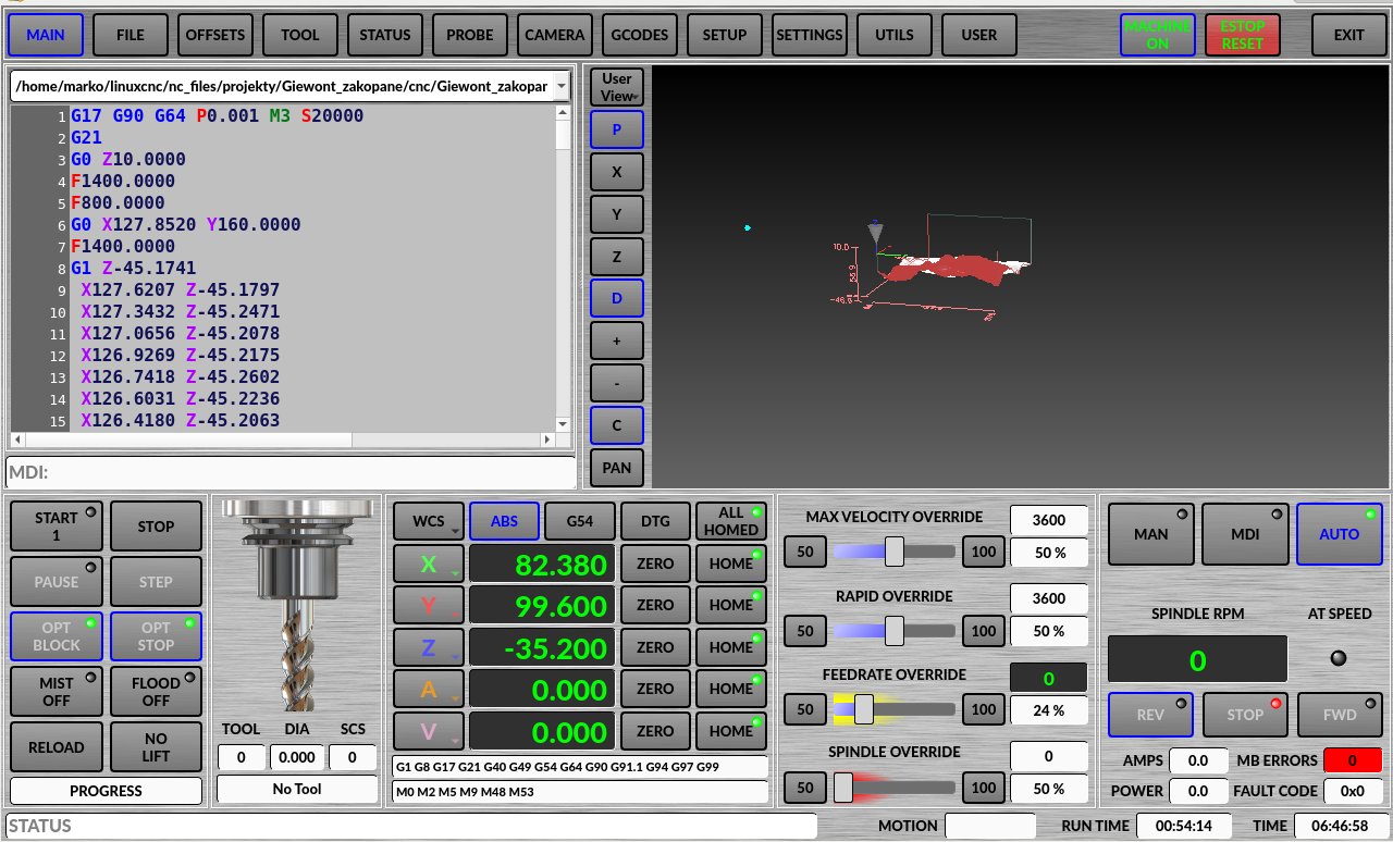

17 May 2024 16:46 #300845
by MarkoPolo
Replied by MarkoPolo on topic Error in tool_offsetview.py
I have corrected the "brushed_metal_color" style file
Set new gcode style, status warning colors, slider warning colors, fonts...

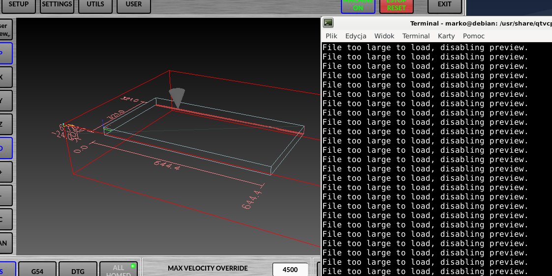

Another thing that seems to make no sense is the limitation of previewing to files that are 20MB in size. (In axis there is no limit)
To load my file, I doubled the file size in glcanon.py, like this: " self.max_file_size = min(system_memory_gb, 20) * 1024 * 1024 * 2".
The file loading time with and without preview is identical. There is no difference in moving, rotating or enlarging the preview.
- Posts: 7368
- Thank you received: 2181
23 May 2024 03:12 #301178
Replied by cmorley on topic Error in tool_offsetview.py
Curious - AXIS uses the same code.
Could you add some prints to the code and see if system_memory_bytes get set differently on AXIS vrs QtDragon?
- MarkoPolo
- Posts: 319
- Thank you received: 90
23 May 2024 06:59 #301181
by MarkoPolo
ah, ok. You're right, there is no preview in axis either. (first I doubled the value in glcanon.py and then checked in axis)
