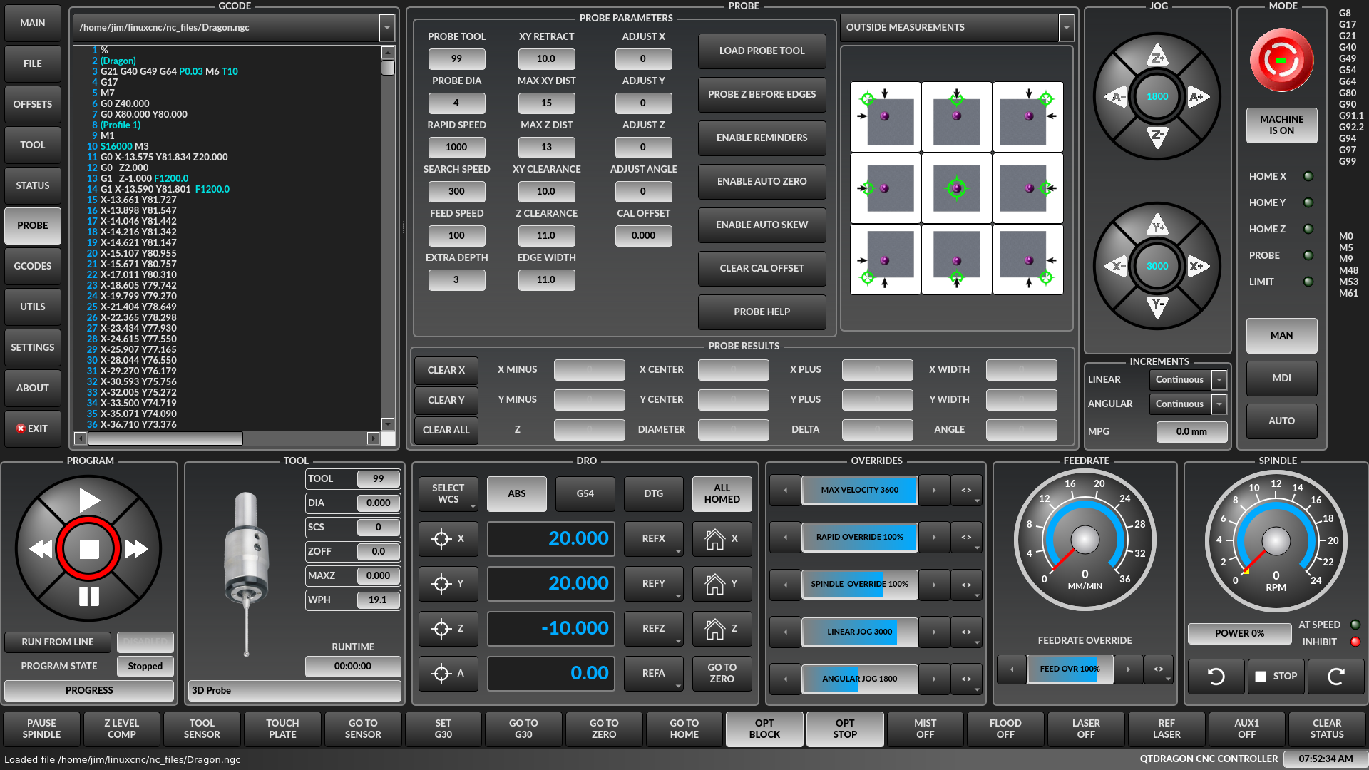

So getting back to the thread topic, I've attached an image of how I have the basic probe screen now. A couple requests for opinions:
- would it be useful to have a popup dialog reminding the user to jog to the correct start point before probing? It might get old after the 400th time so there's a button to turn it off. BTW, the start point is indicated by the purple dots and the green targets are where the probe tip will be after probing.
- is there a big advantage in using G38.4 as opposed to setting the retract distance small, like 1 mm? Should it be optional?
- other suggestions?
The greyed out button is CLEAR CAL OFFSET and is only enabled when in the calibration routines tab. All parameters are stored in the qtdragon.pref file.
Note that this qtdragon is not the one in the current linuxcnc repo.
Jim
Jim
