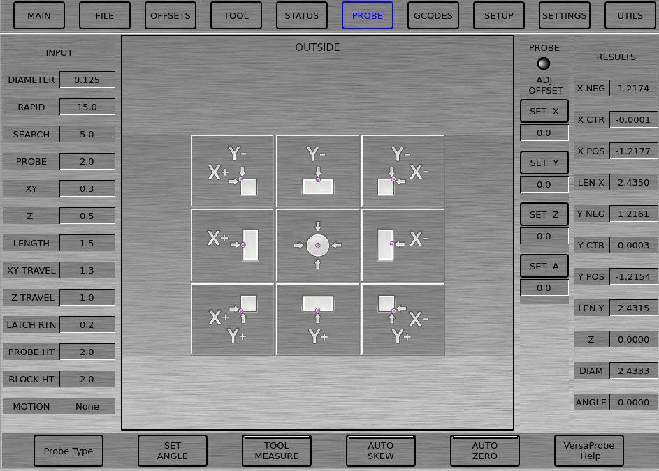

13 May 2023 17:10 - 13 May 2023 17:11 #271294 by Roguish
Replied by Roguish on topic qtdragon - probing issues
Chris,
well, updated.  testing
a couple of small things.
for the 'Outside Boss'  (center pick on the Outside page)  the X Neg and X Pos results are backwards, as are the Y Neg and Ypos.
I think the assignments in probe_routine.py (line 658, etc) are backwards.  see the image attached.
also the move from the -x probe completion over to the +x probe is too big.
        # move X+ 2 * (edge_length + xy_clearance)
        aa = 2 * (self.data_side_edge_length + self.data_xy_clearance)
        s = """G91
        G1 F%s X%f
aa = 2*(1.5 +.3) ==3.6
it should be the -x radius just determined (xpres) + edge_length + xy_clearance
aa= 1.2174 + 1.5 +.3 == 3.0174
remember going out it moved (edge_length + xy clearance) = 1.5 +.3 = 1.8
so essentially ya just go back to the center and then out the same as the first out.
and the same goes for the Y probing.
Just my opinion.
The inside-pocket works fine.....
Last edit: 13 May 2023 17:11 by Roguish. Reason: clarification
13 May 2023 17:33 #271302 by cmorley
Replied by cmorley on topic qtdragon - probing issues
Thanks for testing.
Sounds like the similar problem with hole probing.
maybe this (have to account for latch return distance that is already moved:
(2 *self.data_side_edge_length) + latch_return + self.data_xy_clearance)
I'll look at those result calculations.
