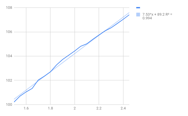

Replied by rodw on topic Rods "Spaceship" Scratch built Plasma Cutter build
Skunkworks, thanks, when you first spoke of this, it did not make sense to me and now it does. I know exactly the relationship between volts and torch height based on a regression analysis of 9000 readings.
So its 7.53 volts per mm with 99.4% confidence!
Thanks to everyone else for feedback. I really feel that LinuxCNC is going to catch up in the plasma cutting stakes.
Tommy, the best bet is to compile the dgarr/external_offsets branch and make play with the the Axis/external/offsets/hpid sim.
Then when you are ready, follow the instructions to make a live config. which won't take long. Just copy over known good ini file parameters as most of it will be done for you. You might need to unlink some default signals to use your own. There are also many useful tuning windows with the sim so retain as many as them as you can when making your live config. In the plasma section, I do have a nice component to parse the thcad 10 calibration but it not hard to do.

18 Jul 2018 20:55 #114491
by skunkworks
After a bunch of searching online - I found a few references to .004/volt. (what I have been using) And I think that falls pretty close to what you are finding...
Replied by skunkworks on topic Rods "Spaceship" Scratch built Plasma Cutter build
