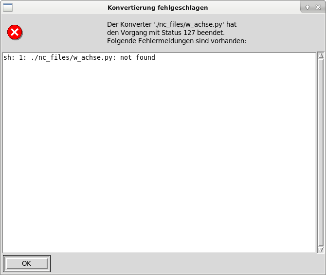

26 Jun 2022 12:37 - 26 Jun 2022 12:41 #245915
by mgm
Replied by mgm on topic Preparation for the self-construction of a carousel changer
I am at a loss, I just can't get the file to be pasted!
I am too stupid!
I have the filter program in the directory:
nc_files/
The filename of the program is:
w_achse.py
The content of the file is above!
If I now start LCNC I get the error: the file can not be found!
This is the entry of the ini:
I am too stupid!
nc_files/
w_achse.py
[FILTER]
PROGRAM_EXTENSION = .nc,.tap,.ngc G-Code File
png = image-to-gcode
gif = image-to-gcode
jpg = image-to-gcode
py = python
ngc = ./nc_files/w_achse.py
[RS274NGC]
PARAMETER_FILE = linuxcnc.var
SUBROUTINE_PATH = ../../nc_files/ngcgui_lib:../../nc_files/ngcgui_lib/utilitysubs
USER_M_PATH = ../../nc_files/ngcgui_lib/mfiles
How to do it right?
In which directory must w-axis.py be located?
Is the file header correct?Attachments:

- Posts: 22002
- Thank you received: 7488
26 Jun 2022 12:58 #245917
Replied by tommylight on topic Preparation for the self-construction of a carousel changer
Check the file permissions and make sure it is executable.
- phillc54
- Posts: 5711
- Thank you received: 2100
26 Jun 2022 13:10 - 26 Jun 2022 13:10 #245919
by phillc54
Replied by phillc54 on topic Preparation for the self-construction of a carousel changer
Also check the file path, it could possibly be: ../../nc_files/w_achse.py
Last edit: 26 Jun 2022 13:10 by phillc54.
- mgm
- Posts: 210
- Thank you received: 13
26 Jun 2022 13:33 - 26 Jun 2022 13:34 #245921
by mgm
Thanks Phillip that was it
the correct path is: ../../nc_files/w_axis.py
You made my day!
You made my day!
Last edit: 26 Jun 2022 13:34 by mgm.
