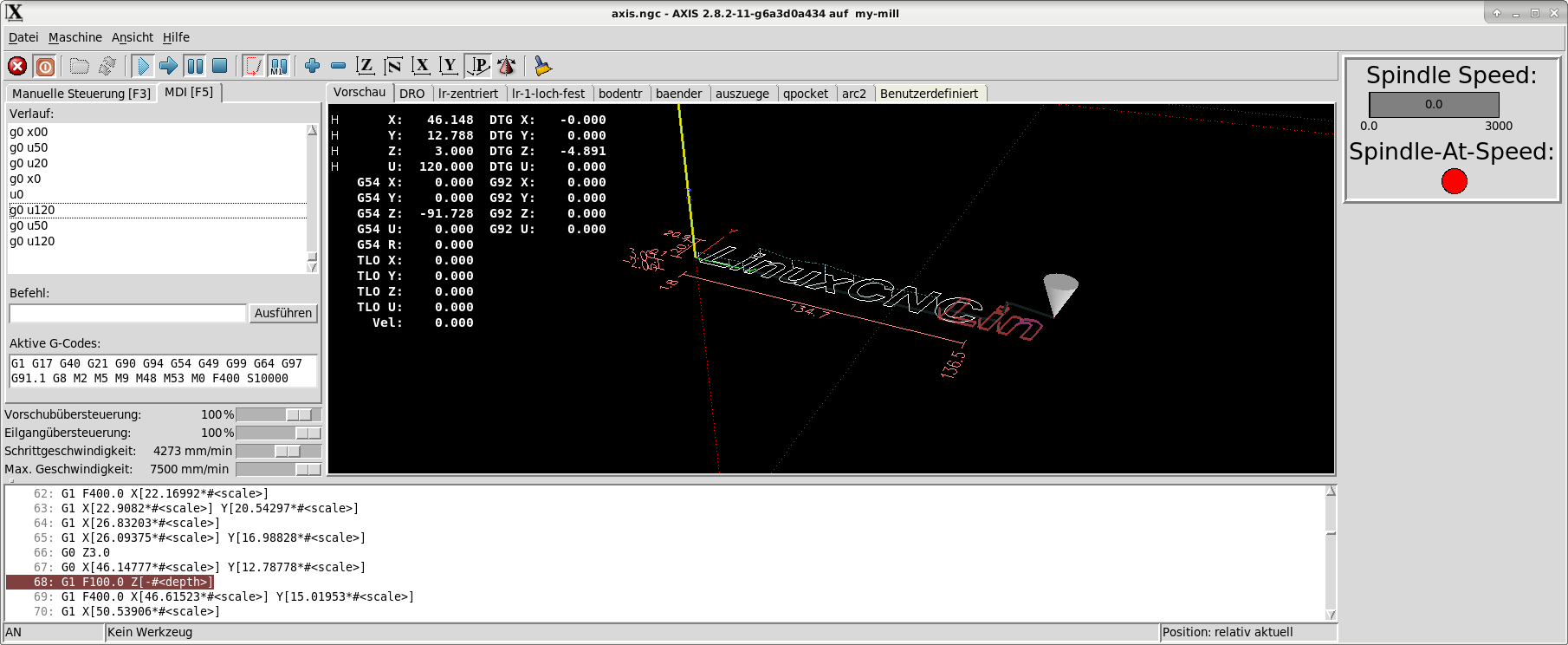

I have added an additional "U" axis to my sim, as Joint 4.
I can also bring the U axis home.
When I move it, nothing changes in the preview at U, only DTG counts down the path. The preview moves the travel of the X axis!
I hope I could express myself understandably!
I think that is not what I want.
I want to have an independent axis, which has nothing to do with the X axis! only that it moves in the same plane, it should move the changer.

Replied by andypugh on topic Preparation for the self-construction of a carousel changer
The preview shows the XYZ point. I don't see how it could show a UVW point. Moving X might be some sort of "best guess" that the preview is doing.
What is your GEOMETRY in the INI?

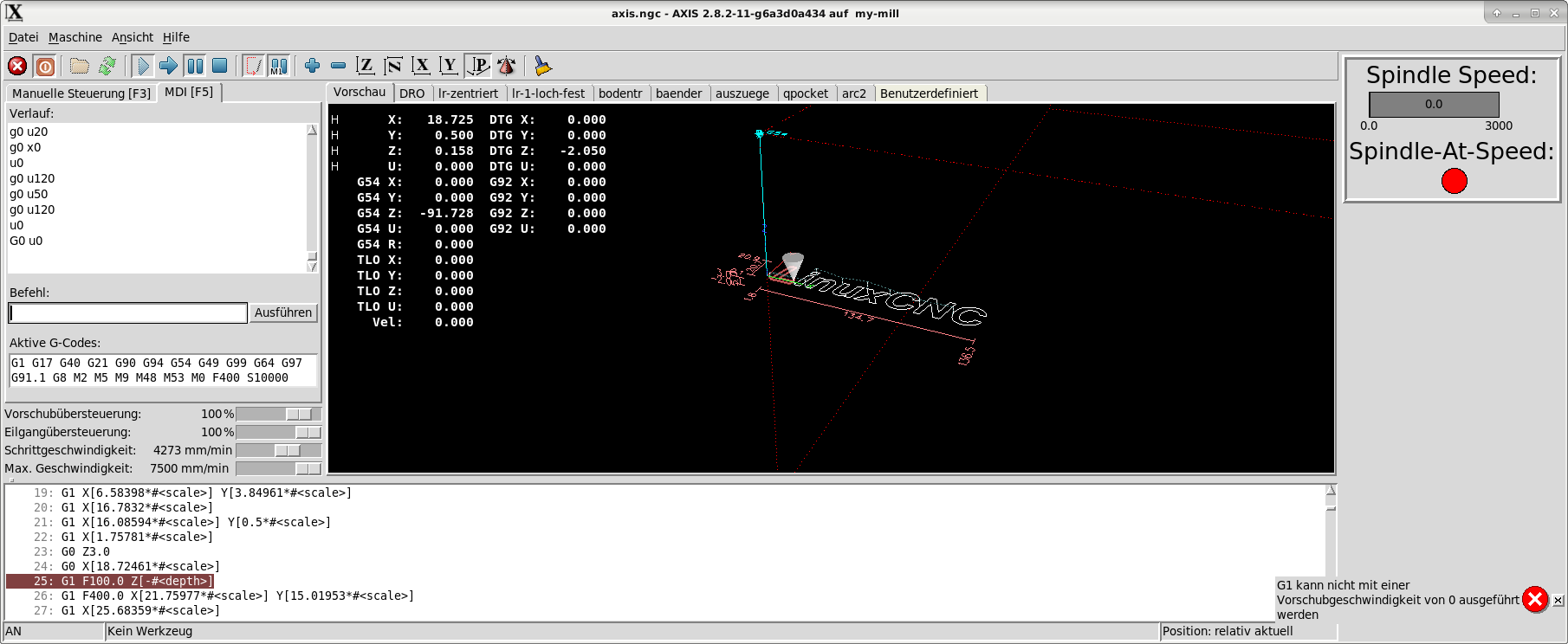

26 Jun 2022 11:22 #245933
by mgm
Replied by mgm on topic Preparation for the self-construction of a carousel changer
When I move the U axis I always get the error "joint 4 following error".
no matter what I set in the ini!

26 Jun 2022 11:24 #245934
by mgm
Geometry is:
KINEMATICS = trivkins coordinates=XYZYU kinstype=BOTH

27 Jun 2022 05:56 - 27 Jun 2022 05:57 #245989
GEOMETRY is in the [DISPLAY] section and controls how the preview displays the G-code. If you don't mention U in there then I would expect X to stop moving on U moves.
If your U axis has following errors then it's probably a problem in the HAL.
The system compares motor-position-cmd and motor-position-fb pins for each joint, and if they are different then it flags the error.
Did you copy the HAL sections too, when you added U?

- Posts: 19908
- Thank you received: 4656
28 Jun 2022 04:03 #246064
How much of a problem is this extra movement? Presumably the preview returns to normal when the toolchanger retracts?
I have had a look through the code where I was expecting to see X and U being summed (glcanon.py) but haven't managed to spot it.

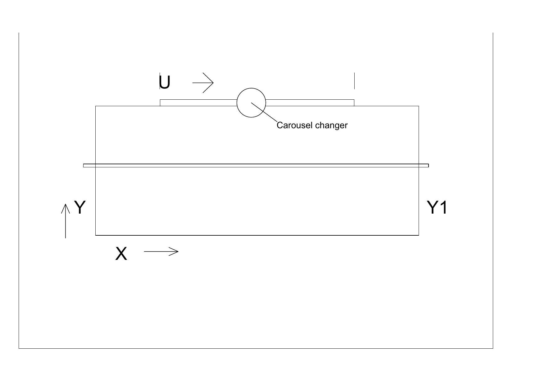

by mgm
I have made a sketch so that I can better explain my project.
I have a portal milling machine with X YY Z
I want to be able to move the carousel changer on an axis parallel to X!
In the sketch as axis U drawn.
It is not necessary that the U axis moves back to 0.
Is there another possibility to integrate an independent axis which I can move with a G-code command?
It does not have to be displayed visually!
