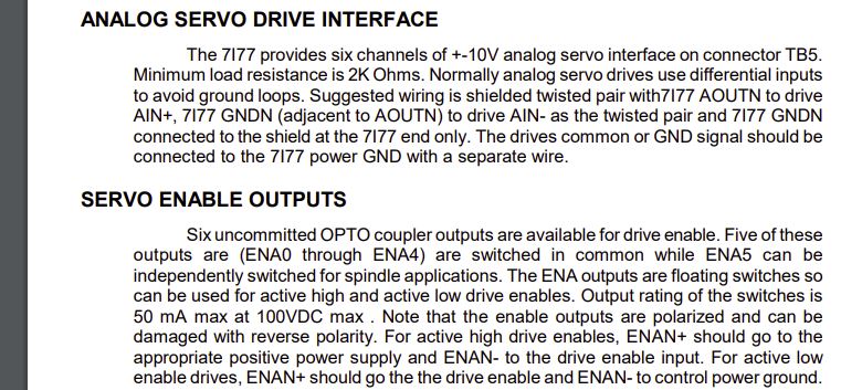

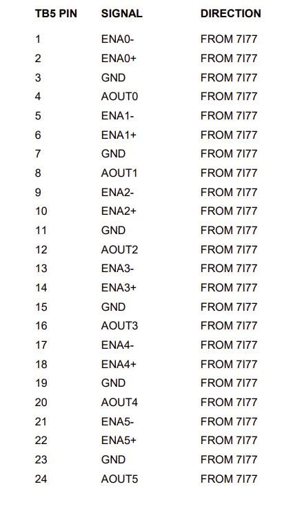

06 Oct 2020 18:49 #185170
by _big_
Replied by _big_ on topic Hurco KMB-IS CNC update
Mesa 7i77 documentation error? I'm looking at version v1.20 which I downloaded from: www.mesanet.com/pdf/parallel/7i77man.pdf
I think the ENs and AOUTs need to be swapped in the pin list.
A pretty obvious problem??? Googling didn't find a problem report.
- Posts: 18119
- Thank you received: 5337
06 Oct 2020 19:20 #185173
Replied by PCW on topic Hurco KMB-IS CNC update
The manual pinout is correct
TB5 pin1 (bottom pin) is ENA0-
