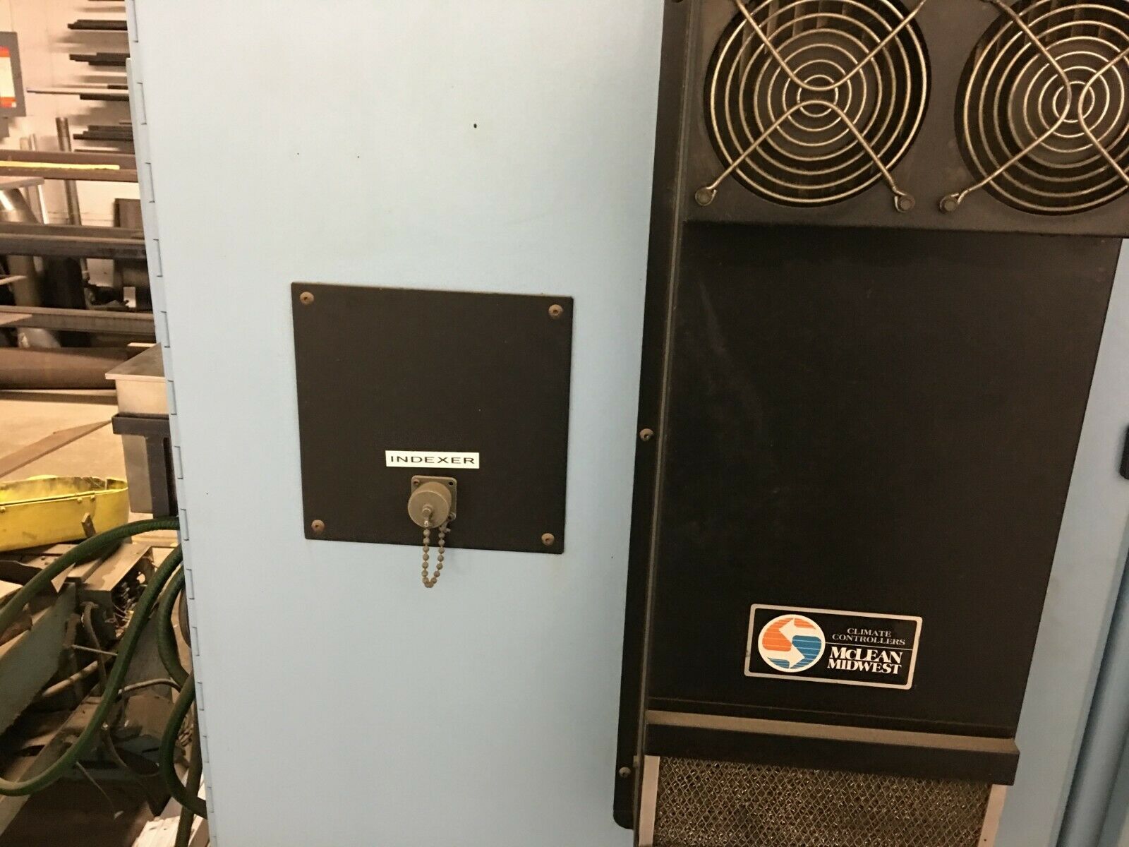

29 Aug 2020 19:21 #179959
by CORBETT
Leith,
Happen to see this on the rear of a Hurco BMC 20... which they are a later model than our time period (late 80's-early 90's). It had the dual screen Ultimax II control. Personally I think they took it off the previous machine and added it to this one... the Amphenol looks old and is missing one bolt.... Most likely to re-use the indexer from the previous machine. Plus this had a DB9 connector at a different location for DNC. I am sure it was a previous Hurco machine to re-use the Amphenol connector, as our Hyperdex indexer was wired for Monarch VMC's and it could be moved between our three VMC's, but not work with anything else we had (Cincinnati Milacron, Bridgeport, etc..) without re-wiring..
Replied by CORBETT on topic Hurco KMB-IS CNC update
Leith,

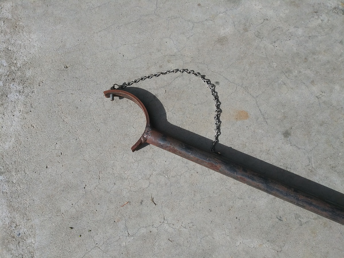

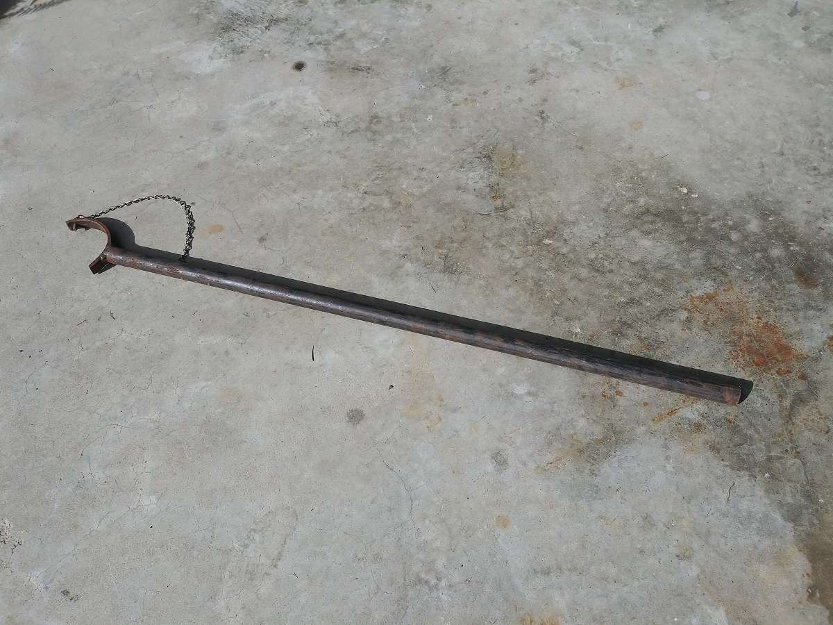

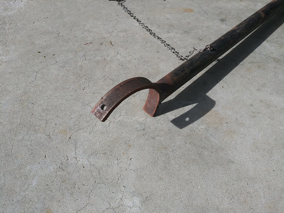

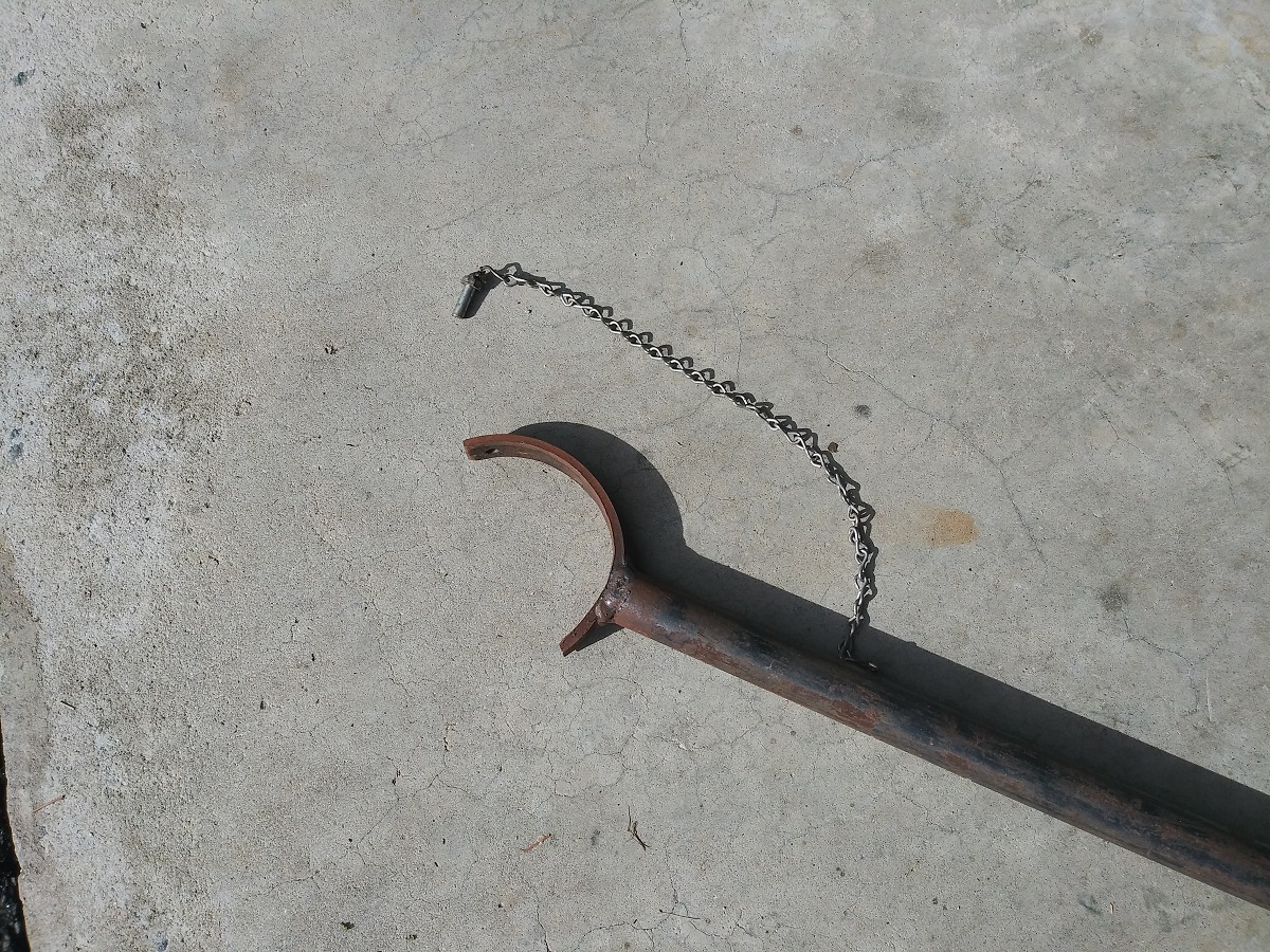

29 Aug 2020 22:26 - 29 Aug 2020 22:27 #179977
by CORBETT
Leith,
Me and my Dad built this years ago for our larger excavator. We needed to repack one of the large hydraulic cylinders and this was the quick and dirty spanner wrench we made. You can make the same concept for your kwik switch spindle to get by until finding a good one at a cheap price.
This one is pretty big as it is 5' long and has a 4-1/2" spanner on the end. The handle is 1" pipe and the spanner is nothing more than 4" pipe cut about 1-1/2" long for width and then we split the piece to what you see welded to the 1" handle. Then drilled a 3/8" hole, then cut off a 3/8" shoulder bolt to fit down in making the pin. You could weld the pin in... we had to put ours in after spanner was put in place is why it is removable.
Just a idea to get by....
Leith,
Last edit: 29 Aug 2020 22:27 by CORBETT. Reason: spelling

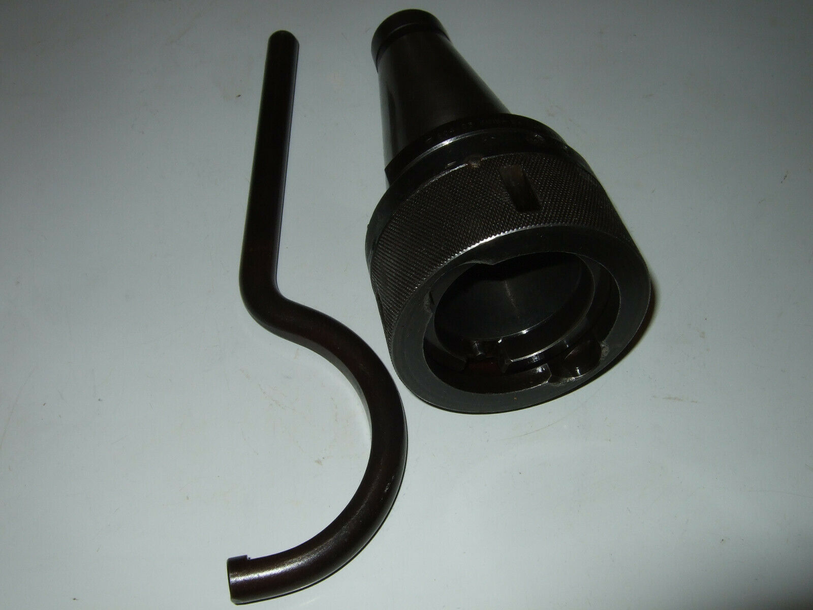

31 Aug 2020 15:27 #180180
by _big_
Replied by _big_ on topic Hurco KMB-IS CNC update
Hi Robert,
I think we've got a kwik switch spindle wrench solution. Thanks for the pics.
And, we've got a line on a couple servo motors on Ebay. Most of them are the -049 suffix and we need the -089 suffix. Hopefully we can get them for a low price and then we'll find out if they work.

01 Sep 2020 01:28 #180248
by CORBETT
Leith,
I have been out of town all day and just got back... haven't had a chance to check in until now.
Good deal on the motors... hopefully you will get something that will work. I think really it's all about how long the shaft out the front that will matter. I am pretty sure they all have the same bolt pattern on the front of the motor...
Ok good deal on the wrench. I was thinking you still needed to do something is why I was sending pics. Was trying to give the cheap elbow grease approach LOL.
Ok I still need to try and get the parts manual taken care of for you. I have not pushed my Dad about getting everything out as he has been feeling rough for the last week. When I think he is feeling up to par I will get him to start pulling everything so I can scan the sheets. I will keep you posted about it and work on getting it done soon. Like before, if you need something specific let me know and I will start searching. Wish I had more done, but just not enough time.
Your moving along well, you have made a lot of progress figuring things out in a short period of time... you should be up and running way quicker than I was.
Robert

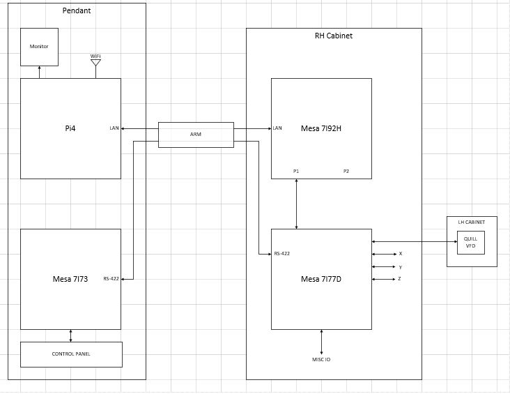

13 Sep 2020 22:51 #182041
by _big_
First pass at Pi4/Mesa block diagram for the Hurco.
The idea is to keep the Pi4 in the pendant, run CAT5 to the 7192H in the RH cabinet. This keeps the HDMI/keyboard/mouse near the operator console. CAT5 cable is relatively small and should be robust over such a short distance.
Expectation is there will be a keyboard and mouse to run the LinuxCNC. And also some set of buttons and an RPG for manual movement control.
The 7I33 is probably not absolutely necessary. Could possibly use the Pi4 GPIO. But maybe the 7I73 is more compatible with LinuxCNC. Use of the 7I73 will require another CAT5 through the arm, but that shouldn't be a problem.
I haven't found a definitive ruling on the suitability of Pi4 with LinuxCNC. I happen to have a Pi4 lying around. Will start with that and keep the option open for some x86 based computer, the Odroid-H2+ looks promising.
