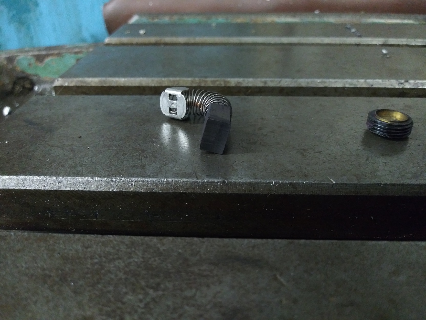

Leith,
Ok the brush end looks odd to me. There shouldn't be copper lines on there like that unless its a copper stranded brush, and even so it still looks odd or marred. I don't think they had them in these and only a carbon type like you would see in any DC motor. I may go pull one out of my motor to see what it looks like. If its regular carbon brush, I would clean the end off and see if it makes a difference. I will be heading to the shop soon and I will take a look to check what is in mine, but I think they are just the standard old type brush.... will find out soon.
Your making great progress now, going to need to oil your ways for movement soon. Does the E-stop work to shunt the amps, or did you bypass everything and fire the amps directly off the Variac? I always wanted one of those old time Variacs, thought they were cool... just crank up the voltage to whatever you want.

Replied by tommylight on topic Hurco KMB-IS CNC update
I agree with Robert, those brushes do look strange, so that warrants opening the motor and doing a thorough clean-up and check of the rotor and commutation, stator and especially the tacho generator and it's brushes.
Use very fine grit sand paper to clean the commutation on the rotor and tacho, take your time doing it as any rush will cause a lot of damage to them. Also check for discolouring on the rotor windings.

Leith,
Ok yes the brushes are just plain old carbon type. I have a picture attached from one of the motors from the 2nd machine, but same identical silver frame Electro-craft motor. I would clean them all up, as you can see in the pic it should be black. I would find a pencil or something with about the same arc and then wrap the sandpaper around it to do the cleaning. Just like Tom stated, use some fine grain sandpaper to do it with. It would be nice if this is the only issue, but I have a feeling the armature is in not so good shape with all of that copper build up.
There is another possible reason, but I don't believe this... and that is it sat for so long that it did similar to a di-electric connection and corroded some of the copper onto the brush. I doubt this is what happened, and there is probably more going on down in there. But you can at least clean everything up and see what happens. May get lucky with a lot of elbow grease.

Replied by _big_ on topic Hurco KMB-IS CNC update
I've considered opening up the motor to look at the armature. But... based on Youtube videos, they say opening the motor is tricky business and you'll probably end up destroy the motor without the benefit of special tools and knowledge.
At this point the motor is useless so opening it up is an option. Can you offer any advice before I try this?
Good feedback on the brush condition. I really don't know what they are supposed to look like. Apparently the copper streaking is not a good sign. Perhaps those copper streaks are shorting armature segments together and causing the overcurrent.
I think the next step is to carefully take fine sandpaper to the brushes and get the copper off. Pretty low risk.
If that doesn't work (and maybe even if it does) take the motor apart and look at/clean up the armature.

That is a downer as you could get a idea of how wore out it is...
I haven't taken one apart, so I can't say how it will be. I would definitely try cleaning the brushes gently, blow out the holes and then re-try the motor. But yes the smaller motors are what I would experiment with on taking apart.
Yes, like you are saying I also believe the copper on the brush is shorting between the copper lines. Just odd that the brush looks the way it does as I have never seen one have such defined lines on the brush like that. Usually just has some of the copper marred into the brush, but that one looks almost like it fused the copper on in perfect lines... just strange how it looks.
But yes, I would clean with sandpaper and blow everything out and try it before taking apart. With the thought that you may not get it back together without some type of special tool would push me down the path of trying all that I could before disassembly.
