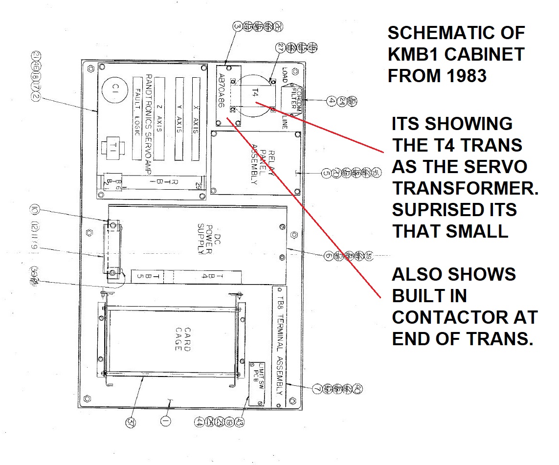

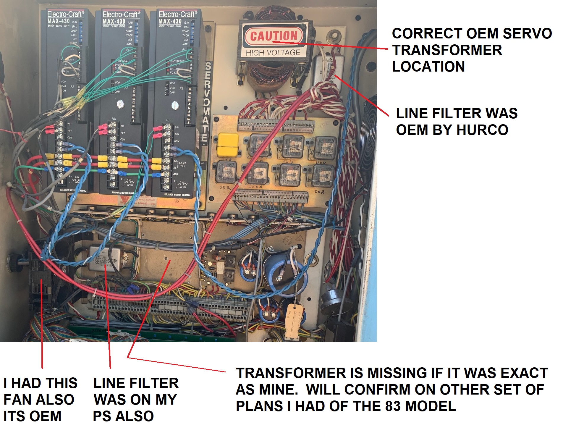

09 Aug 2020 22:50 - 09 Aug 2020 23:02 #177790
by CORBETT
Leith,
Look what I found.... looks like your layout. So yours must be around a 83 model. We were overlooking the servo transformer all along as it is much smaller for this machine. Surprised it's that small.

Leith,
I can't go any further tonight as I have to get in bed for work tomorrow, have to drive up to the middle of the state. I will be back tomorrow night, probably pretty late.
Anyway, something to look at until I can get Hurco part numbers to confirm everything.
Will be back tomorrow,
Robert
