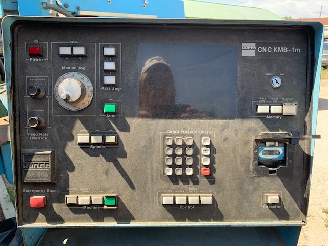

Yes the left cabinet is usually gutted and only a VFD and disconnect. I will upload a picture of the OEM cabinet and you can see what it originally looked like. Once the parajust board and the connector board above is taken out, there is nothing left but the disconnect. The cabinet looks odd so empty, but that is because the parajust board was so big.
Ok if the pendant is one screen then yes you probably do have a older model and closer to my wiring type. The newer models were pretty close, but a little different. Hurco like any other big manufacture had to keep most all of the controls and electrical pretty much the same between their own machines, because if there was a lot of crazy different designs, then it would have been a nightmare for the tech guy going out in the field and performing warranty repairs or for money service calls. Speed is the name of the game in repairs as the customer needs to be back up and running, so they tried to keep all the stuff reasonably the same to minimize parts stock and not have to get something exotic shipped in. Plus they did not need the tech guy's stopping to check manuals for different designs when they could keep one style and train the guy's for that design. Multiple styles increase chances of mistakes in the field.
On a tangent, you may want to retrieve that tape out of the drive and see if it is one of the Hurco parameter tapes. I doubt it is and probably just some program to run for a project, but if the parameter tape some guy out there may be super happy to get it. I would have been that guy 2 years ago LOL.
Ok yeah if you are not comfortable trying to run the old control then yeah go for it on retrofit, I simply wanted to tell you just in case you wanted to try and get the machine up and running quickly. I was unsure of what your time frame was and that was a option for speed.
Ok one last thing, I would completely stay away from a laptop (my opinion LOL). There are people that run laptops, but I have seen way more problems over the years of research when using a laptop. I am sure someone is going chime in and tell me I am wrong, but once again, I am all about reliability. Anytime there is a possibility that something could go wrong with the computer side and crash the machine, makes me stay on the side of reliability by using a desktop style computer. Things do change and I have not researched using LCNC with a laptop in the last few years, but years ago I know it was frowned upon.

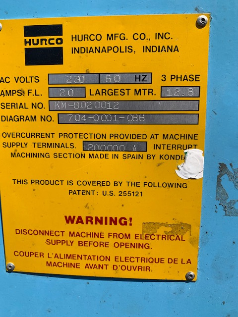

Nameplate says 220V 3 phase. Quill motor says 220440V 3 phase. Eventual landing place for machine is a shop with 440V 3 phase. Probably with the exception of the quill motor, machine ran off of a single phase of the 220V 3 phase. Biggest problem with the 440V is then stepping it down to 220V. Not a big deal though.
Looked more closely at the rear mounted transformer. Single core and hence single phase. Two input wires and two output wires. All the MAX-430 servos AC power inputs are bussed together. Probably the transformer steps a single phase of the 220V down to ~85 VAC.
Photo of the nameplate. If we had the right secret decoder ring, we could probably tell exactly when the beast was made.
