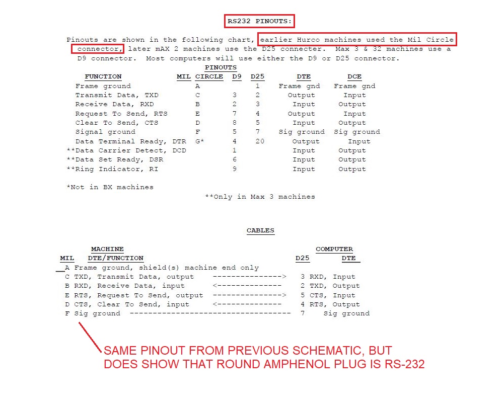

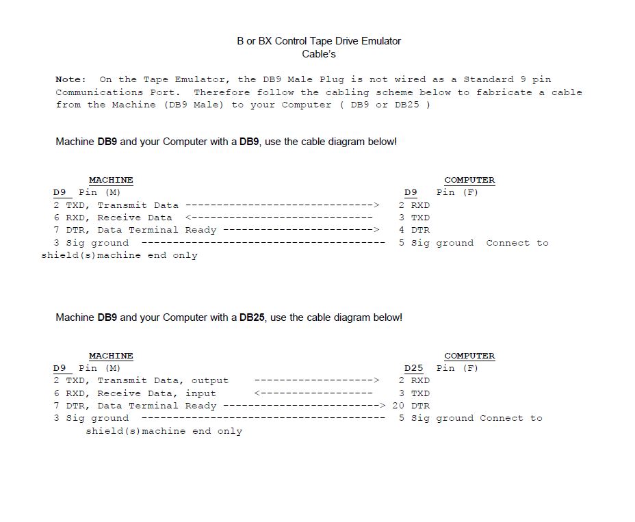

Leith,
On a tangent, just found this in one of my Hurco Ultimax manuals. Below is a pinout of a Tape Emulator that Hurco apparently had, and definitely for our control. I think this Ultimax manual is from 1994, but not sure... I got it a long time ago.
Also below that pic is another pic of the RS-232 plug out of the same Ultimax manual. So it looks like they kept continuity for all the machines with the plug wiring. They showed 4 or 5 different type of plugs in later models, but not our model.

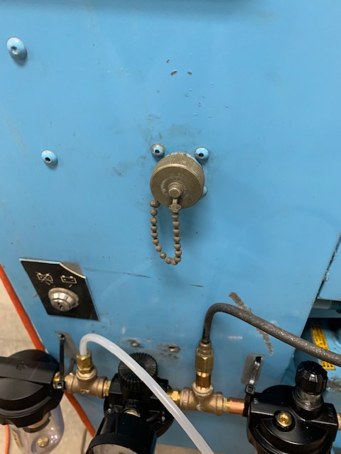

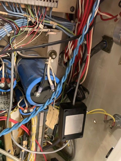

On the back of the machine, there is a single round amphenol connector.
Pretty sure it was put there by the Hurco factory because of the blue paint on the screw heads.Inside, this connector connects to an obviously home made black box. The black box has a single opto isolator, pointing out. It connected to the bottom of the relay board as previously described. KMB-1M documentation says there should be two round connectors??

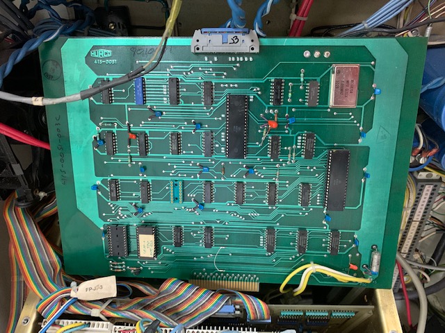

Here's a pic of the MPU board. No connector for the RS-232 busses. No UARTs on the board.
The board does have an open ROM socket. If I could wave my magic wand, I'd put the boot image there. While this is technically quite feasible, don't know if its supported or not.
