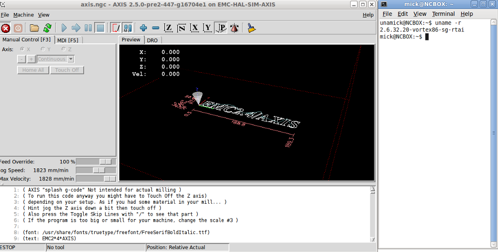

19 Jul 2012 15:51 - 19 Jul 2012 16:02 #22208 by ArcEye
Replied by ArcEye on topic Re:Tiny Computer now running Linuxcnc 2.5
And this 'proof of life' screenshot was posted from the NCBOX
Last edit: 19 Jul 2012 16:02 by ArcEye.
19 Jul 2012 20:33 #22224 by BigJohnT
Replied by BigJohnT on topic Re:Tiny Computer now running Linuxcnc 2.5
Sweet!
