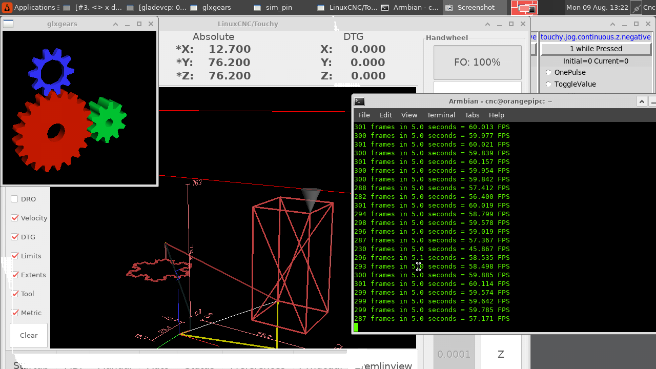

Hi Forks,
I also try to play with Touchy GUI and some addtional function.
Somehow, Gpu can only support OpenGL ES, which is not the full part of the OpenGL. So we still need to disable all the effect of Xfce.
If we olny runing Touchy, CPU usage would be less then 40%, which is similar to AXIS.
But if you also want Ngcgui, CPU usage will be up to 85%, under this condition Glxgears still runing in 60FPS.|
And so far, I diden't get any error report back.

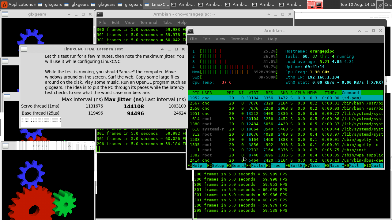

how is the servo threads latency, here I am getting high latency errors, with your previous image!
Please post the actual error and what you were running at the time, e.g. which latency test, LinuxCNC, etc.here I am getting high latency errors,
Who is "yours" and by previous do you mean the one right before the very latest or something else?with your previous image!

First of all. My Image is Clone from my SD card. I think It would only work on the board with some SOC Board which is Orange Pi PC.
If you were using other board, I think it will lead to some issue.
In that case, you will need to find the Armbian Image for you board first, But you can't use the Image newer than Armbian_21.05.1 with Linux kernel v5.10.34.
Set it up, and do the Install bash. Then do some tuning for you system.
Replied by envyvan on topic LinuxCNC + Orange Pi (allwincnc)
HI Taylorcmg,how is the servo threads latency, here I am getting high latency errors, with your previous image!

i'm at work now but once i can upload the photos, yes my card is a 1gb Orange PI PC like yours, so i used your first image to do a little test.
Bari, only the latency test is open plus no window in a few minutes the latency exceeds 100k
