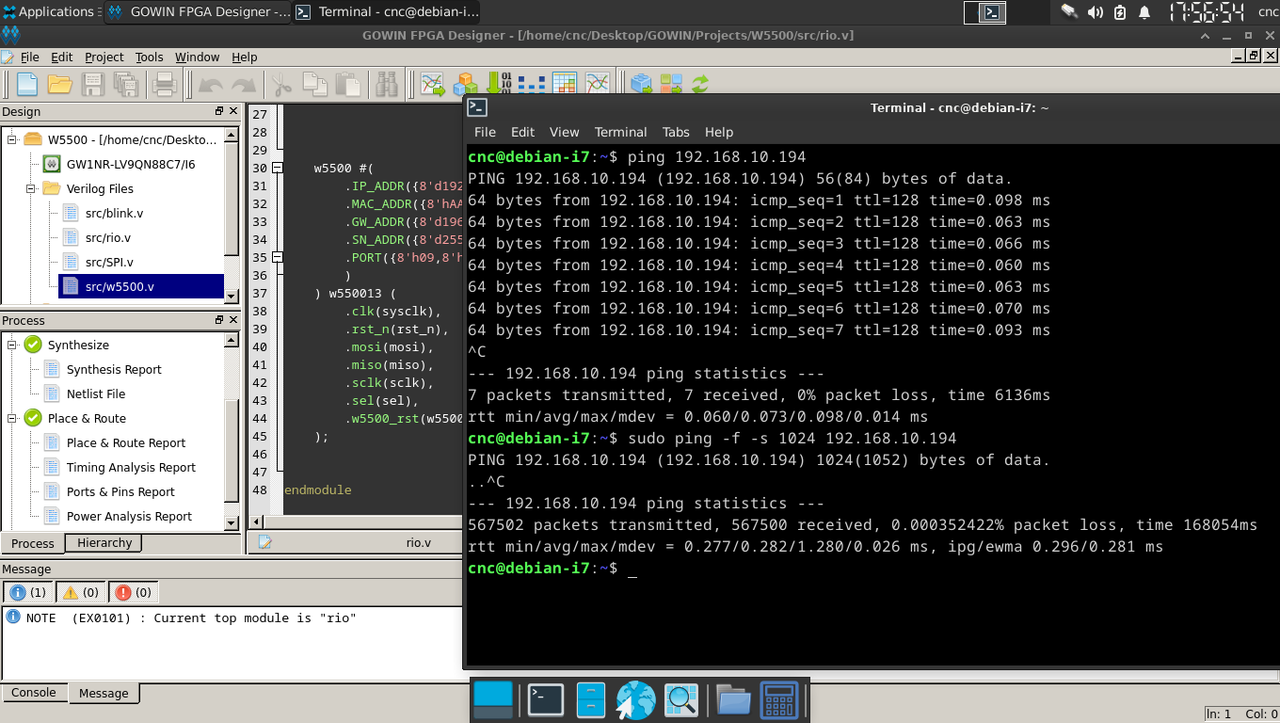

02 Aug 2024 10:21 #306714
by Mecanix
As important; For your review and consideration, Oliver. I've quickly re-wrote a w5500 UDP protocol driver featuring a robust state machine and both a soft & hard reset (set on hard rst atm - preference). The SPI is a high-performance 50meg judging from the initial tests carried (see attached Gowin project/ZIP file). Additionally, please pardon my arrogance and persistence in trying to get this w5500 badboy to work; the reasoning behind is not fueled by my potential $1.99 investment losses (lol) I assure you, but more or less by the enthusiasm of that wizzy part being as simplistic as they come - let alone a ridiculously low-cost BOM and beyond ease for hardware implementation. All good reasons if RIO is to be adopted by makers like myself (iThink).
You guessed; I wouldn't know where to begin neither would know how to implement this into RIOCore. Therefore I leave it to you to investigate that possibility (or feasibility rather).
Replied by Mecanix on topic LinuxCNC-RIO - RealtimeIO for LinuxCNC based on FPGA (ICE40 / ECP5)
Understood, thanks for the advice/heads up. I have placed an order for the WT32-ETH01 and will receive this within 36~48hrs. I'll update.i prefer the WT32-ETH01, cheap and available
