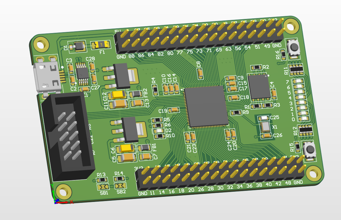

I don't know what to say, that was too kind Meister. Thank you so much for taking the time.
I'm working off a GW1N-LV9QN88 part (custom dev board). Schematic and pcb mostly inspired from the infamous TangNano9K and so I have a good feeling this won't be too difficult to port hardware-wise.
Let me set-up, clone, learn your work during the coming days. As soon as I have a successful IDE compile/project I'll share it with you to upload on your repo.
So excited about this already. Thank you again. I'll update progress!

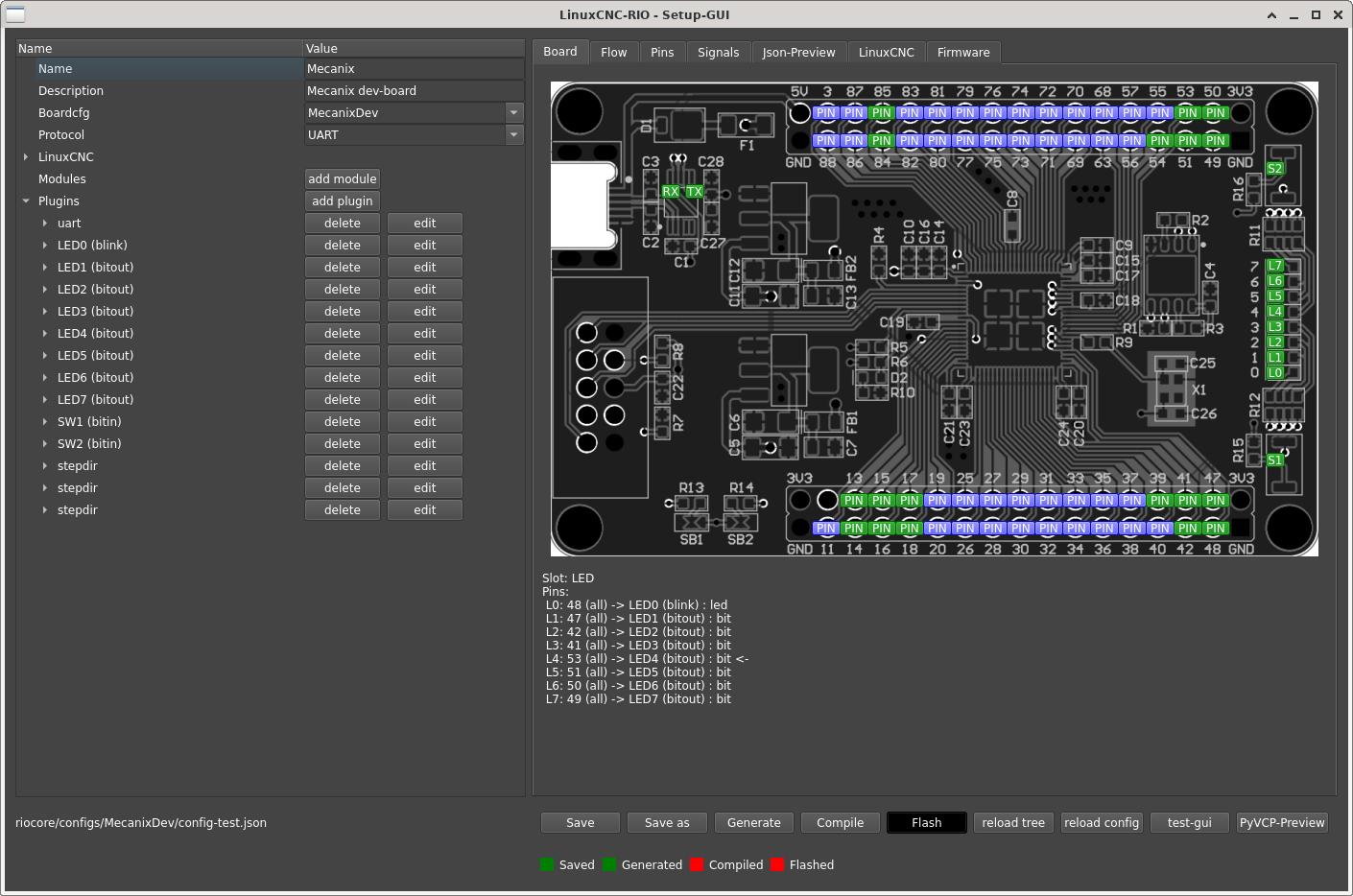

I built you a minimal config, could work like this, maybe I mixed up RX/TX, but it's a good start
odippel@odippel:/usr/src/riocore$ PYTHONPATH=. bin/rio-generator riocore/configs/TangNano9K/config-mecanix.json
loading: riocore/configs/TangNano9K/config-mecanix.json
loading board setup: TangNano9K
writing gateware to: Output/Mecanix/Gateware
!!! gateware changed: needs to be build and flash |||
loading toolchain gowin
writing linuxcnc files to: Output/Mecanix/LinuxCNC
odippel@odippel:/usr/src/riocore$ ls Output/Mecanix/Gateware/
blink.v hash_new.txt Makefile pwmmod.v rio.sdc stepdir.v uart_baud.v uart_tx.v
debouncer.v impl pins.cst rio.gprj rio.v toggle.v uart_rx.v uart.v
PYTHONPATH=. bin/rio-test riocore/configs/TangNano9K/config-mecanix.json /dev/ttyUSB0Attachments:

O M G. Wait, are you showing us that all what's missing to RIO to be fully functional is a fpga dev board and the toolchain installed? As in "screw Gowin IDE'??? If that's the case then that's a pretty serious game changer.
I have so much to learn about your solution, obviously. Excitement is getting outta control!!

31 Jul 2024 16:37 #306545
by meister
Replied by meister on topic LinuxCNC-RIO - RealtimeIO for LinuxCNC based on FPGA (ICE40 / ECP5)
I just wanted to show that it is not that difficult to support new boards.
It is a bit more complicated to create the board with a picture and the correct pin positions for the setup tool, but this is only optional.
If the toolchain is already supported, it is quite easy,
copy a similar one and adjust the values (type/clock-speed and pin).

31 Jul 2024 17:18 #306548
by Mecanix
Let me learn what you've done for yourself and all of us first. This will require time on my side, but will be worth it I have a feeling - "it works" (see visual)!! I'll update on progress and hopefully can contribute what was done at my end. Interim, let me know if you need the sources/gerber/bom/anything for the dev board in use. Better yet, let me know what else could potentially go on it to make it a "RIO-BOARD" (RTL8111H?!) and I'll see what I can do.
Replied by Mecanix on topic LinuxCNC-RIO - RealtimeIO for LinuxCNC based on FPGA (ICE40 / ECP5)
One word, Oliver; EPIC.copy a similar one and adjust the values (type/clock-speed and pin).

31 Jul 2024 17:41 #306549
by Mecanix
Explains why I couldn't find it locally lol. Let's try that again.
Stupid me... I could have cloned/checkout the 'dev' branch rather than main and use what you've done already.I'm sorry, I was a bit bored
riocore/configs/MecanixDev/config-test.json
riocore/boards/MecanixDev/board.json
