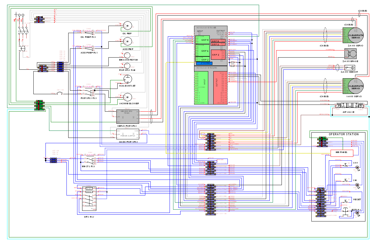

09 Jan 2022 12:55 #231245
by RotarySMP
Replied by RotarySMP on topic Schaublin 125-CNC retrofit.
After teasing it a few times, this week I really did make electrical installation progress.
The following user(s) said Thank You: arvidb, anfänger

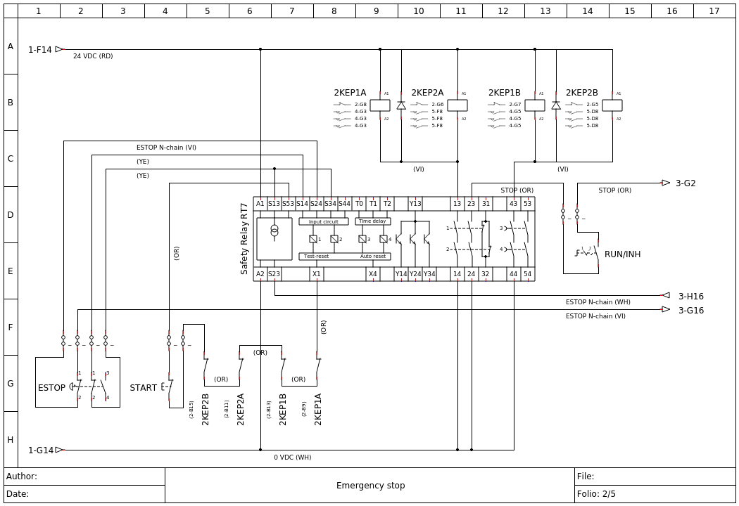

For drawing wiring diagrams,
QElectroTech
works very nicely! It lets you e.g. place contactor coils and contacts in different places/pages and then keeps track of where they are for you.
Example diagram:
Example diagram:
The following user(s) said Thank You: RotarySMP, tommylight, my1987toyota, DoWerna
- RotarySMP

Thanks. That has got to be better than doing it in Visio (Mini-lathe) or PDF writer (Changing the Maho schematics one line at a time.
I'll give that a try.
Mark

I'll have to check out QElectro Tech. Looks nice.
TinyCAD is another useful tool. Not great for ladder diagrams, but excellent for color-coded schematics. Bit of a steep learning curve designing your own symbols but once you figure it out it's easy to cook up specialized components like PLC's, drives and sensors.

Nice schematic.
I think QET is really good. Probably capable of 10x what I need, but that way you can place and snap components on the grid and auto connect then is really fast to use.
Mark
