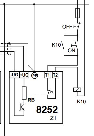

One thing I didn't notice in the vid or the thread discussion is that there is a separate manual for the braking module. It's referenced on page viii (Part G - 11) of the VFD manual.
The braking module manual shows a "T1" and "T2" connection on the module.. but those aren't shown in the main VFD manual.
Based on the diagram, I suspect those need mains power to 'activate' the braking module.
I'm sure there are some parameters to change as well, but this might be a possibility. Maybe have a look?
And yes...dogshit manuals.
- RotarySMP
- Posts: 1635
- Thank you received: 595
27 Nov 2025 16:21 #339331
by RotarySMP
Replied by RotarySMP on topic Schaublin 125-CNC retrofit.
Those are the thermal overheat switch, which with that wiring will cut power to the main VFD in the case that the brake module overheats. To test it, that connection is not necessary.

27 Nov 2025 22:00 #339350
by spumco
Are the LED's on the brake module illuminated? Green for ready, yellow for braking active? Just trying to work out if your #2 (dead component) theory is true.
Replied by spumco on topic Schaublin 125-CNC retrofit.
Makes sense now that I look at the diagram more closely.Those are the thermal overheat switch, which with that wiring will cut power to the main VFD in the case that the brake module overheats. To test it, that connection is not necessary.

Okay, I think I understand why it is doing what it does.
The brake is working, but only during a speed change. So with C13 = 0.5S, and C023 at 110% current, the spindle speed change from 70 Hz to 20 Hz is braked (nicely). So that solves my decel between CSS facing cuts.
But switching spindle off, makes the spindle coast down. Since I am commanding the VFD with analog 0-10V, I thought spindle off just meant 0V commanded, but now I think about it, I sort off remember being surprised that is not the way LinuxCNC works. I suspect the spindle stop actually deactivates the spindle drive enable signal which I have connected to VFD Pin 28, and therefore the VFD is disabled every stop.
Since I controlling the VFD with a 0-10V analog signal, what can I do to have LinuxCNC set that analog signal to 0V when I command a spindle stop?
I thought I was only only using Pin 28 it for machine start up and shut down, and E-Stop. It looks like I need to put a delay onto that disable to give the VFD time to be braked down to stop with the analog speed command, before the VFD is disabled.

28 Nov 2025 01:40 #339361
by spumco
Mark,
My spindle drive enable pin is tied to a 'machine-is-on' signal, and not to the M3/M4/M5 0-10v signal. The drive isn't disabled at M5.
Check your HAL file (and watch the VFD enable pin in halshow) to see if you've got something connected funny.

28 Nov 2025 12:42 - 28 Nov 2025 12:51 #339369
by RotarySMP
Well, we now know what I did to set the VFD into "coast down" mode. I pinned the drive enable to spindle on, and just disabled the drive to stop it. Doh! No wonder I didn't document it.
Now I know that, I have a few options.
1/ Use ladder to react to a spindle stop command with an S0, wait a second, and then disable the drive. I had the VFD set for min 20 hz, max 70 Hz, so this would only brake down to 20, and coast down from there. It has the advantage that the spindle is not sitting on an enabled drive with an analog input, which could cause rotation from EMI induced voltage.
2/ Add a 24VDC output, wire that to Pin E3, and command the VFD to brake to a stop. I would probably still add a delay and disable the drive after a couple seconds. That would seem to be the proper way.
3/ But if I am adding another relay to to get me an extra 24VDC out, I may as well add more. Then I can also wire up the electro-mechanical brake, and have both VFD braking and mechanical braking commanded. This would also give me an option to add some ladder logic to use the mechanical brake on an E-stop.
Ideally, I would add the extra outputs with a second 7i84, as I maxed out the current one due to needing one I/O bank on 5V (for the Hall sensors for homing and tool change). I ended up scavenging a few extra outputs by using the unused axis enables on the 7i85, still ran out of 24V outputs, and put in a cheap relay board to use the excess 5V outputs to control 24V loads. I have an 8 relay card floating around, and could bodge that in instead of the 4 relay card to try this all out.
I will make a video to feedback what I actually do.
