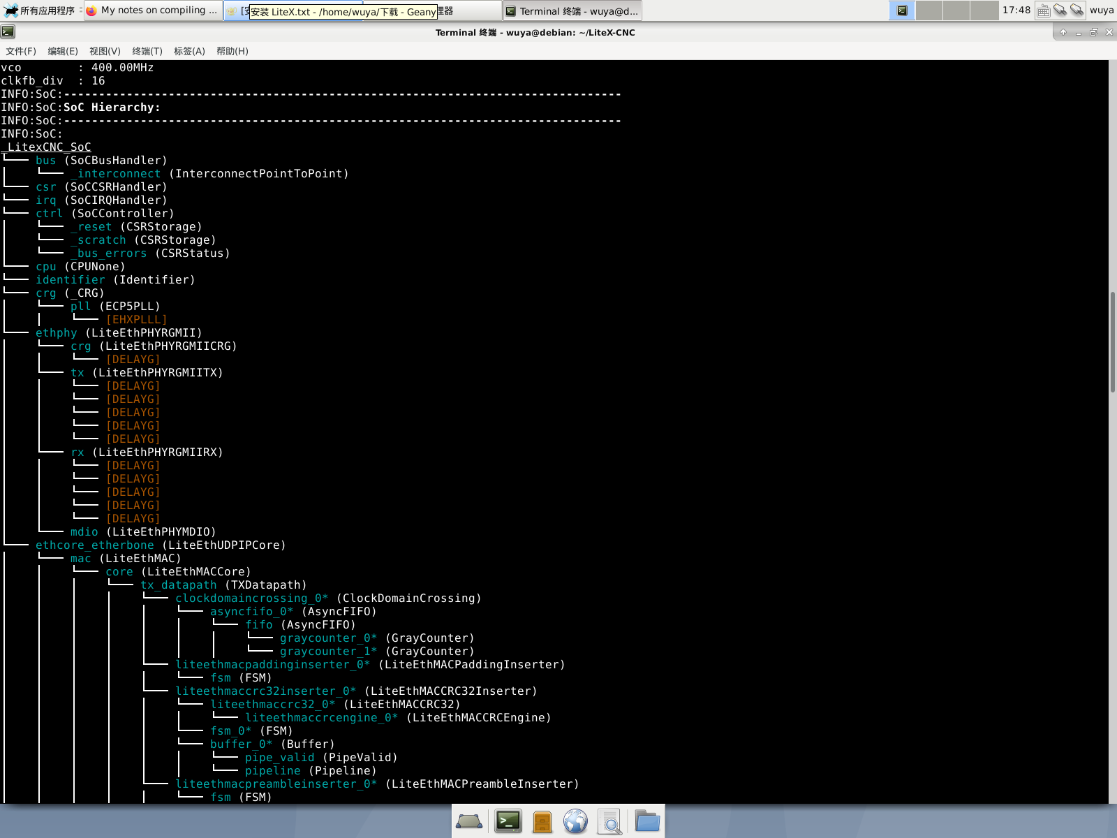

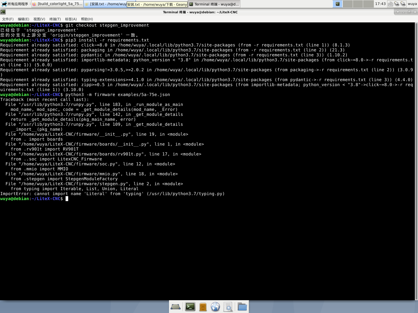

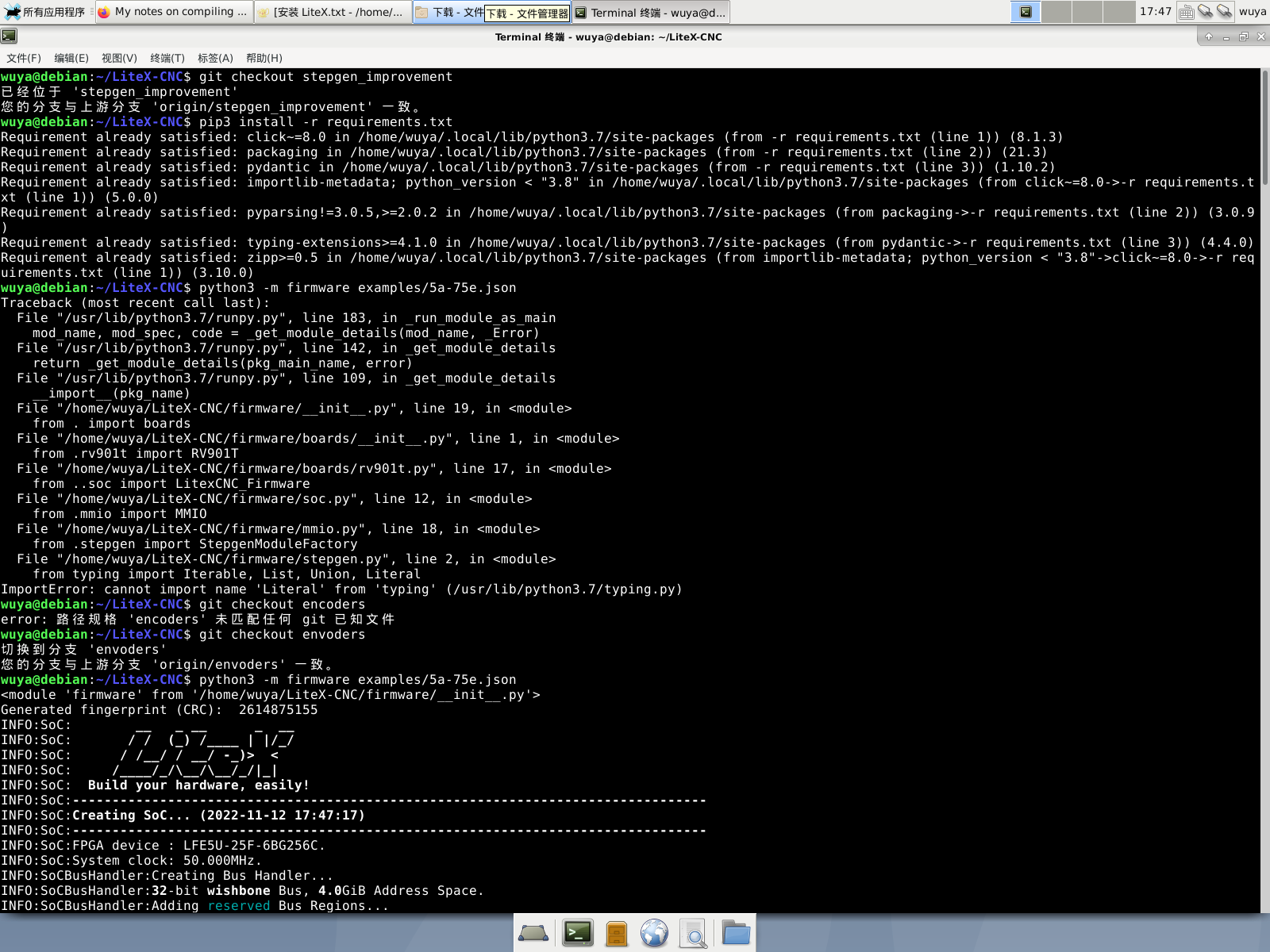

12 Nov 2022 10:06 #256494
by wuyatom
Why can't I use stepgen_improvement and main to compile into firmware, only the encoder can be used to compile successfully
The picture above shows the result, I don't know what's wrong, I've reverted countless times with virtual machine snapshots, still the same problem, I installed it according to DePrutser's instructions
Replied by wuyatom on topic ColorCNC Colorlight 5A-75E/5A-75B as FPGA controller board

12 Nov 2022 10:40 #256497
by sensille
Replied by sensille on topic ColorCNC Colorlight 5A-75E/5A-75B as FPGA controller board
5A-75E builds, but it fails timing:
Warning: Max frequency for clock '$glbnet$crg_clkout0': 42.97 MHz (FAIL at 50.00 MHz)
Warning: Max frequency for clock '$glbnet$eth_clocks_rx$TRELLIS_IO_IN': 107.31 MHz (FAIL at 125.00 MHz)

12 Nov 2022 10:59 - 12 Nov 2022 13:15 #256498
by TOLP2
Replied by TOLP2 on topic ColorCNC Colorlight 5A-75E/5A-75B as FPGA controller board
Please use Python 3.8 or later. That will solve the import error.
About timing: this happened with the last commit on stepgen_improvement. Have to revert that commit (or you can try to pull using the commit hash of the commit before). Try to solve that tonight.
