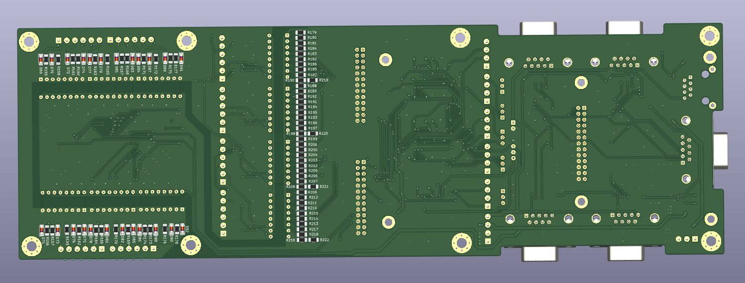

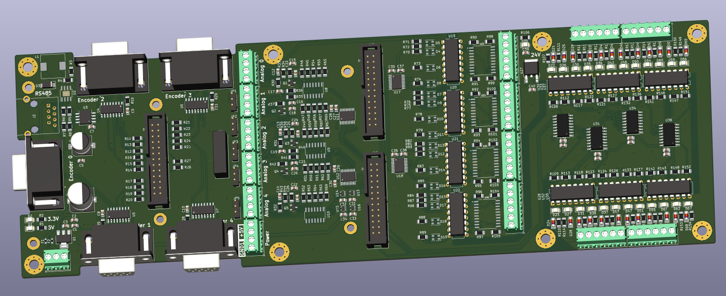

15 Nov 2022 07:42 #256755
by besriworld
Sorry for the late reply.
The project is not yet finished. I need to make more improvements on the board.
The board has 5 analog outputs (+/-10V) or 5 steps / direction (by changing the jumper) for this purpose I use AM26LV32.
There are 24 isolated inputs (Multiplexer input)
and 16 isolated outputs with LED indication.
One RS485 input/output
Replied by besriworld on topic ColorCNC Colorlight 5A-75E/5A-75B as FPGA controller board

Your board looks very promising. Though I was trying to source some of the components here (NL), which turn out to be either expensive or difficult to get. Another possibility would be that I'm not looking at the right places.
I hope with a board of this size the proto-typing phase will go effortless (i.e. not too many bugs in the design). How are you going to do that and keep the costs acceptable for a hobby project?

15 Nov 2022 19:41 - 15 Nov 2022 19:51 #256795
by besriworld
I bought the components before designing the board
I order from Farnell and some parts from AliExpress. I spent many hours finding the right components that would be available and would fit into the project.
I was also inspired by various projects .
I don't have any experience with making PCB boards . I hope there are no mistakes and it works the first time
The board is very big ... I don't know how it will work in real life
I don't like the 5v power backup how it's designed... need to fix it.
I am uploading the project from KiCad
