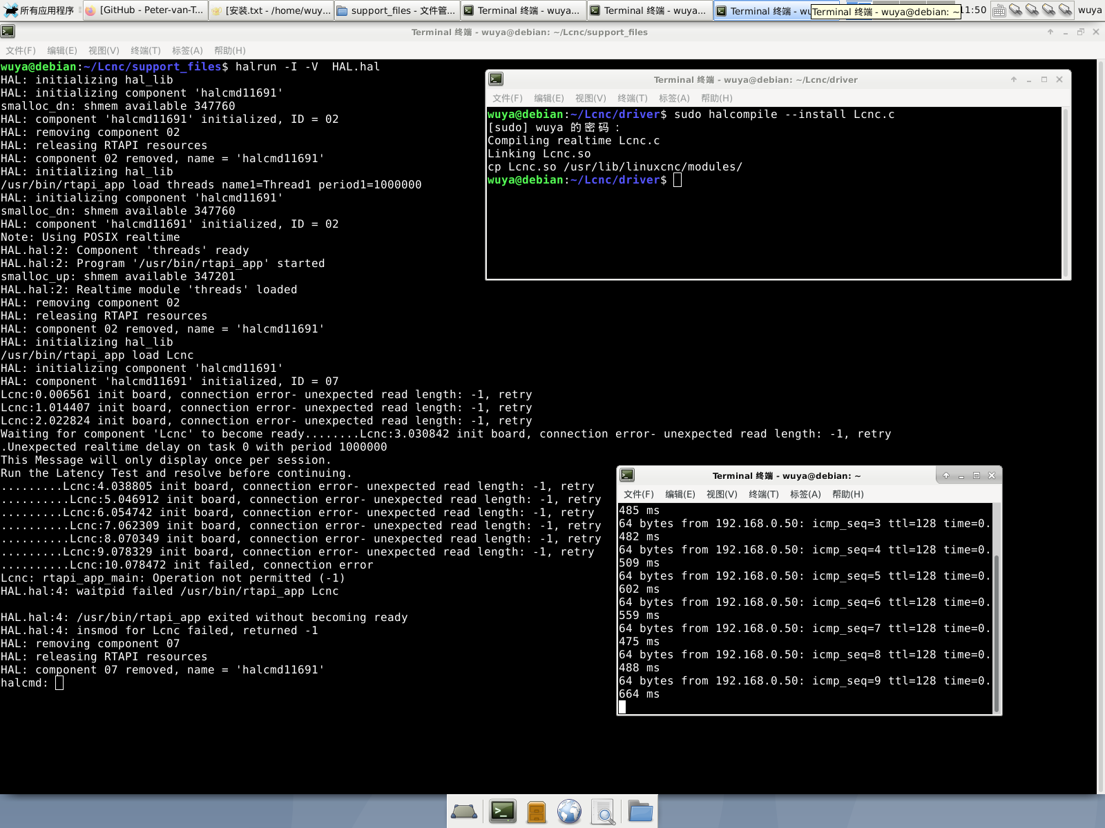

- wuyatom
- Posts: 42
23 Nov 2022 04:05 #257424
by wuyatom
Replied by wuyatom on topic ColorCNC Colorlight 5A-75E/5A-75B as FPGA controller board
- muvideo
- Posts: 62
- Thank you received: 30
23 Nov 2022 07:15 - 23 Nov 2022 07:27 #257433
by muvideo
Hi @wuyatom
my 75e is a 8.0, so I cannot test directly on a 7.1,
the ping response is a good starting point, at least the fpga firmware is doing something good.
I see you have opened an issue on github, I'll follow up on there
Edit: I forgot to mention in the documentation that in case the ip is changed the driver need to
be updated changing the line 13 in Lcnc.h and then built.
This will be addressed in a future version where the ip will become an argument to insmod.
Maybe this is the issue you are facing?
Thanks.
Replied by muvideo on topic ColorCNC Colorlight 5A-75E/5A-75B as FPGA controller board
I used the firmware generated by your firmware lnc_75e_v7_30029i9s9e8p.py. I changed the IP address to test, and I can PING the board, but I can’t connect to the board with the test HAL. I use 5A-75E-V7.1colorlight, which can help Let me see what's wrong, thank you

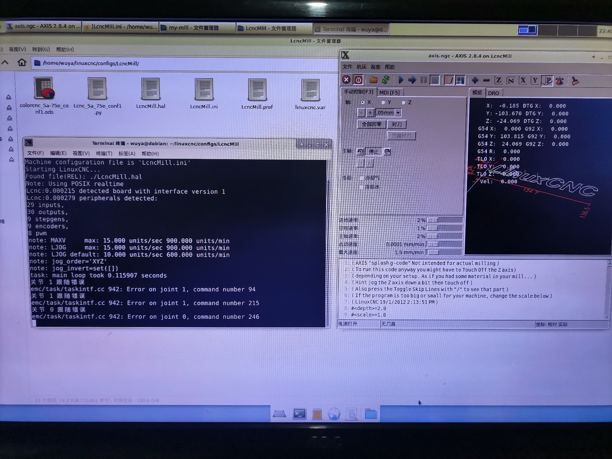

- wuyatom
- Posts: 42
23 Nov 2022 15:40 #257482
by wuyatom
- muvideo
- Posts: 62
23 Nov 2022 18:45 #257498
by muvideo
the first I would check is of the board is enabled.
In halshow check the status of Lcnc.00.enable Lcnc.00.enabled and Lcnc.00.enable-request
My setup for board enable Is here:
Lcnc/support_files/LcncMill/LcncMill.hal lines 13-24
This can depend on a lot of things,谢谢,我按照你教的改了lcnc.h的IP地址,现在可以和板子通信了,现在出现新问题,不知道是否需要连接硬件测试还是什么,linuxcnc按jog或者运行代码会导致关节跟随错误
