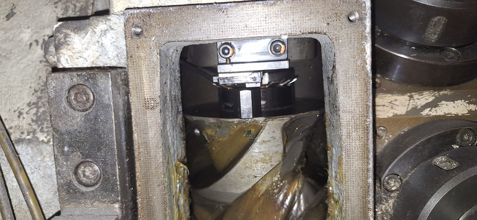

Aside from the schematics, I have a question. When you retrofit the machine, do you remember what locking mechanism was present to lock the spindle to each tool after the tool is changed? Any sort of clutch or clamp mechanism (hydraulic/electric/mechanic, pneumatic)?
- Posts: 22005
- Thank you received: 7488
14 Feb 2025 07:15 #321514
Replied by tommylight on topic Elumatec SBZ 130/01 retrofit
On the left side of the head is a small lid, remove it and check the worm gear inside.
Mine was badly worn so it would sometimes miss the exact position and fail to lock.
When locked manually, it never moves.
And yes it does use a clutch, it is very hard to access it and mine was worn badly so the tools would change even with it locked.
Despite all that, it is still in daily use, all day long, but the tool changer gets rarely used, drills and mills are the only tools they need.

Yeah, I opened the lid and found the wormgear. There seems to be a hexagon-shaped component on the top of the worm gear, it looks like it's made of MS but I'm not sure. I guess it must be a metallic target for the plastic component on top of it which looks like a sensor. What do you think?

Yes, if i recall correctly, that is one sensor for the toolchanger that tells the motor when to stop spinning, it also uses 4 more sensors in gray scale mode for counting the tools.
