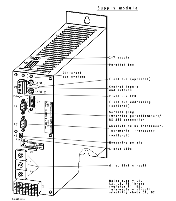

the FBUC is also ferrocontrol, its a fieldbus interface card with some I/O expansion cards connected to it,
couldnt find any sort of control in/encoder outputs on the drives, they just connect to the supply module that connects to the PC+fbuc, so looks like thats the only way to control/recieve feedback from them

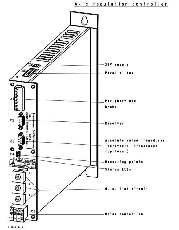

some more information on the connections between supply module and drives, looks like the parallel bus is how drives get control from the fieldbus.
regarding the canbus and profibus, the sections are mentioned in the document but listed as "in preparation" and empty, so I'm guessing maybe they initially planned to add but later on never really followed through?

BTW, that "override potentiometer" looks promising...
The following user(s) said Thank You: rainbowkoala49
