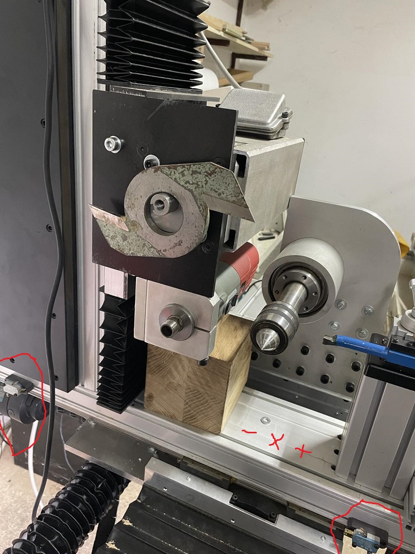

looking at the picture.. here i have two switches for both directions of the axis, is it a suggestion to remove one and use only one as a home switch, or the other possibly as a limit? this is a bit strange to me, i think i need both positive and negative limit range to use tool holders on both sides of the center of rotation axis?

Leave both as limit switches and use one of them as home, LinuxCNC wizards take care of hal for that easily.

Masiwood123, can I ask where did you source that round bellows for your ballscrew? Are you happy with it?

I haven't tried it yet, but I think they're great for woodworking, I'm not sure about metal, but I'll try it and let you know my impressions. here in Serbia, a guy makes to order according to measurements ..it's not too expensive for me, about 40 usd/1 meter in stretched condition. if you are relatively close (eu) and interested, maybe I can send you a private , but the postage is definitely expensive, maybe also 40-50 usd to EU zone by classic post.

I got some spiral spring covers. This UK supplier also does bellows: www.dqr.co.uk/ballscrew_covers.htmlMasiwood123, can I ask where did you source that round bellows for your ballscrew? Are you happy with it?
Though I think that they are simply importers of a German source.
The springs (and bellows) exist on Alibaba too.
www.alibaba.com/product-detail/Telescopi...ver_62266378112.html

Thanks for looking up the shipping! I'll have to hold off buying the bellows a bit though, I need to figure out how to mount the ballscrew first and do some measurements so I know what lengths/sizes I'll need. I'm also unsure of how easy it would be to get a private package through the rather zealous Swedish customs... But even if I end up getting the bellows from somewhere else, it would be interesting to hear your impressions later when you've had time to use it a bit. Things like: does it glide nicely on the screw or does it get caught up on the threads? How is it mounted at the ends?
(If you visit up here in the north, try to make it (late) April to August; the summers are pretty nice! Winter is cold and DARK, like pitch black at 15 o'clock in the afternoon! My favourite month is May I think.)
@andypugh: Do you know what that German source is? It would be great to have an EU seller (preferably with a web page so you could look up spec sheets/sizes/prices). I've only imported one thing from the UK since brexit and I think I paid €60 for shipping! (For a small and not very heavy package.) So not too keen on that.
