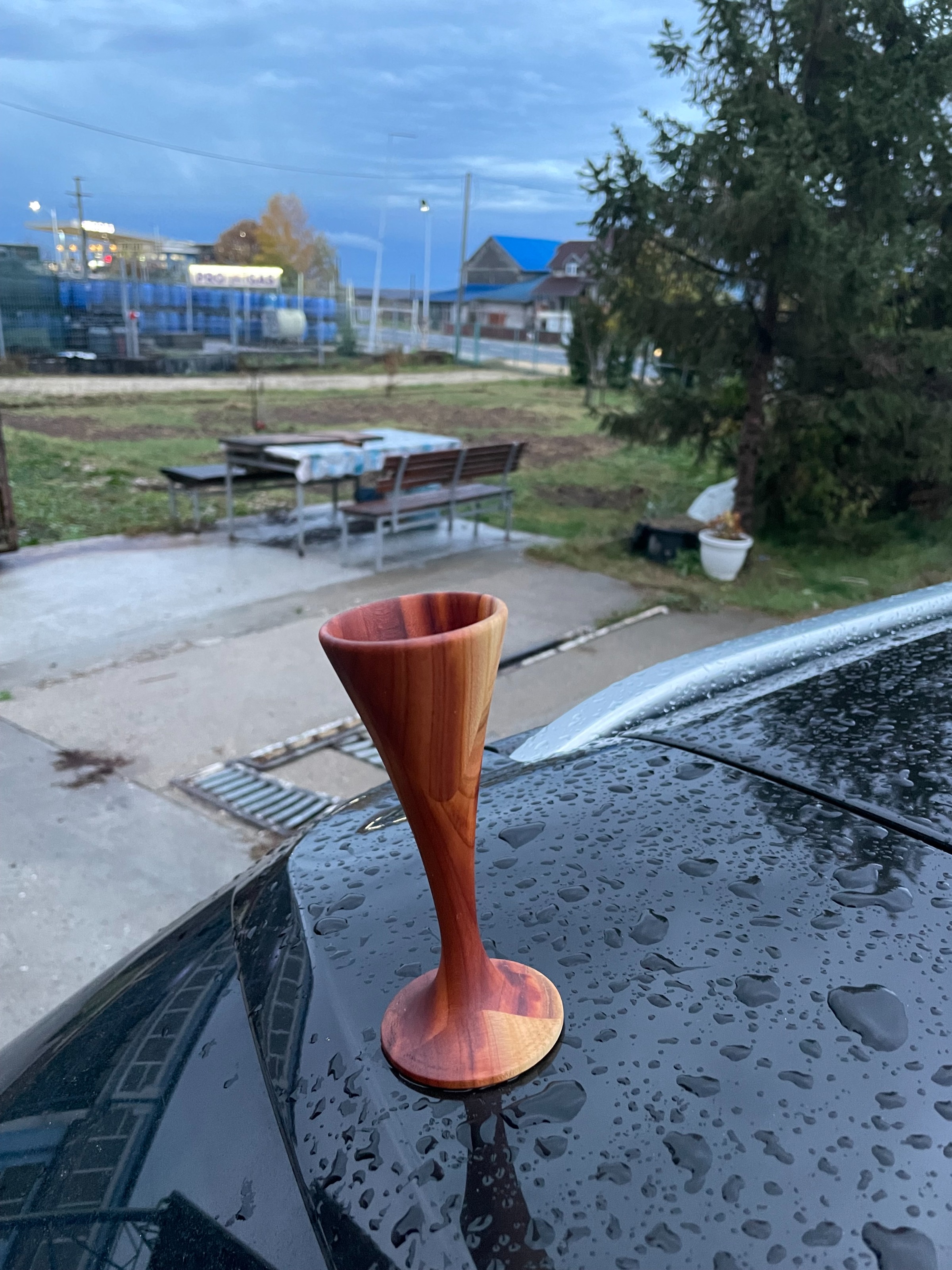

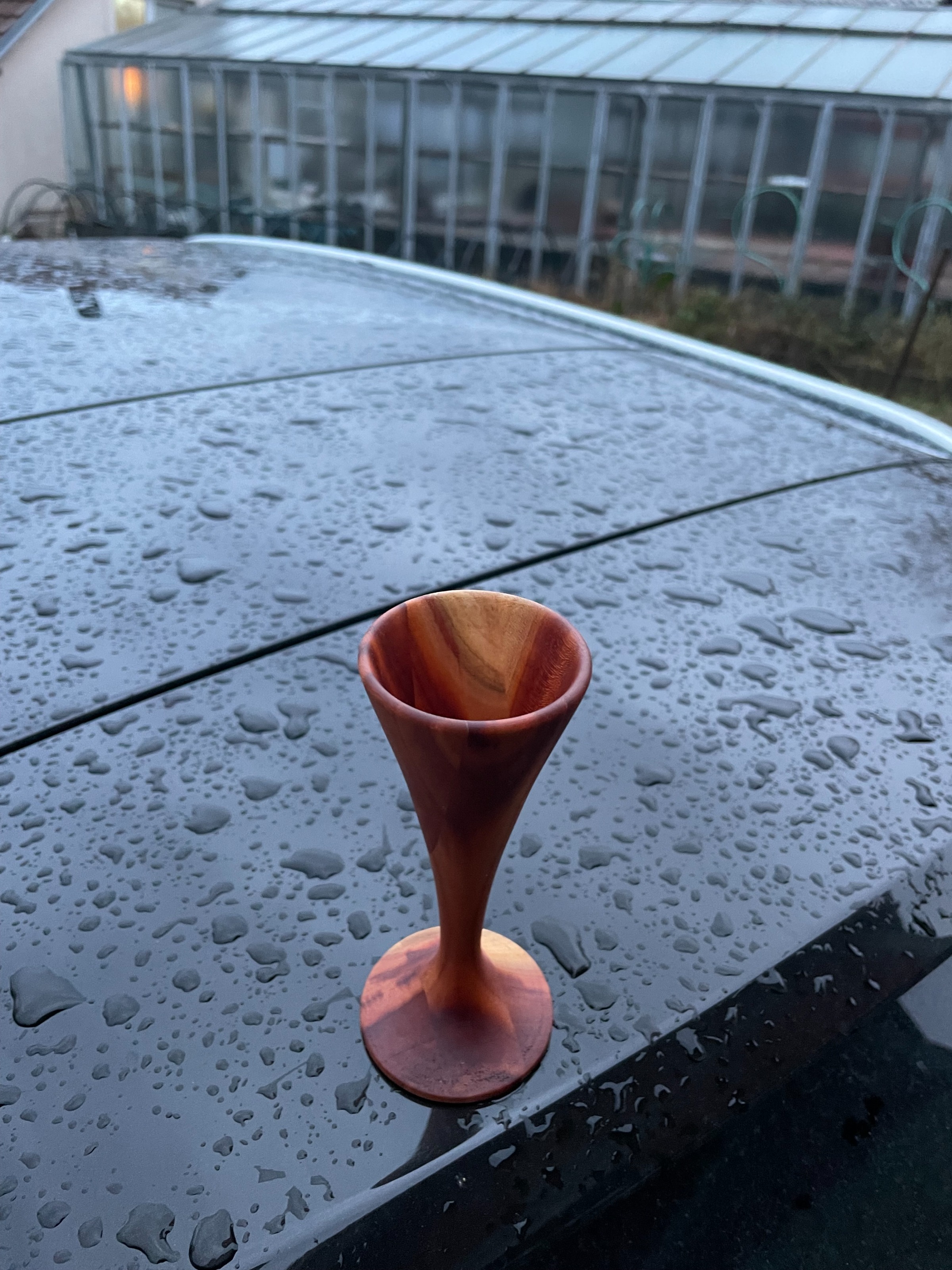

I am currently in the phase of making two configurations, one for lathe mode where z will be the long axis and x will be transverse, and I need another where the names of the axes will change places, because on the transverse support I have motors that will to process wood, and the cam program I use for that always considers the Z axis as a mill and I can't modify the postprocessor.
- Masiwood123
- Posts: 423
- Thank you received: 93
17 Nov 2022 19:58 - 17 Nov 2022 19:58 #256955
by Masiwood123
Replied by Masiwood123 on topic epoxy granite cnc lathe

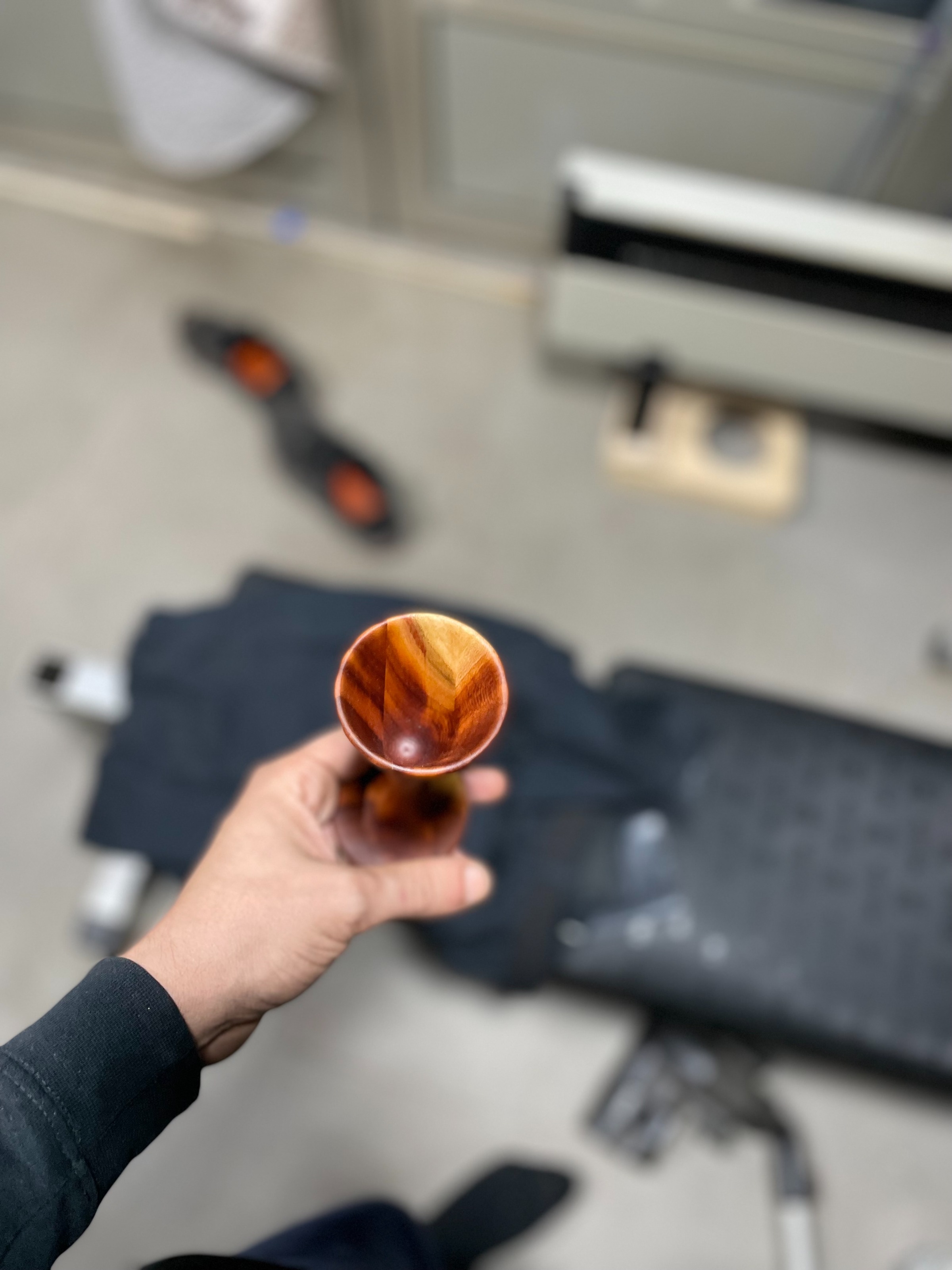

today I gave birth to a bear..since I combined two operations in gcode, the first one that makes a hole like g17 and the second one that makes an outer contour (put in gcode G7)..however linux sees both operations as g7 so it doesn't make a round hole for me but an ellipse , divide x by 2. Is there a way to make the first operation (see the hole normally, and in the following line to read the lathe operation, with G7) not worth doing separate operations, but would like to place everything in one file? thanks
youtube.com/shorts/w0sIjqA-jdU
Last edit: 17 Nov 2022 19:58 by Masiwood123.
- Posts: 19902
18 Nov 2022 00:07 #256993
Replied by andypugh on topic epoxy granite cnc lathe
Just put a G8 in the code before the hole and a G7 after?
It's a very nice ellipse though, Why not see it as a Bob Ross happy accident?
- Masiwood123
- Posts: 423
18 Nov 2022 14:56 #257040
by Masiwood123
The G8 does the job, it's a round hole now, thank you very much. Yes, I like the ellipse, maybe I'll make it for my friends, but the client is asking for a round one, to fit more alcohol:)).. but I'll have to do it in two separate operations, it's too thin and the processing is bad.. today I successfully made a small adapter for the tailstock that will hold when I do the outer contour..to be continued..
