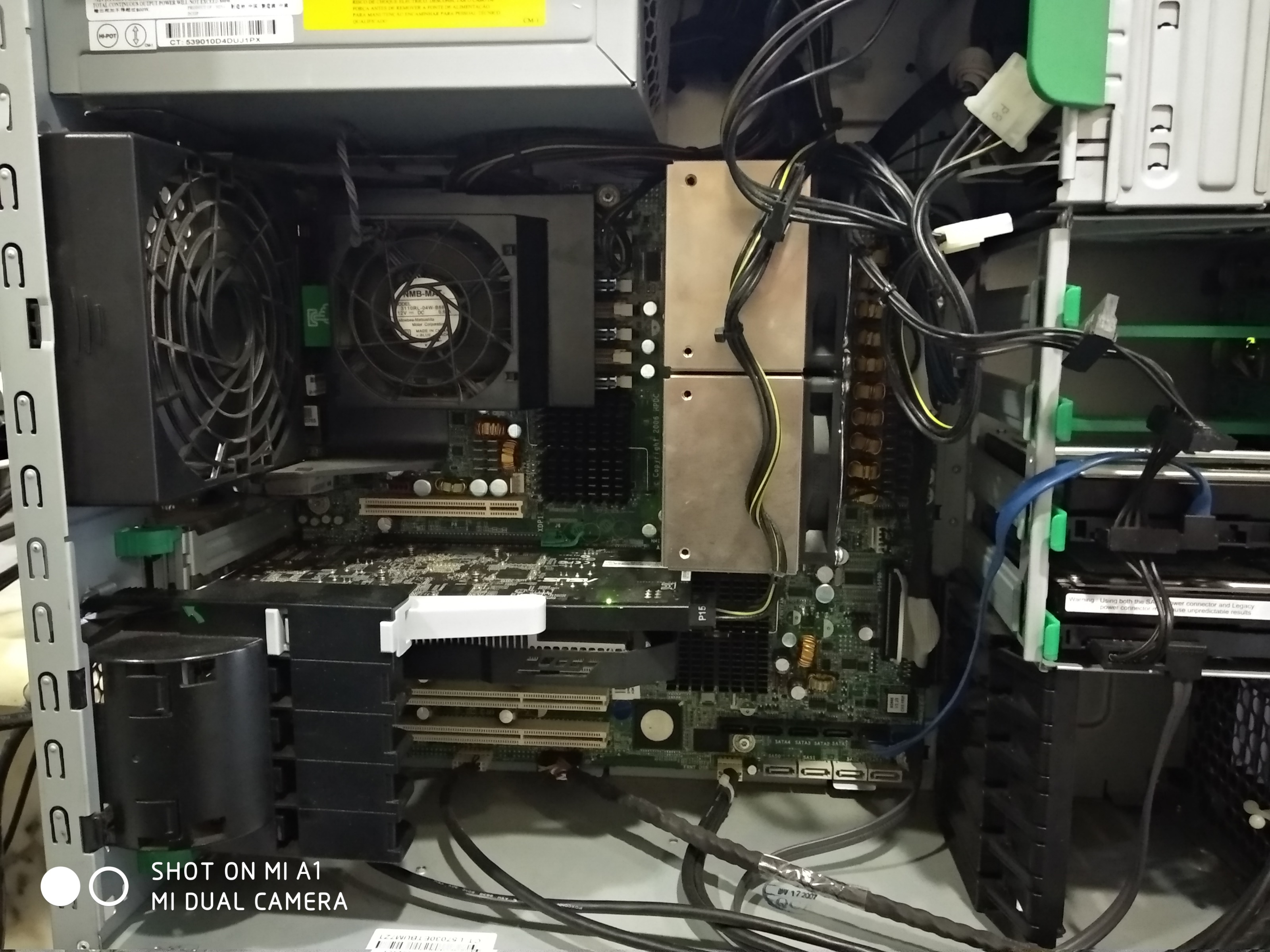

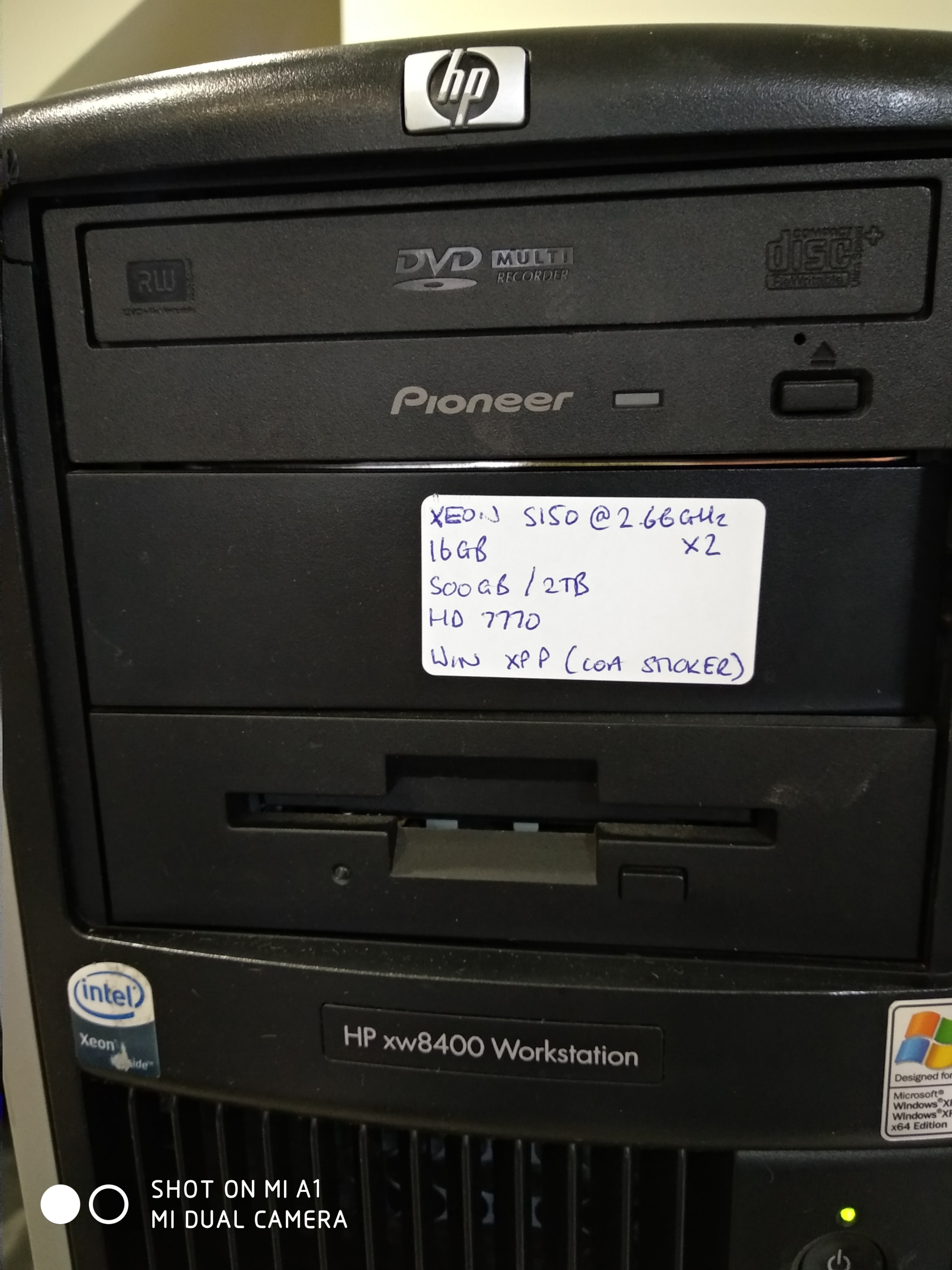

12 Apr 2019 04:18 - 12 Apr 2019 04:38 #130725
by Yannis
Replied by Yannis on topic CMS MAXIMA 4 axis Machine retrofit
Hi
After long time the pc has arrived. I think that the pc have more then enough capabilities for the job
Also i order the 7i76E mesa from Eu surplus but there is a delay from the manufacture.
i wool like your suggestion for the linux distro. I use debian on the Inermac machine and i m very satisfied
from the behavior . I try to use linux mint in a virtual machine with no success
Is there other suggestions?
Last edit: 12 Apr 2019 04:38 by Yannis.
- Posts: 22043
- Thank you received: 7506
12 Apr 2019 20:42 #130753
Replied by tommylight on topic CMS MAXIMA 4 axis Machine retrofit
That is a nice workstation and i know for sure that Liinux Mint 17,2 and 18.1 work on it perfectly.
The testing version of Linuxcnc based on Debian Stretch should work properly, it is a ready made iso.
The following user(s) said Thank You: Yannis
