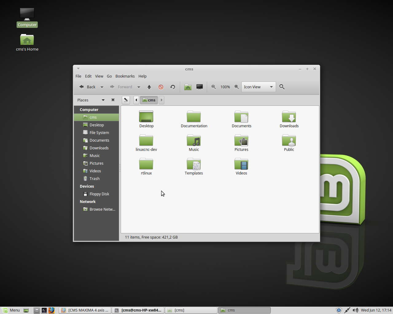

Update
i try to install linuxcnc with the MINT 18.3
I follow this gnipsel.com/linuxcnc/uspace/linuxmint18-rt.html
cms@cms-HP-xw8400-Workstation ~ $ uname -r
4.19.1-rt3
then i follow this tutorial
www.forum.linuxcnc.org/9-installing-linu...h-rip-or-build-a-deb
as a result i see this in cms file but there is nothing in the applications like linuxcnc
Any ideas?
4.19.1-rt3
Any ideas?

It's probably easier not to use Mint at this point, just use the LiveCD that PCW linked to to create a known-good setup that ought to work.

You will not have any icons/paths setup if you just built a RIP version of LinuxCNC or built a deb.
If you built a deb, you need to install it, if you did a RIP build you need to source the path setting script: source your_installation_directory/scripts/rip-environment, and the run LinuxCNC from the command line.
