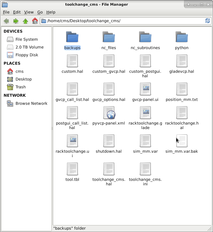

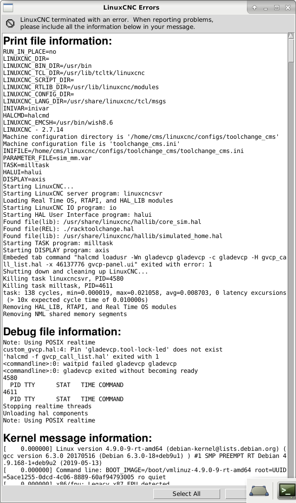

I try with copy paste to make a configuration using the rack tool change
here is the debug message

Replied by andypugh on topic CMS MAXIMA 4 axis Machine retrofit
It seems that the config (as-is) relies on a gladeVCP panel.
You probably want to get rid of that as it only exists so that you can provide dummy toolchanger inputs to the tool change process.

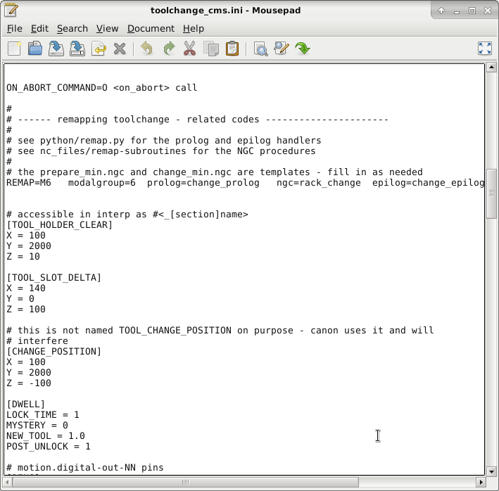

Still trying to understand how thinks works
i have a screen shot of my ini file (copy from the rack tool change ) and the toolchange procedure is on it
then i have the ini file from Rover 346( bevins ) and there is nothing like that on it
witch of the ini files sud i follow?
- Thank you received: 4654
19 Jun 2019 12:00 #137282
When I said "get rid of the gladeVCP panel" I meant rather more than just deleting the file.
You (probably) want to not load it in the first place, and then make HAL connections to real physical inputs from the hardware to replace those that are connected to the GladeVCP in the sim config. (though the glade appears to just be two indicators to show when spindle-lock and air-flush are active)
Note that the sample config expects some INI entries:github.com/LinuxCNC/linuxcnc/blob/master...tool_getput_move.ngc
I think that on my own machine I would probably not bother getting quite so much info from the INI, hard-coding which G-code digital out (motion.digital-out-NN, toggled by M64 / M65 in the G-code subroutine) is used for each function.
Do you also need spindle orient prior to tool change?

19 Jun 2019 13:32 #137288
by bevins
Replied by bevins on topic CMS MAXIMA 4 axis Machine retrofit
You cannot use my config because I am doing the remap in python. You are running into issues because you are trying to use the sim configs and unless you know how to get out from under the way they did the simulator, you will have issues.
Look at HueyHQ config here.
Look at the ini config, important or it wont work. Also you will need to install standard glue.
Once the remap structure is good, then you can start with your toolchange code. You would probably be better off using NGC with standard glue.
just my thoughts.
just my thoughts.
