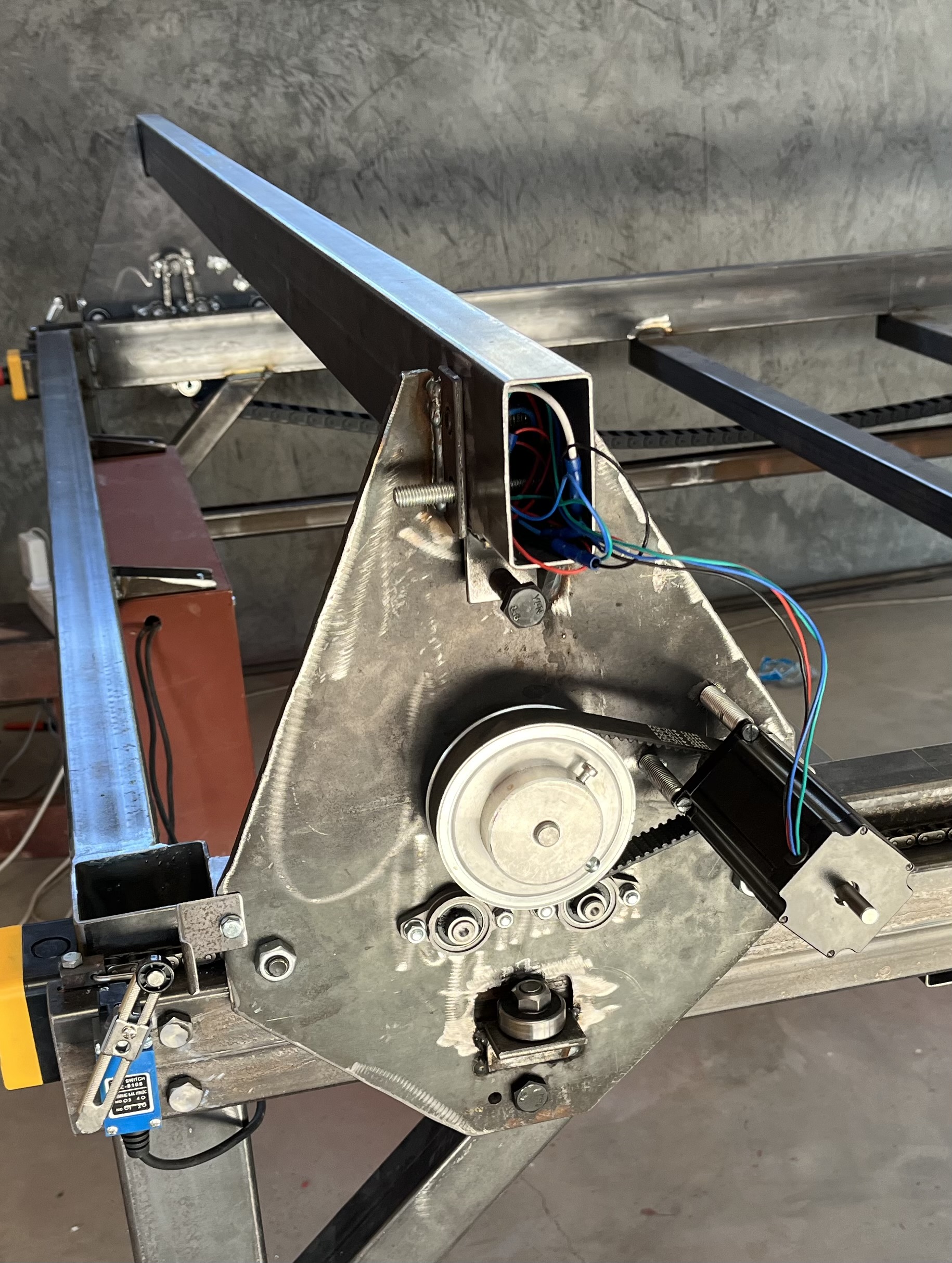

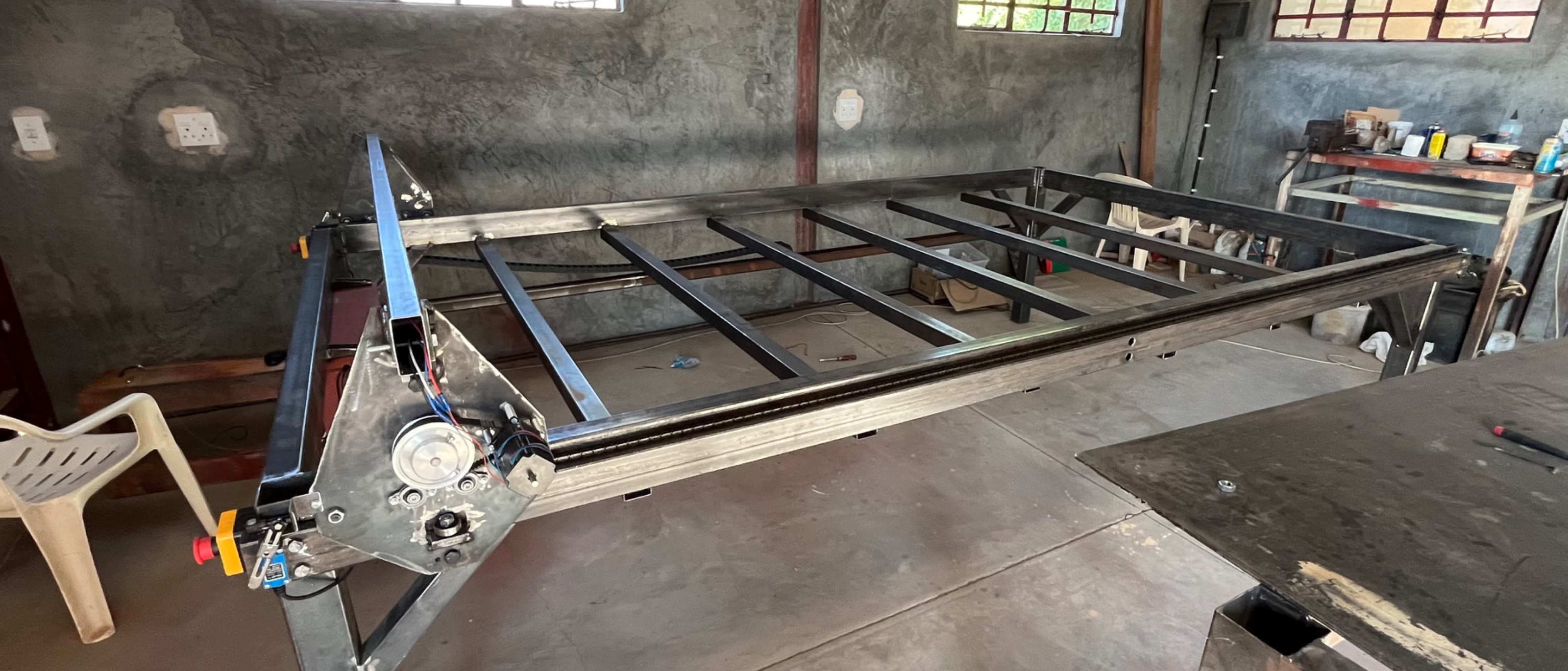

01 Sep 2024 15:10 #309155
by Creative25
Replied by Creative25 on topic Building a chain driven Plasma table.
Hi to all so I am back after a ling break.
And I finally could start building my plasma table.
So far I got the tandem axis running which I chose to be the X axis.
Homing and everything Is running fine.
I also was able to Calibrate the Axis movement to within 2mm per 2 meters.
Dont have anything accurate to measure the movement except a tabe measure.
What is still have to do is to find out how much acceleration the Stepper motors can handle.
When i use the Motor tuning option in pnconfig. Only one of the motors is moving.
Is there a way to make both motors to move at the same time?
So far i use acceleration of 1000 and maximum Speed of 15000mm / min.
Seems to be running well without loosing steps.
What acceleration should I try to reach for good plasma cutting?
- Creative25
- Posts: 150
- Thank you received: 11
02 Sep 2024 07:15 #309196
by Creative25
Attached are some photos.
